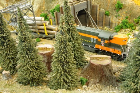

So how about some shots of them at work?
jwb Wrote:So how about some shots of them at work?
Yes Sir
[Image: IMG_1392.jpg?t=1334780271]

The early morning job is under way
[Image: IMG_1395.jpg?t=1334817735]
