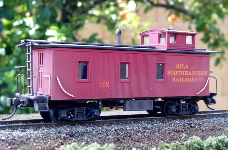

Ralph's caboose thread made me realize that I do not yet have a caboose lettered for my standard gauge connecting railroad, the Gila and Southeastern. Here is an old MDC caboose kit that I redecorated for the task, using home printed decals again.
#64
Nice weathering. Is there a # 101 somewhere (even a fictional car)?

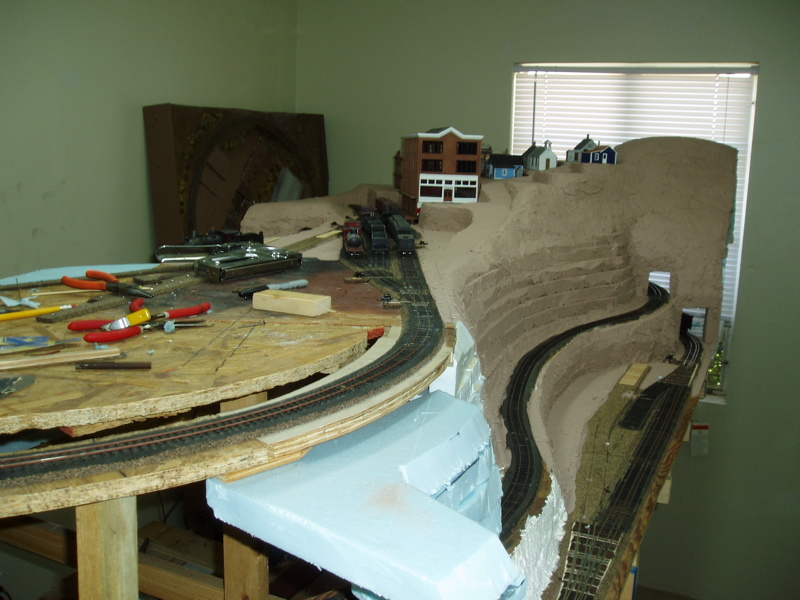

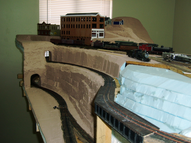

Last week was one of those painfully depressing weeks that come with unemployment. After sending out stacks of resumes and receiving little or no response, eventually a worthless feeling sets in. After a week of feeling worthless and somewhat panicked, I reorganized myself into "plan B" mode, and now I feel a little better. I re-committed myself to do whatever it takes, be a little unconventional, and put a stronger emphasis to branch into other industries. For now, I will put the idea of getting another career type job in my science field on the back burner, and concentrate on getting certifications or training that I can use in related industries. I am a smart guy, and I know I can be extremely useful to somebody. In the meantime, I will try to use my knowledge and skills to pick up odd jobs for friends, neighbors, or family.
I had been spending my modeling time on rolling stock rather than my layout in the event I had to relocate. I decided that relocating is plan C or D, and until that is inevitable I may as well have a little fun running trains. I cleaned up my layout room, cleaned off the layout and tracks, and took a photo for this week's photo fun thread - only to recognize all that blue foam and white sculptamold was an eyesore. I had a gallon of "oops" brown paint in my workshop, and I figured it wouldn't cost anything or take much time to at least paint my landscape a tan color. I still don't have the rocks carved or groundcover glued on, but at least it is better than blue and white. Here are the results:
#66
Looks good. Throw some quick grass and bushes on there and it'd make a tremendous difference.
#67
nachoman Wrote:... but at least it is better than blue and white. Here are the results:
A little color makes a big difference. I do usually put some deluded low cost gray paint on unfinished parts of the layout until they get their final layout.
My best wishes for a successful plan B.

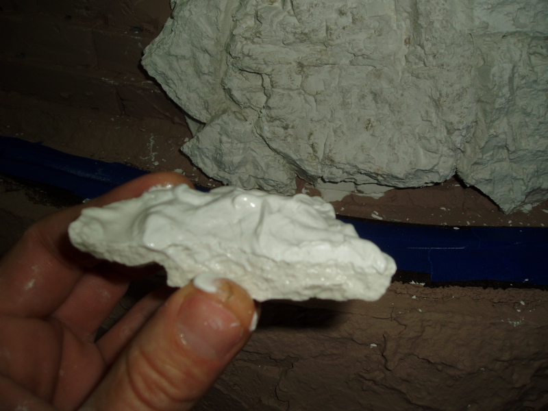

#73
I only have one rubber rock mold from woodland scenics, and don't have the money to buy more. No worries there, though. I also considered the aluminum foil method of making rocks. I have had success with it before, but some extra work needs to be done to make it truly look convincing and not like crinkled aluminum foil. Carving the rocks out of foam is quite tedious, and I am just not patient enough for that these days.
Rubber rock molds are a great way to get some good-looking hard rocks. But they also have drawbacks:
1) Large rock faces will require blending various castings together
2) One needs to avoid repetitive patterns due to using the same mold more than once
Since the various molds often have distinctively different textures, using an assortment of molds sometimes leads to a rock outcrop of unrealistic contrasting textures. But using the same mold over and over leads to repetitive patterns.
There are two was to apply rock castings - wet and dry. Wet castings are applied with wet plaster directly to the scenery shell. Dry castings are allowed to dry in the mold and then glued to the scenery. I am using a combination of both methods. First, I applied a few wet castings to my rock face spaced by about 10 inches. I made sure to orient the mold in different directions so that the pattern is less recognizable. Then, i made a bunch of dry castings using the same mold, and broke the castings into pieces.
I then wet the casting fragments and "back buttered" the fragments with plaster and glued them to the scenery. If you don't wet the castings first, they will dry the plaster glue and it won't set up hard - the rock castings won't stick well. I used the various pieces and arranged them however they would fit. This is similar to applying a cultured stone veneer to a building, or laying a flagstone path. I tried fitting the casting fragments at tightly together as I could with minimal gaps. Having the few "wet casted" rocks already applied to the scenery helped give something to work from.
#74
After the casting fragments were in place, I used plaster and artists palette knife to fill in the gaps. I made sure to leave the plaster a little rough looking to help blend the casting fragments together a little better. I will need to go back and do some cleanup work because of air bubbles in the castings and do a little better blending, but so far I am happy with my results. Hopefully, because I am using random fragments of the same mold, I will avoid both the repetitiveness and the widely contrasting texture problem. I have a lot more to do, though!
#75
That looks really good. I never thought to wet the backs of my castings before placing them. I always just slathered on wall joint compound and stuck it in place.
