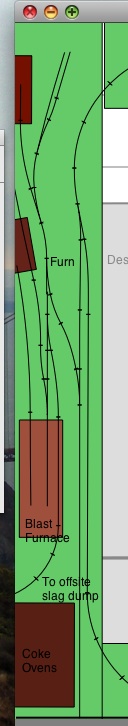

So in my never ending shuffle of railroad plans, I thought of possibly adding in a steel mill to my layout.
Quickie backstory: I bought a Blast Furnace and Coke Oven kit with the idea to somehow add them into the GERN industry area, give it a more industrial look. Then I started thinking why not just add a steel mill to the layout and use these kits for their intended purpose?
So here I am now, goggling around looking for track plans for steel mills, pictures, etc... But unlike most of these sites I find online, they have one thing I don't really have....Vasts amounts space. It seems most people dedicate a LOT of space to their mills. The area I would be putting the mill is about 6.5' long and about 12" deep. So it would have to be small, compact mill in a shotgun (straight line) configuration, with track entering into the area at the right of this area.
So I'm trying to figure out what would the best layout be for the plant? I'm thinking the Mill would contain three buildings: The Coke Oven, Blast Furnace, and a rolling mill. What's you're typical order of operation here? Maybe I don't need all 3 buildings?
I'm still reading up on Mills and what not, but thought I'd ask here to see what some folks who've possibly already modeled a mill would suggest to guide a "mill newbie" along.
Thanks yall.
A rough draft:

Yeah, I started to think the space needed to model the mill would be more than I'd ever have, but I think I can get away with selectively compressing the industry and modeling just like the inner workings basically. All of the in/out loads tracks, docks, etc.. would simply be located "off layout", and operations would be minimal.
It may not exactly be prototypical, but simple operations could be:
- moving loaded/unloaded coal cars to the coke ovens from the mainline
- Internal switching of cars to/from blast furnace to mill
- moving loaded/unload coil cars from the mill to mainline
I know, it's a crazy idea! 35
I just wonder if these buildings will just "overpower" the layout because of their size. The top 2" of the blast furnace will be hidden by fascia because it's so tall! Guess there's only one way to find out! Smile

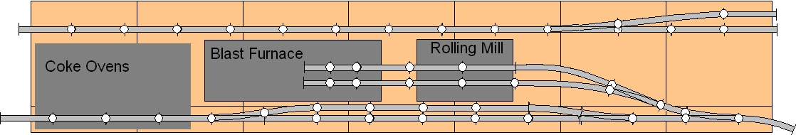

So forget what I said before, I'm going to go ahead and give it a shot. Goldth
Last night I took some poster board and cut of pieces based on the sizes in the Walther's catalog of the Blast Furnace, Coke Oven, Electric Furnace, and Rolling Mill and arranged them up on the layout to see how they will all fit.
I could make them all fit in the space, but they'd be almost be right next to each other in line. I think it would just like kinda funny. It also wouldn't leave a whole lotta room for trackage.
So I have a few options....
1) I could simply use the Rolling Mill kit and "selectively compress" into being both the Furnace and Rolling Mill. There's 3 internal tracks, so 2 would be tracks to the blast furnace, and then the 3rd would be the coil car load/unload car. This reduces the industry's footprint.
2) Simply leave the mill/furnace off the layout, and operate the mill has a remote merchant furnace, delivering molten pig iron to a remote plant for further processing. This would greatly reduce industry footprint, and I think the fewer GIGANTIC mill buildings might look better on the layout.
3) Expand the footprint and get rid of the industry (which would now be GERN since I swapped GERN and the Refinery so the refinery would be a little larger) that was going to be around the corner near the end of the layout. This one may depend on much I like the Steel industry because this would make the Steel Mill rather large, almost like the "showpiece" of the layout.
4) The last option would be to swap the location of the town with the proposed mill area, with the town wrapping around the corner towards the end of the layout. This would allow me to to have the mill on the inside of the track against the backdrop, giving me the ability to make some buildings like the furnace and/or mill be half deep backdrop buildings. I would have take some measurements here to see if there's any gain/loss of real estate though. I would also have to add a turnout on the mainline someplace to get into the mill.
I'm leaning toward option 1 or 2 right now.

Well...Are those the foot prints of the mill complex?
Again like I mention you can run a hot slab train if need be.
Larry
Engineman
Summerset Ry
Brakie Wrote:Well...Are those the foot prints of the mill complex?
Yeah. The length/width is represented by each poster board cut out.

Shaun, welcome to Steel Modeling, you NEVER have enough room for the buildings you want to use and model lol

Shaun, and anyone else contemplating modelling a steel plant, you have to realise that almost all integrated steel plants are enormous, and even most club layouts don't have the room to model more than a very compressed representation of the real thing. The Walthers blast furnace is a model of a very small furnace, as are the coke ovens, rolling mills, whatever. If you want to model the steel industry, select the part that interests you most, and concentrate your efforts there. Most mills are pretty plain looking buildings, and, for the most part, are good candidates for background "flats" or even as pictures on a backdrop - the real ones can be up to or more than a half mile long. The operations inside are linear in nature, so you could easily generate rail traffic by modelling one end of a mill, either to accept, ingots, slabs, billets, etc., or model the shipping end, where the slabs, coils, or plates leave the building. (Incidently, slabs and plates are not usually the same thing - a slab is either rolled from an ingot, or, more commonly nowadays, cast in a continuous caster. Plates are rolled from slabs and are usually of a thickness close to what the finished thickness will be. In general, the metallurgy for plates is quite different from that for coils and other strip products, too.)
Most would agree that the blast furnace is, visually, the most interesting. Unless you're modelling a very early 20th century steel works, most of the other processing operations are done inside large buildings - interesting in many cases, but usually visible only through a doorway.
The coke ovens, while not in a building, are most interesting when in operation, but it's pretty difficult to model an operating charging car, a door remover, or a pusher. I'd relegate the coke ovens to the background, too.
The flow chart that Josh posted, while more suited to mid-20th century practices, will give you a good idea of the steps involved.
I'm not trying to discourage would-be steel industry modellers, but your efforts will look more believeable if you don't try to model the entire operation.

Thanks for info Wayne. I agree 100% not trying to model the whole thing. I would never have the space to do so.
Like you said, many of the larger buildings are rather plain looking, and for such large real estate (and cost!) needed for them thought of simply leaving them out. If I swap the area I'm planning with now with the town area, I could probably use a photo backdrop of a steel mill to represent the Electric Furnace, etc.. and to give the impression of a larger industry. Operations would mainly be dropping off raw material to the coke ovens, and maybe a "finish product" track for coil cars (since you can't tell if they're empty or full!). I'll have to measure the areas tonight and see if that could work.
Currently I have the Coke Oven kit and Blast Furnace kit in my possession. So modeling the receiving end would be the easiest way to go (like Option #2). I liked the look of these two buildings and thought they would be an interesting addition to the layout since most of my other buildings that are just, well, buildings.
Looks like swapping mill and town won't really work. Less real estate there because of how the track is running through, and I don't wanna really tear up all the track.
So, I can still do a photo backdrop in the currently planned area to act represent the Furnace/Mill area, and simply model the inbound/outbound tracks for finished material coil cars, along with tracks to the coke oven for raw material. I think this might do well.

Just tinkering a little. If I move the mainline to run in the front of the shelf to be able to use backdrop buildings, I'd get about 8'x12" of space. It seems to fit ok on the computer it this setup I did. Just a starting point for an idea.
The electric furnace (lower backdrop building) and rolling mill would be shallow backup buildings. I could probably simply use like the rolling mill kit, cut in half and use each half to represent each building now that I think of it.
Added in some storage tracks at the top for coil cars and flat load slab cars. Most of the industry will be for show, like having the slag track simply run off into the backdrop, or to behind the blast furnace. And one BF track running by itself to the electric furnace.
Honestly, I probably won't ever "operate" the mill, so a design mostly for show that "looks" like it could be operated is fine.
