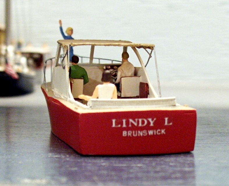

I will try the same technique I used on the "Lindy L "

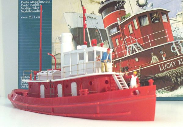

Yes sumpter250 you made me remembering my holidays last summer.
[Image: dsc0519006dq2.jpg]
The canvas on Diana is exactly the same as commonly used on European trucks.
It is PVC plastic and has a smooth surface and is in this case stiff tension. So it is nearly even and flat.
I suggest a thin styrene sheet can do it to represent this stiff wrinkleless PVC canvas.
An example:
<!-- m --><a class="postlink" href="http://en.wikipedia.org/wiki/File:Actros182201.jpg">http://en.wikipedia.org/wiki/File:Actros182201.jpg</a><!-- m -->
Note the trailer sides are PVC canvas.

Thanks for the "heads-up" on the PVC. When the time comes, I will have to look into the possibility of using a "lawn waste" bag as the material for the canvas. I might be able to actually lash it in place..... Wink Smile

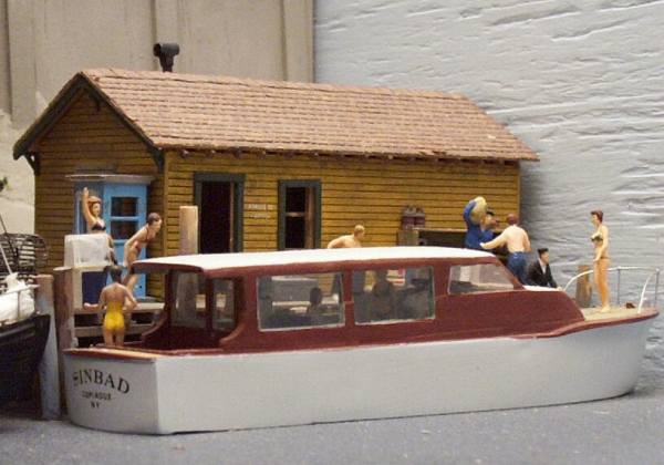

Building "in-place", is what I intended from the beginning. The vertical posts from the "shelter deck" to the "bridge deck", had their locating holes drilled in both decks, before the "Shelter deck" superstructure was built, to insure "near perfect" alignment. My one concern, is an assembly jig that is simple to install, easy to relocate,and, to remove after the soldering, and solid enough to insure railing alignment - - - I'm working on the concept, and will build the jigs once I have resolved all the "issues" :o Wink - - which is why all the other stuff is ongoing. Big Grin Big Grin . The railings on the "Tow Boat" are brass rod, soldered in place to the brass stanchions. I used metal "pinch clamps" as heat sinks, and liquid flux helped the almost instantaneous solder joints, so little heat got to the plastic.
Same for the bow railing on "Sinbad"
