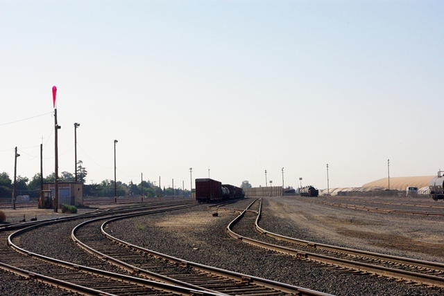

Looking at the yard tracks in the foreground reminds me of a photo I took of the M&ET transfer yard with the BNSF in Empire:
One detail I've seen now and then at various yards is a wind sock. There's one to the left here. Don't know if there's one available near HO scale for aircraft modelers.
