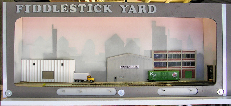

You wanted a different style of painted background - if this is of interest, I'll explain the method - the sky has a deliberate pink tinge as I wanted a dawn/sunset on a foggy day.

That's an interesting layout, Jack -- I'd like to hear more about the backdrop technique, but if it's still extant, I'd also like to see an operation sequence.
#38
Shortliner - That's a nice little layout, and that backdrop is unique. I may consider that.
