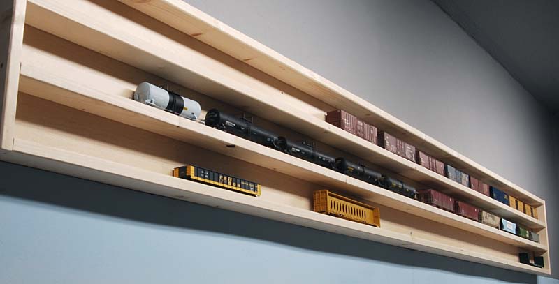

Before I go on working on the layout itself, I built a shelf to store my cars. It goes above the backdrop of my layout and allows for easy access to the cars when operating the layout. I had stored my cars in a drawer so far, but it was getting a little cramped and cars could easily be damaged when being put in or taken out. The lowest board on the new shelf is still a bit empty, but it will get filled up with three centerbeams and a bulkhead flat in one or two days – one of the hobbyshops around here was offering them at bargain prices … simply could not resist :mrgreen: .

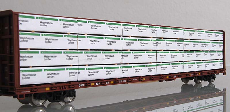

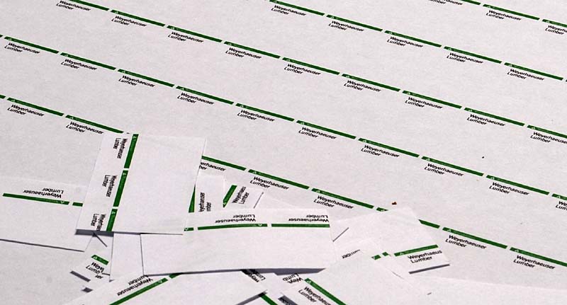

No progress on the layout itself, but I got my new flatcars yesterday and I need lumber loads for my centerbeams. So that is what I did today.
[Image: bt25.JPG]
After doing the graphics I printed them out and cut out 43.5 mm wrappers for the lumber bundles in the middle and 60 mm long wrappers for the ends.

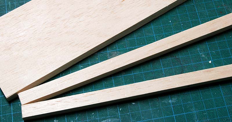

I used 8 mm thick balsa wood for the bundles and cut it to 13 x 254 mm pieces.
[Image: bt16.JPG]

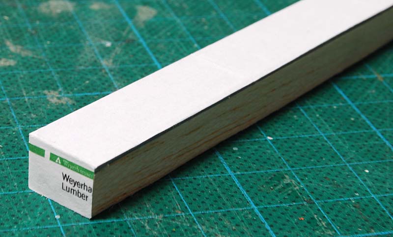

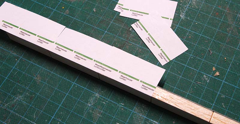

Then I glued the wrappers to the front of my balsa strips.
[Image: bt18.JPG]

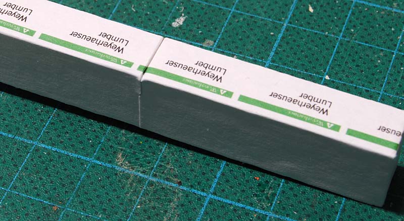

Next I wrapped them around the top and the ends and cut the paper to fit.
[Image: bt19.JPG]
I pressed the paper into the grooves in the balsa strips using the sharp side of my blade.

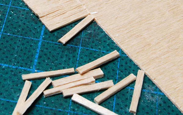

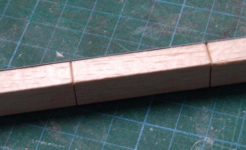

These are the 13 x 1 mm pieces that go between the stacks.
[Image: bt21.JPG]
I glued them to the bottom of three of the balsa strips.
[Image: bt22.JPG]

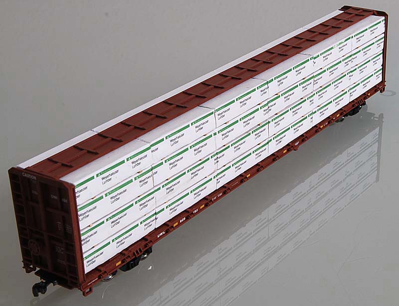

Final assembly.
[Image: bt23.JPG]
If anyone wants to give it a try, here is a PDF-file of my graphics: http://www.cnw.mattheydesign.de/weyerhae...erbeam.pdf
[Image: bt24.JPG]

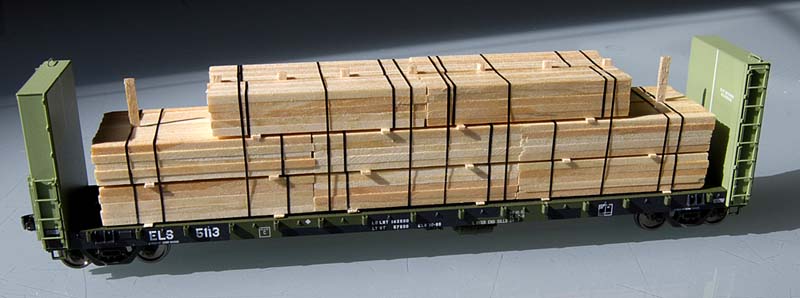

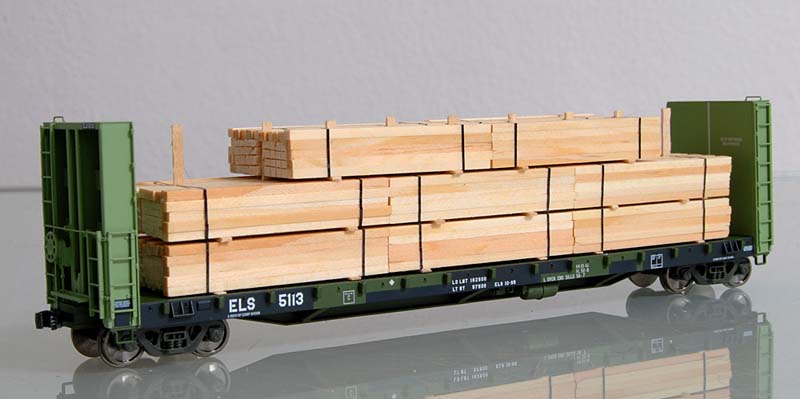

You should not stop when it is running well … so here is a load for my bulkhead flats. Now I "only" have to find a way to make it look like the lumber loads were fixed to the cars while making it possible to remove them easily …
[Image: bt26.JPG]
Kurt
#39
cnw1961 Wrote:...Now I "only" have to find a way to make it look like the lumber loads were fixed to the cars while making it possible to remove them easily …
Kurt, both lumber loads are looking great. The problem of fixing like the prototype and still be removable is even bigger for the centerbeam car. There are a hole bunch of straps running from the bottom very visible over the load through holes in the centerbeam. I did see several detailed instructions in the web but none of them was removable.
ps. The straps "should be" in place at unloaded centerbeam cars too...

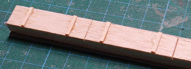

Reinhard, you are right, the problem is bigger for the centerbeam. I looked at a few more pics of bulkhead flatcars with lumber loads and on most it is not visible how or even if the load is fixed on the car. What you can see is that the lumber bundles are all securely tied together. So I added a few straps to simulate that. BTW, the straps are made from 0.5 mm (.02") wide and very thin self adhesive strips. You can get them at nail art shops (e.g. on ebay). The ladies use them to decorate their finger nails.
[Image: bt27.JPG]
For the centerbeam I have not found a solution yet and I do not know it is possible. I do not want to fix the loads permanently, because then it would be always the same cars coming in loaded when I am operating my layout.
Bernhard, thank you for the tip! I will keep it in mind, though in this case I do not have problems fixing the loads to my models, it is all about the prototypical look.
