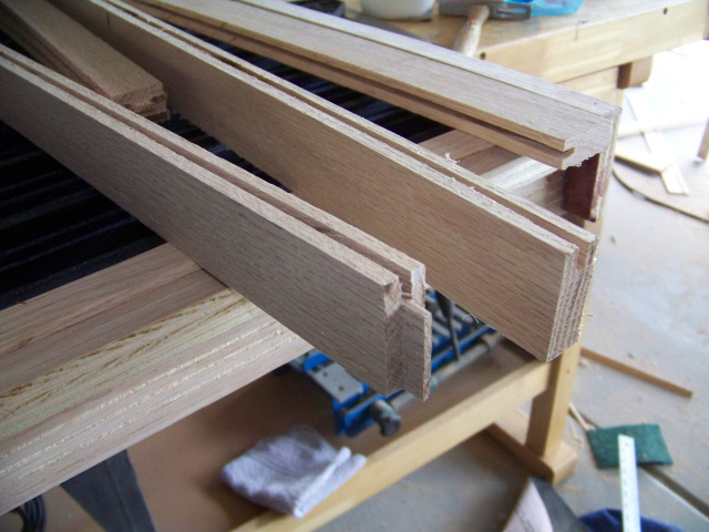

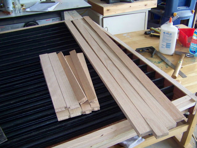

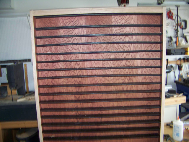

Yes, there is progress, no, it's not astounding enough to even warrant comments, even though there are quite a few hours of work there. I finished the fascia trim and cut the door parts. I decided to redesign the doors. Well, actually I had little choice based on the size of the piece of Plexiglas that I had. In order to use a single piece in each door, I would have had to use 2" wide pieces for the rails and stiles, covering up the top and bottom shelves when the doors are closed. I decided to add muntin bars (window dividers) and divide the doors into thirds. That way I could make the doors tall enough so they don't block any of the shelves. I also opted for a more plain look which made it easier for me not to have to route a fancy edge on all the pieces.
I added the fascia trim which gives me a total of 1.5" for the door frame to rest on:
Here are the door parts ready to stain and assemble. I cut tenons in the ends to fit into the slots I cut for the Plexiglas:
This is the first dry fit for the door parts to be sure all the spacing is correct:

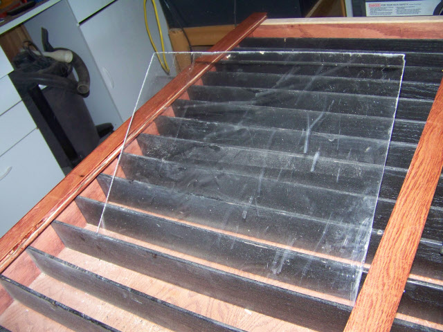

Well, I'm in the home stretch and find I have hit an impasse. I've been working with only the materials that I have on hand, just to make my challenge a bit more.... uh, challenging. Icon_lol I had one piece of 1/8" clear Plexiglas to work with to use as windows on my doors, and so I had to make each door with three panes rather than one because of the size of the panel. Now this sheet of plastic is at least six years old, probably more like eight, Confusedhock: and after about a year, the paper is almost impossible to get off. With new stuff, the protection paper comes of in large pieces, but the older it is, the smaller the pieces, so I came up with a solution. Icon_idea I soaked the paper in "Goo-Gone", then used a razor-edged scraper to peel the paper away. It came off easy and looked fine... that is until I cleaned off the residue glue, then I realized that the edges of he scraper were digging into the plastic leaving some pretty deep scratches. Curse I tried several ways to polish these scratches out, but all I've managed to do is to mess them up even more. Here is a shot of what they look like, some are worse than this one:

Good idea, thanks. I think Harbor Freight has plastic razor blades, I remember seeing them a few years ago. I'll check with Home Depot too since they're a lot closer. Even without the holder, they should work. I was also going to look for a plastic headlight lens cleaning kit. That won't take out the really deep scratches, but it should polish out the surface ones. I could come away in fair condition this way with four good ones and two not so good.

I've seen several suggested methods for removing the paper off of old Plexiglas, but I thought I had found a good one until disaster struck. Eek Maybe if I just soaked it in Goo-Gone, it would have peeled off easy. One suggestion was to spray white vinegar over it and scrub the paper off. I'll try your suggestion of soaking it hot water on a sample piece I have and see what happens. Something needs to penetrate the slick under-surface. There is still hope for four new pieces though. And yes, even though it is not a challenger rule, but one that is self-imposed, I thought about putting it aside but I'd like to abide by it since I'm so close to keeping it. One thing I will do though, is to route out the slots that will hold the Plexiglas in place so that I can replace it without tearing apart the whole door, just in case I wind up using some of the scratched panels.

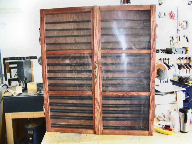

Here are some shots of the completed case. It measures 36" wide by 40" high and it 3" deep. I had to keep it narrow since the only place I can mount it is partially behind a door. Anyway, it still needs to be cleaned up and mounted, which I hope to be able to do today.
