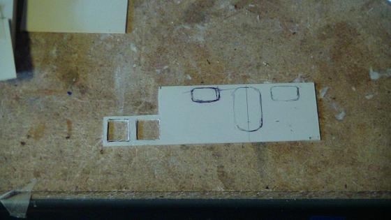

Cut out the first two windows, after looking at the pictures the 2 square windows are not the exact same size on the Ruby Belle so I am not going to worry too much about that other than file the openings to dress it up a bit. The 2 oval windows will be a different story and the door will be a cut out of a thinner material glued in place on the wall of deck house.

No pics but did cut out the square windows on the otherside of deck house. The other windows will have to be drilled out and filed good, the doors will be a glued on detail.
May do some more work on the Ruby Belle later on Sunday evening.
