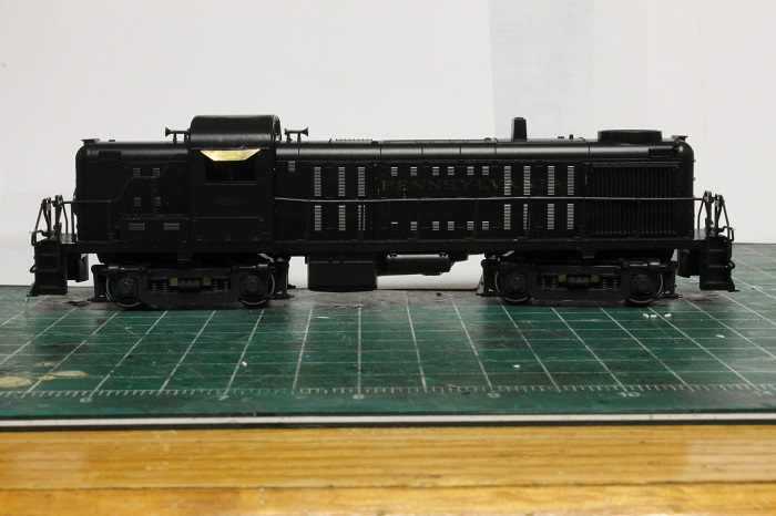

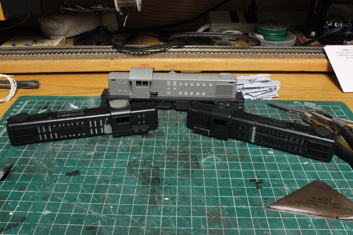

The Get Off Your Duff Challenge has got me modeling with some renewed vigor. I really like the classic lines of the early RS series from Alco and have decided to add a few to my roster. At this time I have a CNJ RS-1 and RSD-4 in the works along with a DL&W RS-3.     I have removed some of the paint and sanded off some of the unwanted details from the shells.

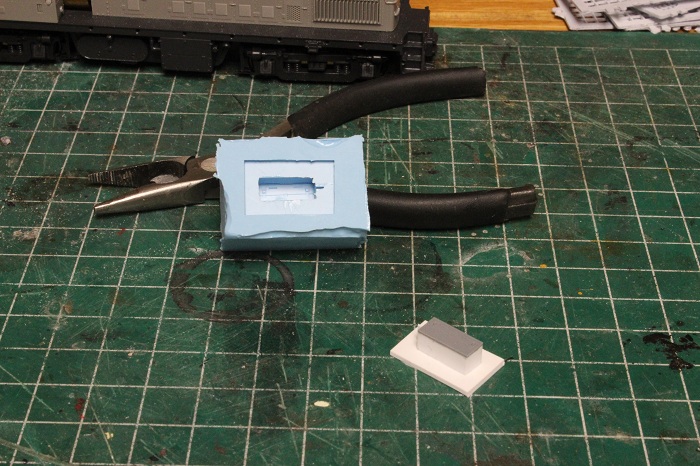

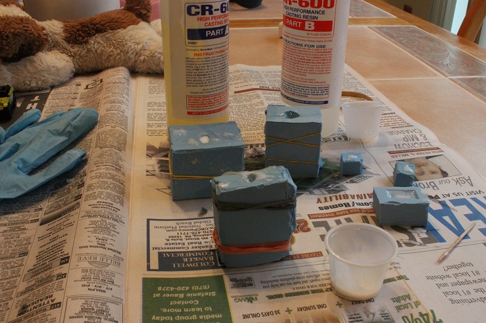

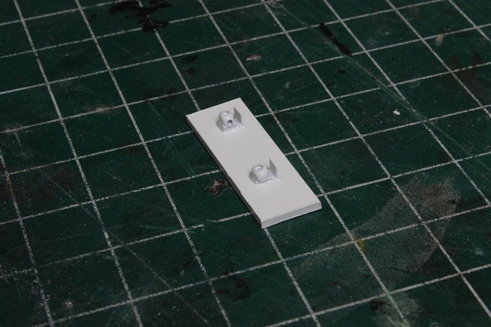

The RS-3 and D-4 have an extra box on the walkway mounted on the fireman's side, if your running them long hood forward (the only proper way to run an Alco). I do not know what this box was for, but all of my prototype shots show it. This detail is not on the model so I had to make it.     I built a master from some scrap plastic and a leftover part that looked like a battery box door. I then cast a few of them to use on the model.     I mixed a little extra resin and casted a few more Camelback parts just in case Big Grin .

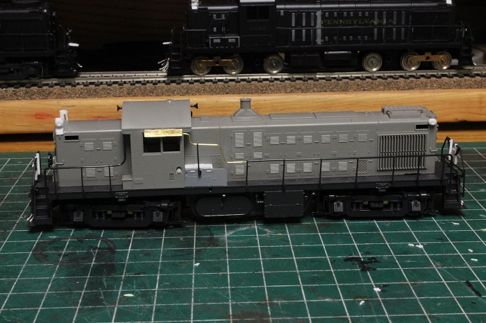

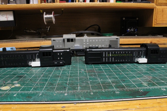

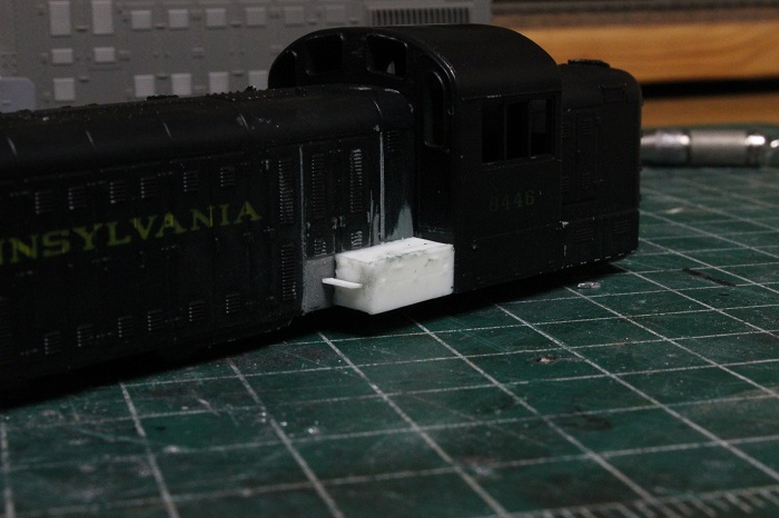

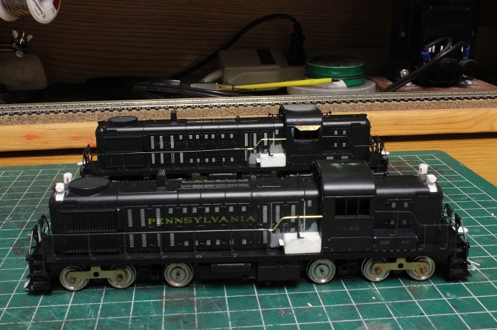

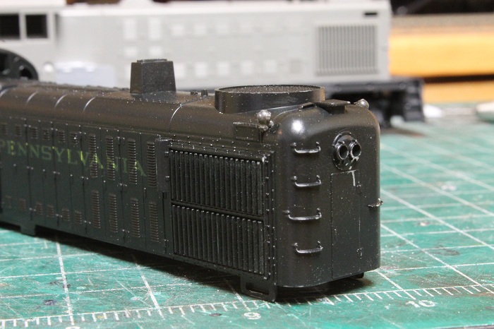

I have attached the new "control" boxes ( I think ). They are glued to the shells and not to the cabs so that they can still be removed . On the RS-3 and D-4 I used my castings, and on the RS-1 I built one from some scrap parts as it is the only RS-1 I plan on doing.
Here is a closeup of my castings, I had to file and sand the bottom of the doors of so that they clear the new boxes.

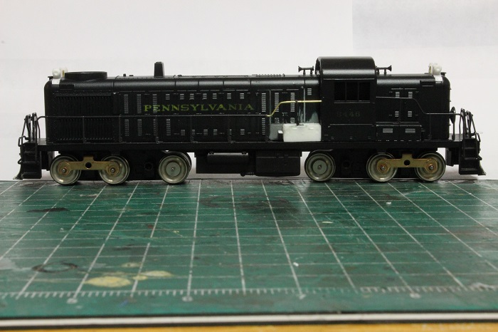

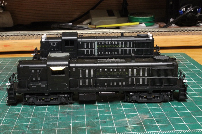

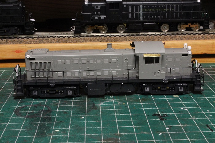

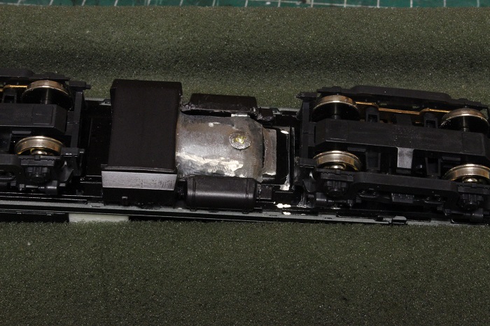

On the DL&W RS-3 I removed some of the material from under the frame. The pro-type for that model has only the air tanks in that location and not the extra large fuel tank. That was removed with a hand file and a hobby knife.
You can really see the difference when compared to the CNJ RSD-4 with a stock under frame.

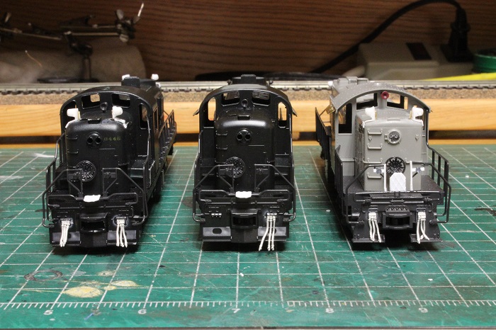

At this point the three units are ready for primmer and paint. The new details that I've added are sunshades, reworked handrails, marker lights, MU receptacles and hoses, the equipment boxes, and folding end walkways.

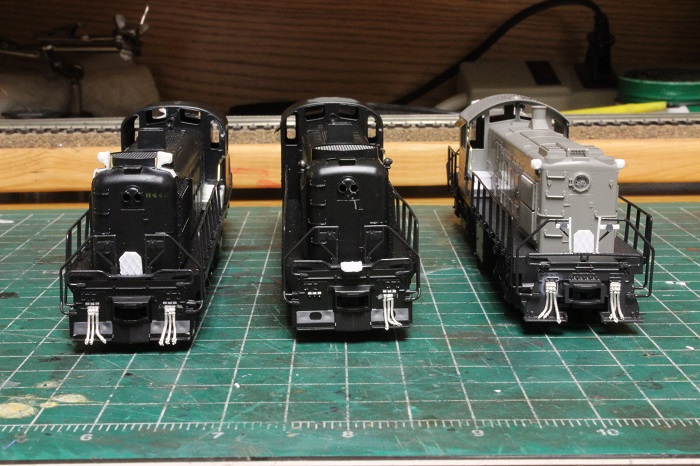

Here are a few more pics, this time of the pilots.
And here is the CNJ RS-1.
I might be mistaken, but aren't thise boxes battery boxes? Joe Hueber
They could be,, They are of the same type of construction, but the normal battery box location is already included in the model. Most likely they housed some type of road specific signal equipment, or something along those lines. I asked a few people at the Anthracite railroads historical society ( where I am a member ) about them. When I hear back from them I'll post what they really are.

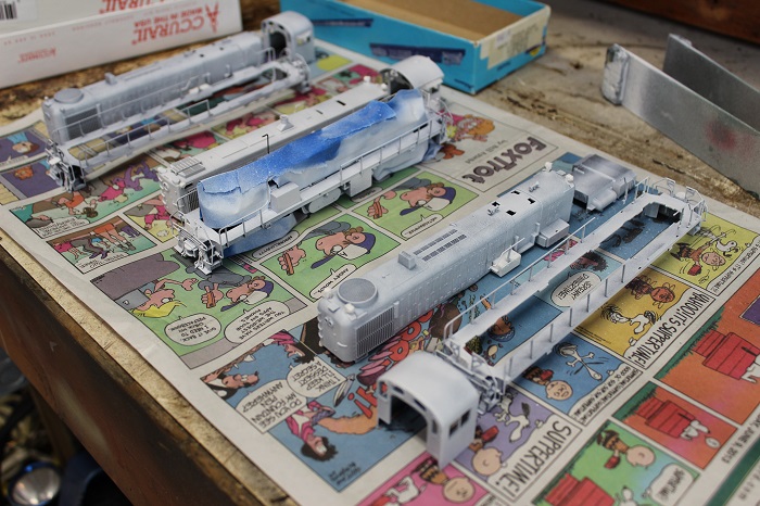

Got them all primed up and ready to paint today.
e-paw Wrote:Got them all primed up and ready to paint today.
Just curious what are you priming them with, and which paints will you be using to paint them?
Looking great so far. Thumbsup
Koos
I use Poly Scale water base paints with a double action airbrush. The two CNJ units will be Deep Sea Green (C&NW Green, It's the same color). The DL&W RS will be black.
