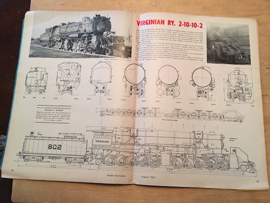

In a Clean out and going through 1/8th of my model railroad magazine collection I came across this .
ERIE RR
Posts: 990
Threads: 47
ERIE man, hallo!
Yes, the AE stands permanently on my worktable and you can see it on some pictures from time to time however only in connection with other projects. In present time is the biggest problem that I do not have a really use for this model and unfortunately the model with its extra wide front cylinders do not run on the modules of my friends which are the only chance to run the loco on different sessions.
And there are also to many other preferred projects which I lve to realize. However I should hold it in my mind that there will be a great project in future and maybe that I will start with that.
