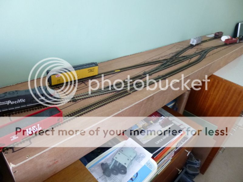

If you were to use a diamond crossing to your spurs, you would gain extra length.
[Image: smP1000232_zps60496972.jpg]
(Not sure what the proper terminology is, but I have incorporated one on my I.S.L.)
