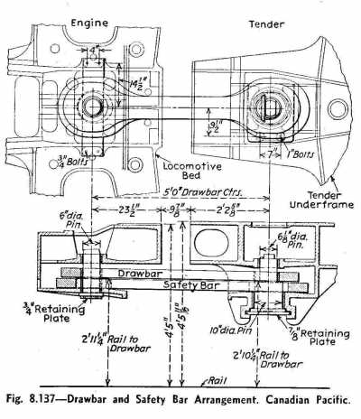

here is a drawing out of the 1947 locomotive cyclopedia showing the draw bar and safety bar this what most loco's had there are variations though..
hope this helps.
Jim

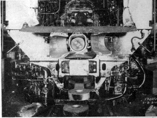

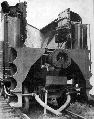

here are two photos showing the engine and tender though they are from two different engines.
you can see the draw bar and safety bar on the engine and some of the connections on the tender.
Jim
jim currie Wrote:here are two photos showing the engine and tender though they are from two different engines.
Jim
