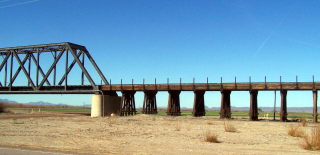

As i said i would in first post here is a photo of the SP bridge over the Gila river near Roll AZ it has a timber approach on the north end . built in 1923.
Jim
#23
thanks for the post guys.nkp,im going to add more pilings and beams lengthwise and even more bracing.it should be fine after then.it will atleast give an impression of a rickety logging bridge Misngth ,and great pic jim Thumbsup , its pretty interesting how they did that,althoug nit uses concrete to support the metal truss itself.-josh
