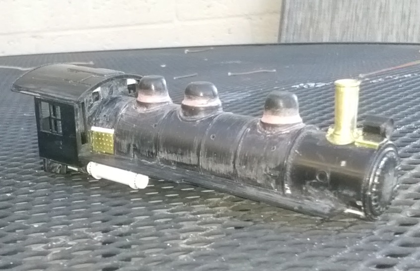

#16
I added some smokebox detail by embossing some thin brass with a small punch in a pin vise. I also cut some cab windows, made a headlight platform, and added a headlight from the scrap bin.

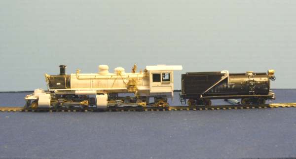

On my narrow gauge 2-6-6-2, I decided to try something "new".
I mounted the motor in the tender, with a universal drive shaft, connecting it to the gearboxes in each frame.
In this photo:
The motor is mounted to this "sled" which inserts into the tank of the Vanderbilt tender,( attached to the end of the tank ) and is held with a screw under the tank, between the tender frame pieces. the shaft, with the universal drive slotted cup, attached to the motor shaft . The gearbox shaft will run under the cab floor. I got the parts for this drive from Northwest Shortline ( http://www.nwsl.com ) The "can" motor is one of their products.
Hope that helps.
Here' a shot of the 2-6-6-2 { I really need to get back to this project.....but I have a tern to finish first } as it is right now.
There is still a "bit" of work needed on the chassis, as there is :x binding in the side rods :x
Here, front to back:
The 2-6-6-2, my 2-4-4-2, my 2-8-2, and behind those, a brass Sumpter Valley RR 2-6-6-2

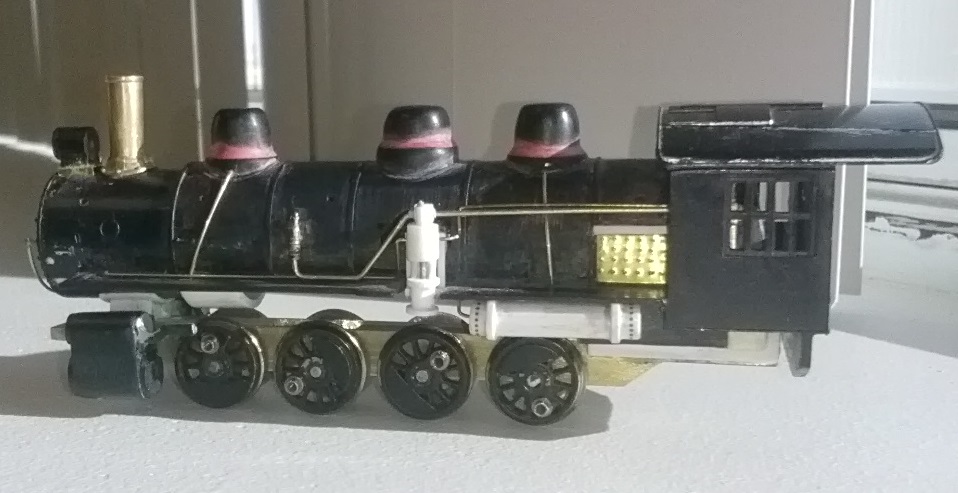

Added a compressor and some piping.

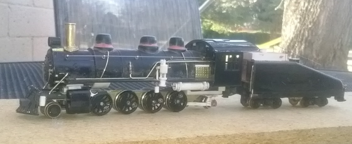

#25
Occasionally during a build like this, one must put all the components together to see if things are still fitting. So here it is. Major things left to do include the mechanism. I still haven't figured out exactly how I want to mount the motor or NWSL gearbox. I've been using PCB board for bottom plates to that I can easily add power pickups on the drivers, but because of the width of the gearbox, that may be tricky in this case. Other than that, things are fitting together quite well. I have most of the piping installed, but still need a few pipes under the cab.
#26

I'm using valve gear components that I bought on the Bachmann parts website for the USRA 0-6-0. I figured the dimensions would be closest to what I am building and would require the least modification. When I got it, I realized it would require more modification than I thought, so in the long run it may not be worth it. I already knew the main rods would be too long, so I was already planning on modifying them or using main rods from an old MDC kit. I started with the MDC rods, and they were maybe about 1/8" too long. I tried to modify them, but they are cast white metal and broke. So, I took the Bachmann rod, shortened it on the end where it attaches to the crosshead, and glued the detail from the MDC rod onto the end that attaches to the driver crank. I also soldered a small washer on the crosshead end to serve as reinforcement. The Bachmann rod also offers an advantage because it is stamped brass and thinner. This will provide a bit more clearance that may come in handy considering I am using drivers that have a standard-gauge tread width on an HOn3 loco.
