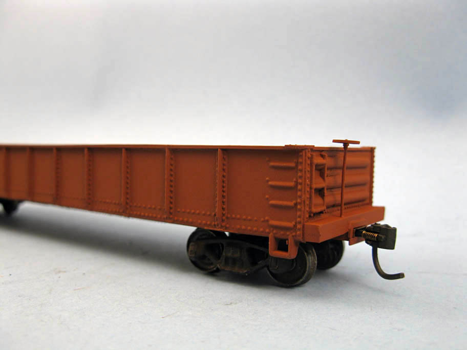

And now, here's the final product when painted and awaiting decals. I must say there is very little evidence that can tell the origin of the car.

To be noted, if it was cars that I would use on my personal layout, I would install metal grabirons and stirrups. Reworking the underframe brake detail would also be done (maybe installing a fishbelly underframe). Finally, improving the car ends to have the correct rib pattern would also be easily feasible. I choose not to do so, but it wouldn't require a lot of skill and could turn these models into something quite respectable. It's just a demonstration that you can get decent models while bashing stuff that doesn't look promising at first.
