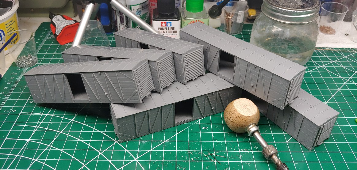

20 boxcars.
68 #79 holes on 11.
72 #79 holes on 9. (two extra grabs on each to match prototype photos I found later on.)

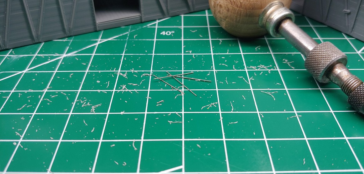

1,396 #79 drilled holes in total...if my math is right?
Drilling the holes for the last six I'm working on I managed to break four bits.  I got lucky and was able to extract all the broken tips without having to resort to drastic measures.  The shavings on my cutting mat are just a small amount of what was left when I was finished as I was constantly cleaning my work area.
This is a major milestone to me.  I was dreading building the remaining lot until a couple nights ago I just bit the bullet and got started.  Still have to install the grabs and there are extra details I want to add but man, am I glad that step is DONE!!!
A celebratory drink is in order!  Cheers my friends!

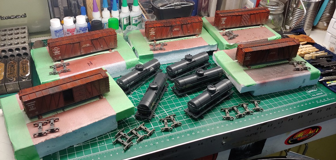

I've been busy a busy beaver...  The boxcars are ready for the final coat of dullcoat.  Then I can place them into revenue service.  The tanks are ready to be weathered and then the dullcoat applied to them. I just painted 10 sets of trucks and wheels for all of them.  (The wheels are off camera.)  I also applied the first colour coat to three more of the box cars I'm working on.  Whew!!!

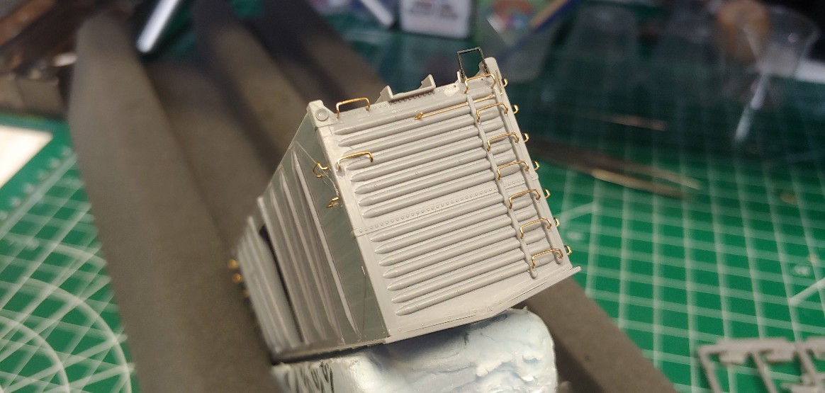

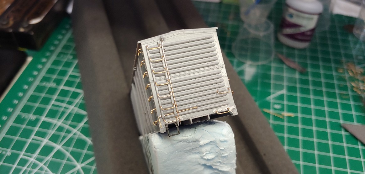

Based on a drawing from the CPHA website I obtained of the USRA clones used by CP I've decided I'm going to attempt to add some extra detail to the last six boxcars I have to finish building.  The retainer valve and pipe on the B end and on both ends, cut levers and a stirrup step on the ladder side of the car ends.  I like the asymmetrical look this gives the car so far.  It took me awhile to do this one end, however now that I know how to approach it, the remaining cars shouldn't take me as long...I hope...
Finished up the other end this evening.  The A end is made "easier" because there is no retaining valve and its piping...yeah...easier.

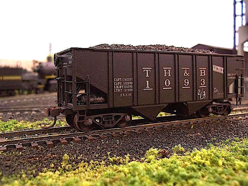

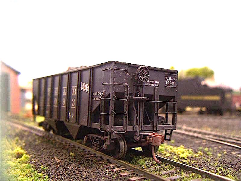

I'm currently rebuilding a couple of hoppers that I modified almost 20 years ago, following an article in RMC.  I had always thought that they turned out rather well, but re-reading the article and looking more closely at the photos of the real ones, I can see so many places where improvements should be made.
For these cars, I used two-rung Delrin sill steps from Tichy, and was fortunate to get a good fit, applying ca after they were in place.  To re-work the two cars, I had to remove some of the added details (one of the cars got dropped, and removed some of its own details, including parts that could have otherwise remained).
Because I was planning to re-work the car's sidesills, the Delrin steps had to be removed, too.  While I could have simply cut them off, I used a pair of smooth-jawed pliers to carefully grasp each one, and without breaking or distorting any of them, all were removed without incident.
When I re-install them on those two cars (and on the other ten on which I'm currently working), I'll use the prep, as even if your drill bit is exactly the correct size for the mounting pins, chances are the pin vise will not always remain perpendicular to the work-surface as the holes are drilled, usually resulting in a few loose fits.
Here's one of the two originals...

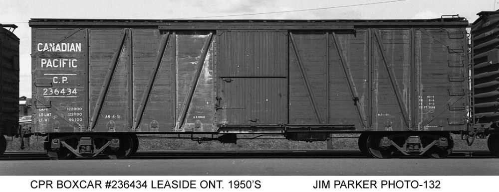

This one build I've decided will round out the car numbers.  As I've decided to model based off this prototype photo.
