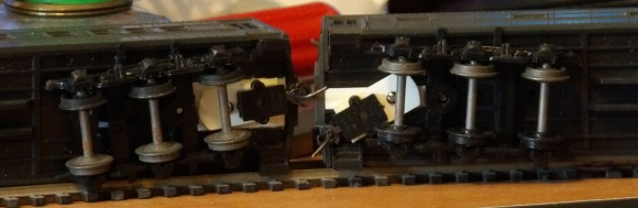

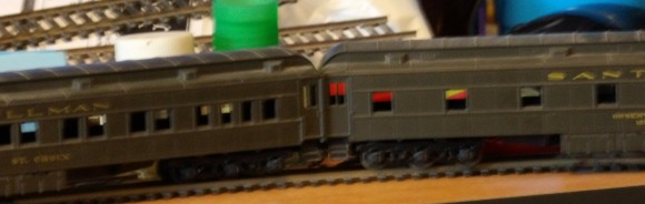

i replaced the truck mounted ones as the car spacing was too much so I used a form of body mounting the photo's show what i did . after cutting off the truck mounted ones i placed a shim on the underbody then cut a piece of .080 styrene mounted the coupler box on it and used a 2-56 self tapper to mount the coupler had to use under shank ones to get proper height. these are standard Ahearn cars , the first photo show's cars on a 18 inch curve , the second show's the mounting . this isn't a original idea I adapted it from assembling a Ahearn 86 foot auto parts car have also done it to rivarossi cars .

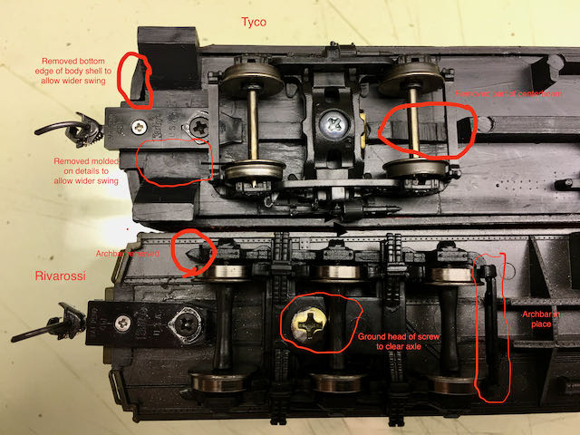

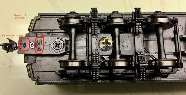

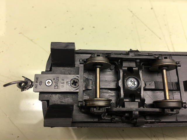

I always remove truck mounted couplers and body mount new Kadees. The main reason is for reliable performance. If you want your cars to perform properly, whether pulling or pushing, the truck mounted couplers have to go. Aside from performance, they look awful. The Kadees should be mounted in the same position as couplers that come body mounted, to begin with. If I can figure it out, I will add photos of a conversion I did. The photos include notes that explain what I did and some gotchas too look out for. It may seem daunting, but if you take your time and thoroughly examine each type of car to be converted, you can do it. Glenn
