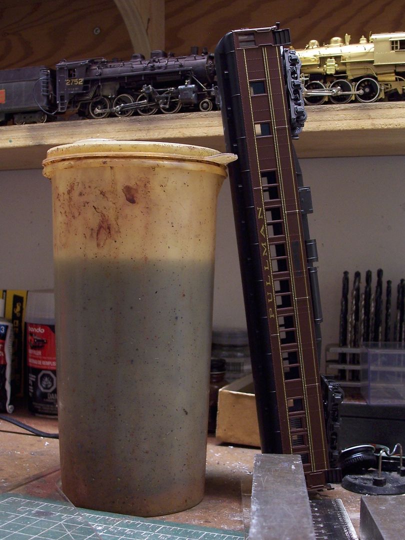

A safer choice might be Super Clean, as I've used it for stripping paint from all types of rolling stock without any ill effects on the plastic. It's supposedly somewhat caustic, but I've handled partially-stripped items un-gloved, with no ill affects. However, if you need to fish the item out of the container that you use for the stripper, it might be advisable to wear nitrile gloves.
I use this former Kool Aid container for Super Clean, although it's too short for most HO scale passenger cars, which need a "double-dip" to get the paint off the entire car....
Simply toss the item into the container, cap it, then come back later to see if the paint has started to come off or is only starting to soften. A toothbrush (used or new) is useful for scrubbing-off the softened or already loose paint. Some types of paint may take longer than others, but it seems to work on pretty-well any type of paint.
It also has a good shelf life, even after you've stripped a number of items, as long as you keep the container capped. The loosened paint usually simply drops to the bottom of the container, but the fluid remains useful as a stripper, even after multiple uses.

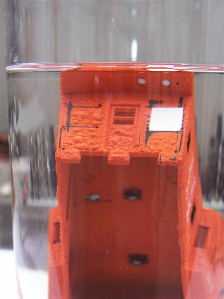

My former go-to paint stripper was methyl hydrate, which doesn't have much effect at all on many current-day models, but may work on on your older models.

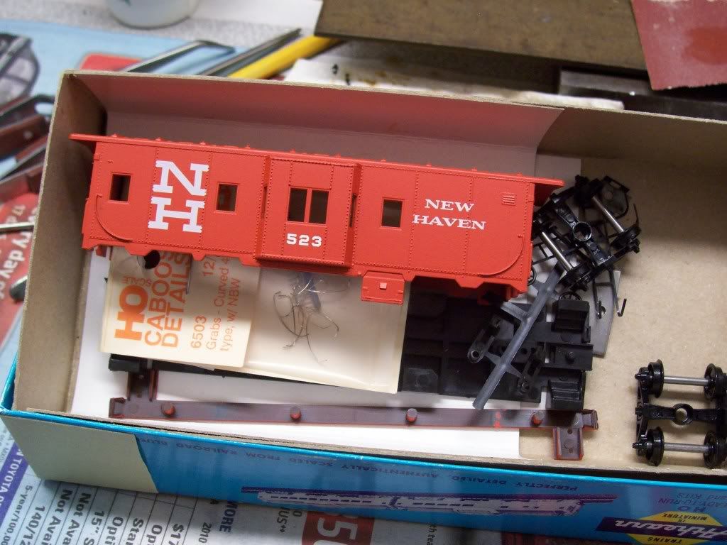

I got this Athearn caboose for a couple of bucks...
...then dropped it into a container of methyl hydrate. Within minutes, the paint began to blister...
It took only a few minutes and a little work-over with a toothbrush to get all paint off the body shell.
While methyl hydrate is used primarily for thinning shellac and varnish, it is also a good paint stripper...but not for all paints. You should be able to find a pint (or gallon) of it at any hardware store or home improvement outlet.
I'd consider it a type of alcohol, but one that's on steroids when it comes to stripping paint. Work in a well ventilated area if possible.
