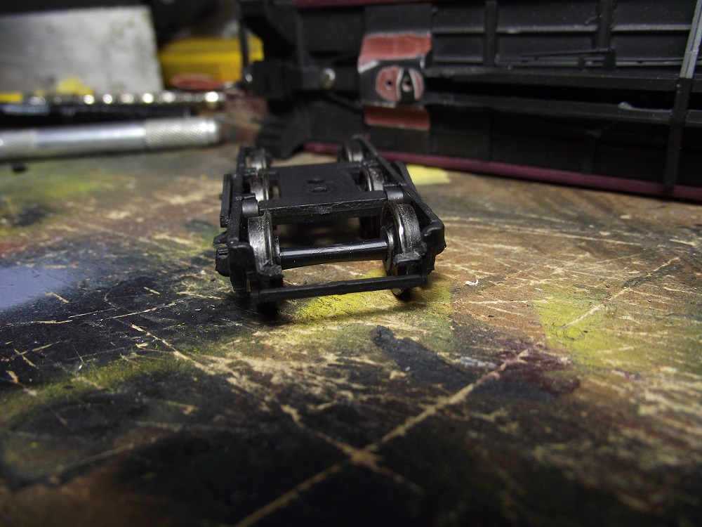

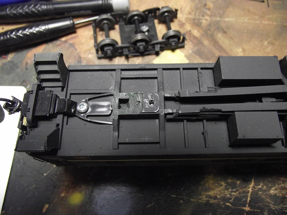

Thank you for your advice. Armed with your and some others suggestions I performed some surgery on one of the cars.

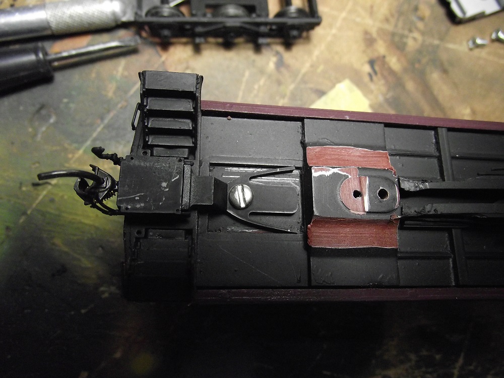

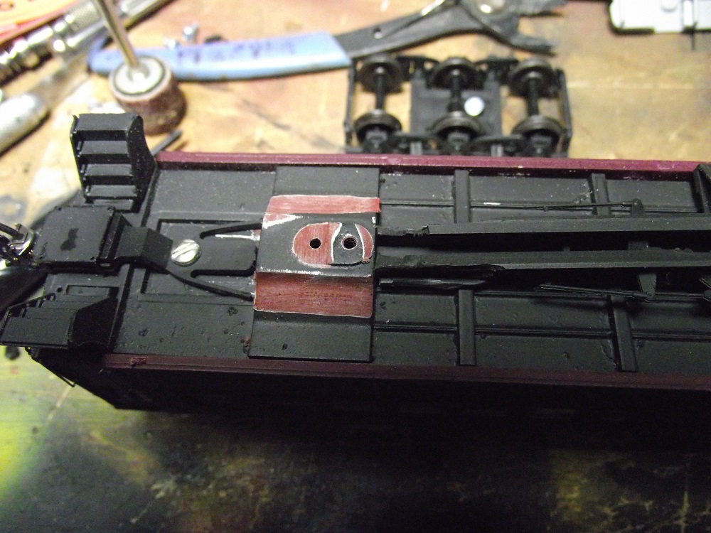

The center wheelset was hitting the bolster sides so I took my dremel sander and removed the material you see. I also cut the brake rigging back and sanded the center sills flat.
I also trimmed the brake beam like you did. After these mods, I found that the car could finally coast freely around the layout and the 26" curves.
My next step is to repeat the same procedure on the second car. I know the modifications look a bit extreme but once I repaint the areas and re-install the trucks it won't be that noticable.
After that I'll look into freeing up the coupler swing. I think I need to shorten the plastic 'springs' as they appear to be binding.

I modified the coupler box swing/spring mechanism slightly. I reamed out the mounting hole very slightly because it was too tight and causing a bind, then I shortened the plastic 'springs' by about 1/16".
I decided not to add the coupler yokes or coupler cut levers as they would interfere with the coupler swing on anything less than 28" radius curves. I'm also looking for replacement diaphragms as the branchline ones are too fragile and assembly looks too finicky.
I was going to make the same bolster modifications to my Branchline Pullman car.
But this one was better engineered so the bolster doesn't come into contact with the center wheels.

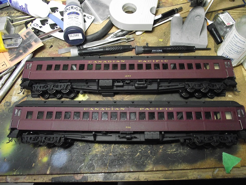

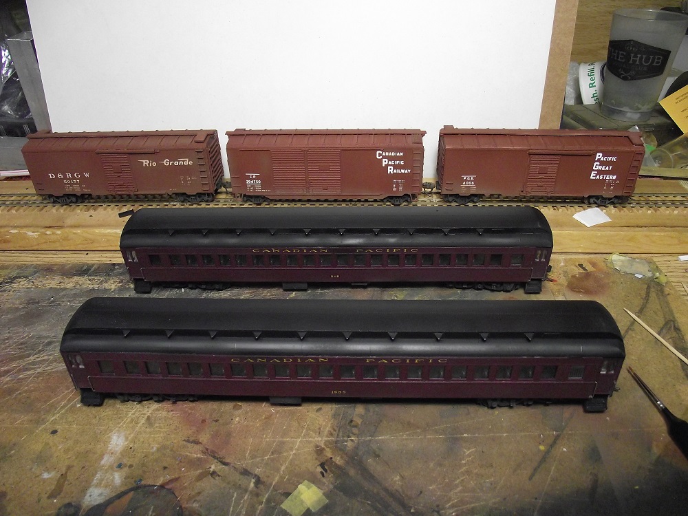

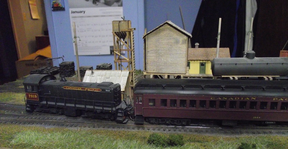

I completed the two CP cars this week along with three freight cars that had been waiting their final airbrush weathering.
I just re-painted the areas that I had to grind away for the truck swing and touch up others that had some glue staining. After that I airbrushed some polly-s dirt on the undersides. I'm stating to run low on the Polly-s Dirt weather paint so I waited on the weathering for the three freight cars so I wouldn't waste paint.
I also want to take a moment to thank everyone who encouraged me and gave their advice on this fairly challenging project. These car would have not been completed without your help.
