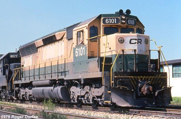

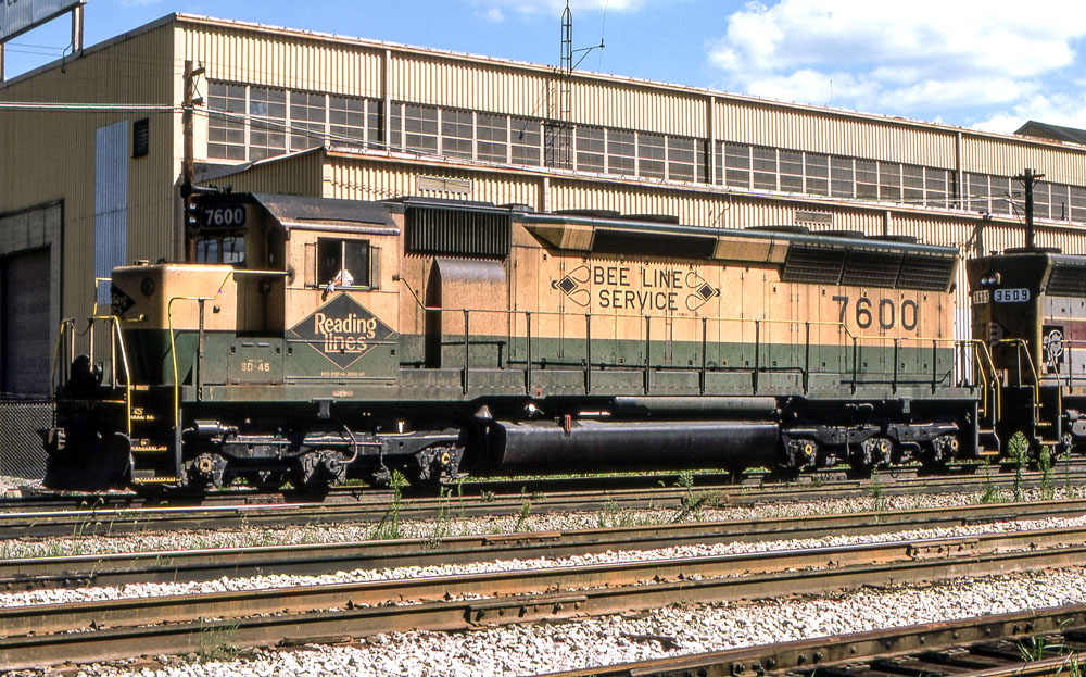

I then started searching for a prototype weathering that I'd like to mimic.  Found this shot in an Akron Model Railroading site. Love this look!  And guess what's riding shotgun?  An EL SD45, and this is August 1976...

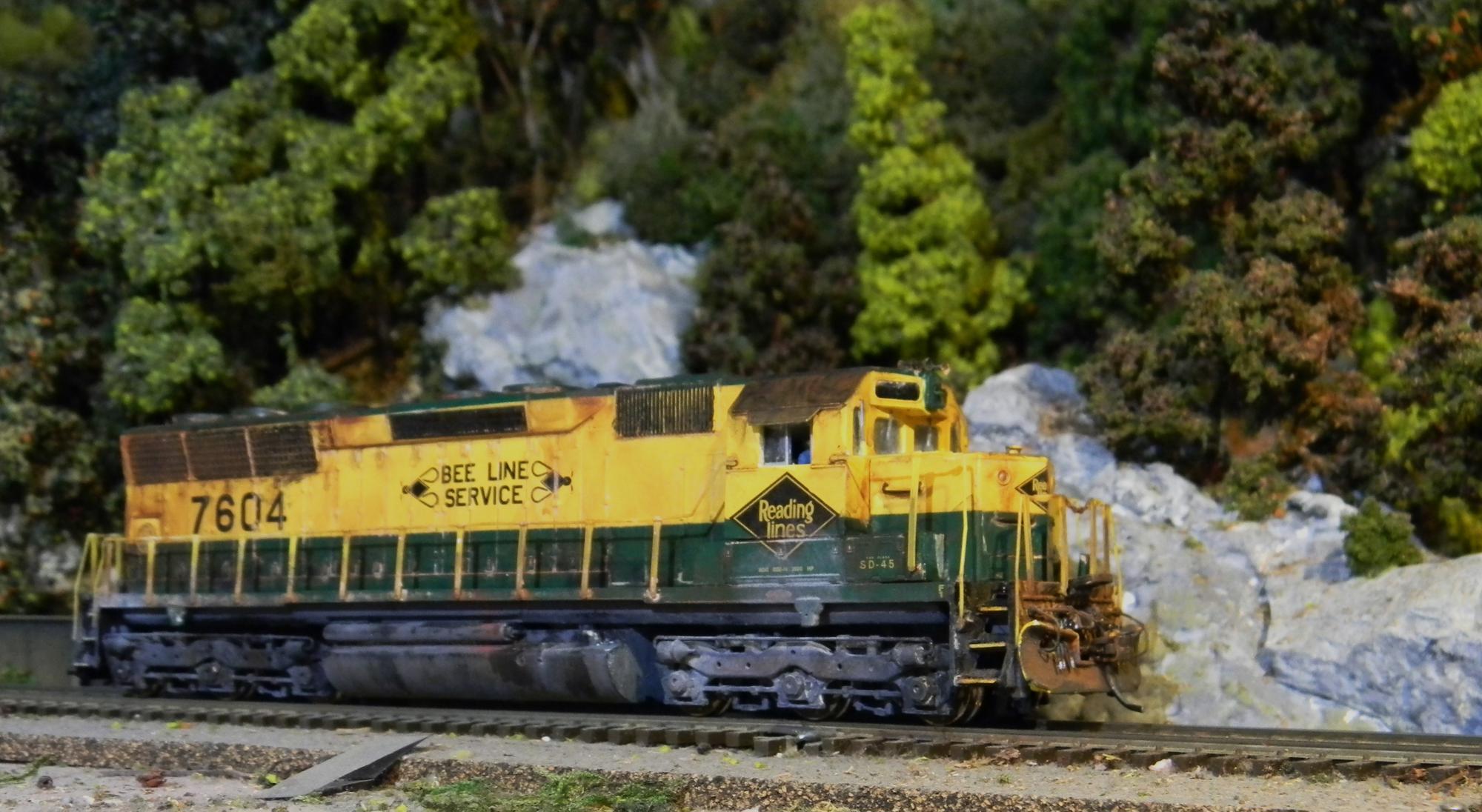

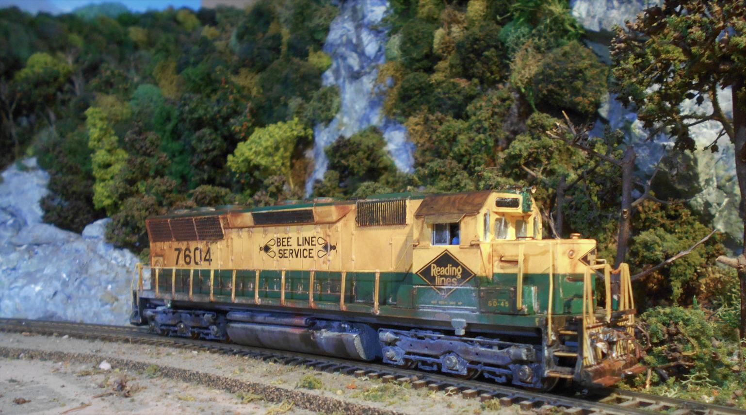

We'll do a before and after....

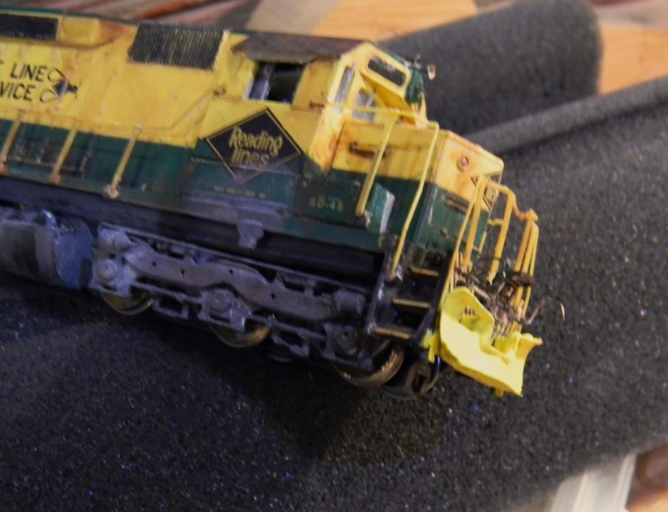

Factory fresh...
Beaten and abused...  I did use the fade technique with the Tamiya Flat Base - liked it!  Anyway, both of the SD45s are now no longer mint.

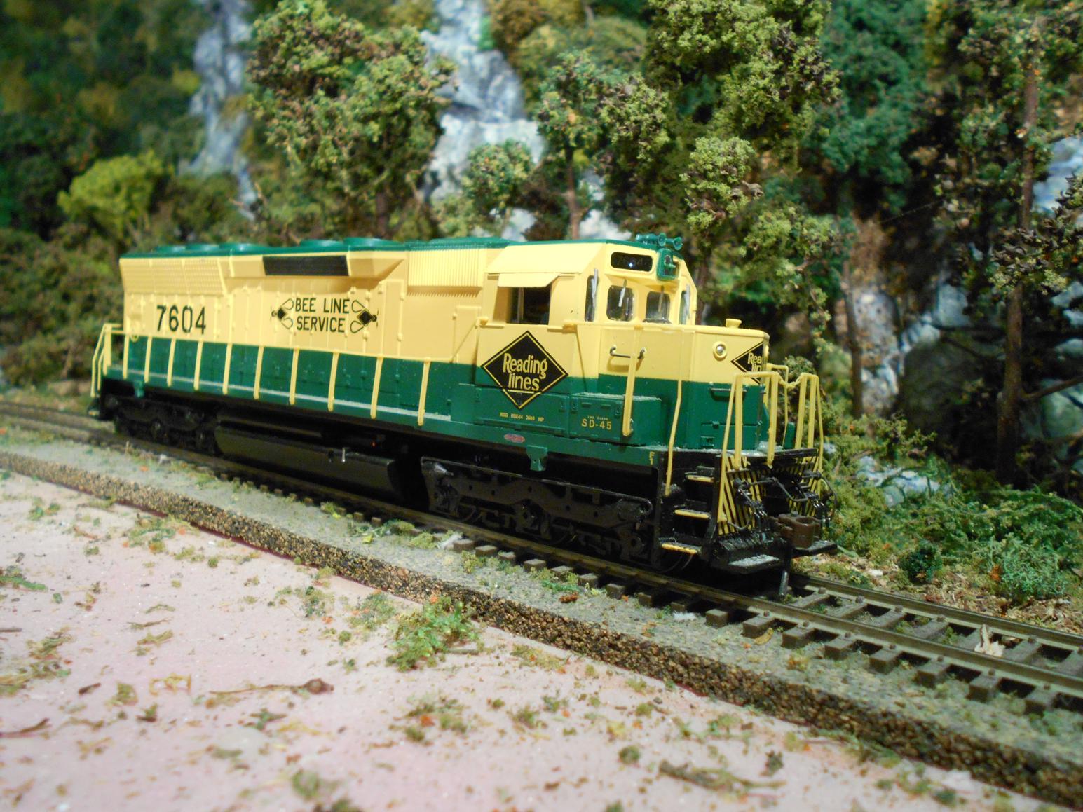

Both are Spectrums. Got them for a song (I think they were less than $60 each) about 10 years ago. The Reading unit shouldn't have the roof louver over the window and there are probably some other issues that I haven't picked out, but they're good solid runners after replacing the DCC encoder they came with.
#20
I have three Reading ones. First one, #7603, I bought when I got back into the hobby in July of 2000. I got it at Boscovs and actually still have the receipt. Paid $42.39 on sale. The other two, #7602 and #7604 I got off eBay back 2020. I like them and they run well. One day I would like to convert them to DCC.

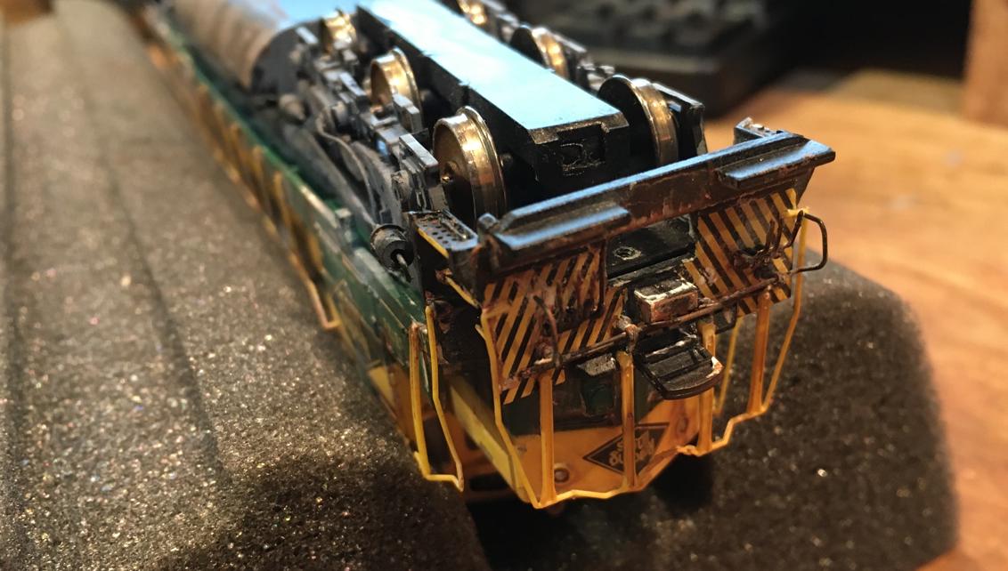

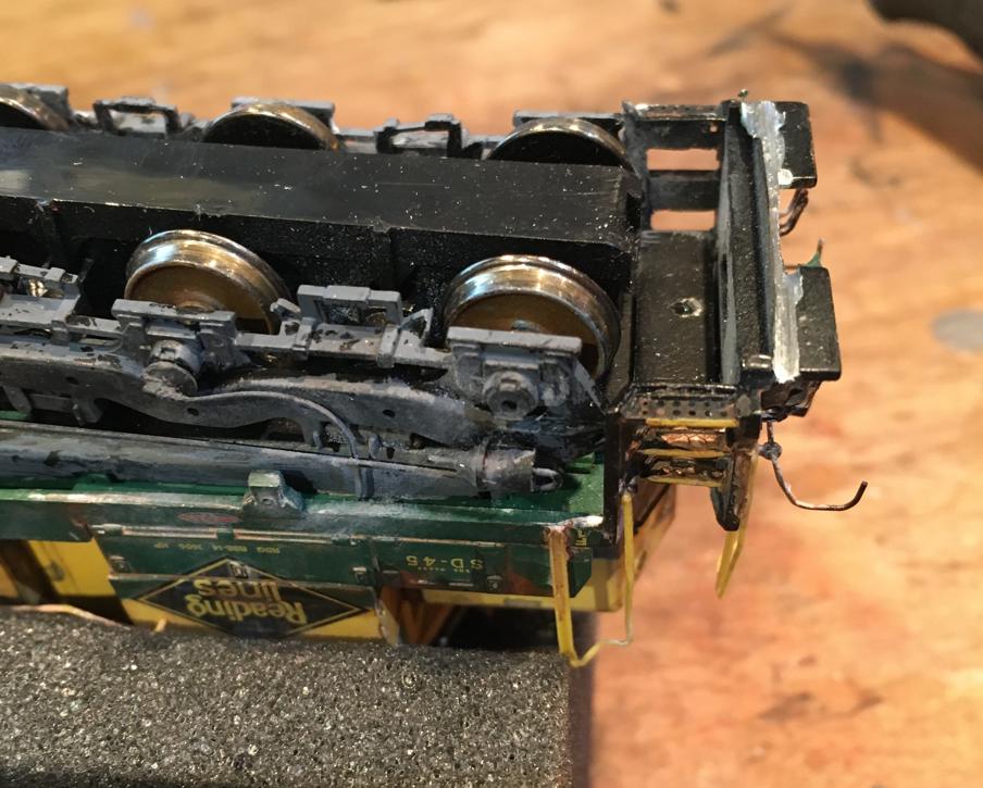

Details West makes some nice plows and I bought one last week.  It's white metal and will probably look pretty good once I get it painted (yellow I think - have to find a picture of a factory fresh unit).  HOWEVER, the front bumper of the unit needs to be flush up to about the area where the MU hoses emerge to mount the plow.  The Bachmann model has the default front riding steps (fine for the EL model I have since it looks like a lot of EL's roster did not have the plow) that I will have to grind off flush in order to install the plow.  I figure some delicate work with my Dremel should do the trick.  Once I mount the plow I'll have to make it look as dingy and rusty as the photo above. Photos of progress coming soon I guess.
#25

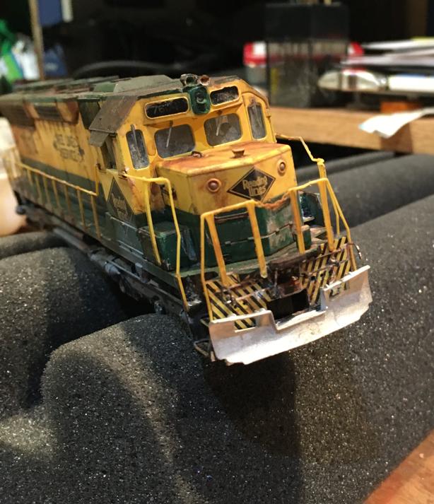

Got the Dremel out tonight and laid waste to the front bumper.  Did most of the damage with a cutting wheel, removed the MU hoses, then followed up with a couple of burrs and a sanding wheel.  Drilled two 1/16" holes for the plow studs and inserted the plow.  Checked out the fit and made sure the coupler still had enough real estate to operate.  Tomorrow we paint and glue!  Pictures....

This little snowplow project led me to think about 5304 - a Stewart Hobbies C630 that's also on my roster.  It currently has no plow.  Did a little digging.  The Reading bought two orders of C630's from ALCo in the late 60's.  The second order, after looking at some pictures came complete with High AD trucks, the "Bee Line" logo and a snowplow.  I started thinking about adding a plow.  However, the first order (of which 5304 was one) didn't have any of these features - no plow.  My C630 is safe from potential mutilation!  Then I got to thinking.  That unit is tailor made for a Conrail patch job and has not been weathered...  something to think about for the future.  Anyway, I painted up the plow - a base coat of dark gray and then a bright yellow that I'll hit hard with rust and other weathering implements.  Once I get it about right, I'll mount it for good and reattach the MU hoses and coupler.  On another side note, on my search for SD45 details I ran into this guy's 3D print of an SD45 cab.  I've pinged him to see if he'll sell me one...  https://jlandtrailroad.blogspot.com/2021...ished.html

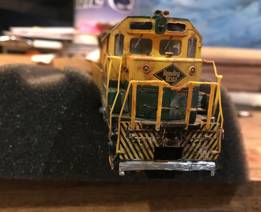

Here's a shot of the mounted and pristine painted plow.  Weathering to commence very soon!

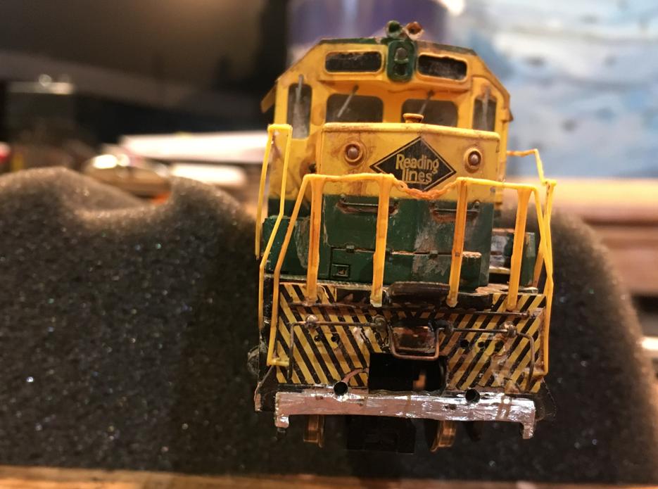

And here we are back on the rails, coupler and MU hoses reinstalled.

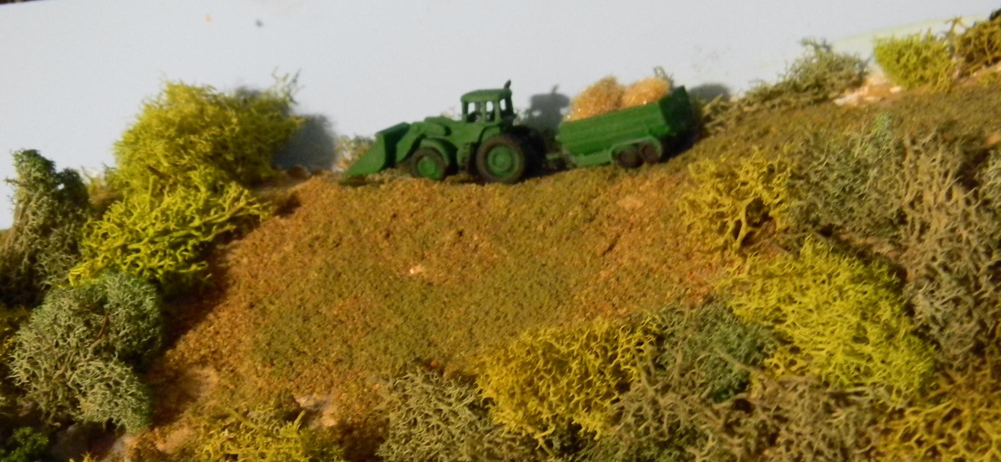

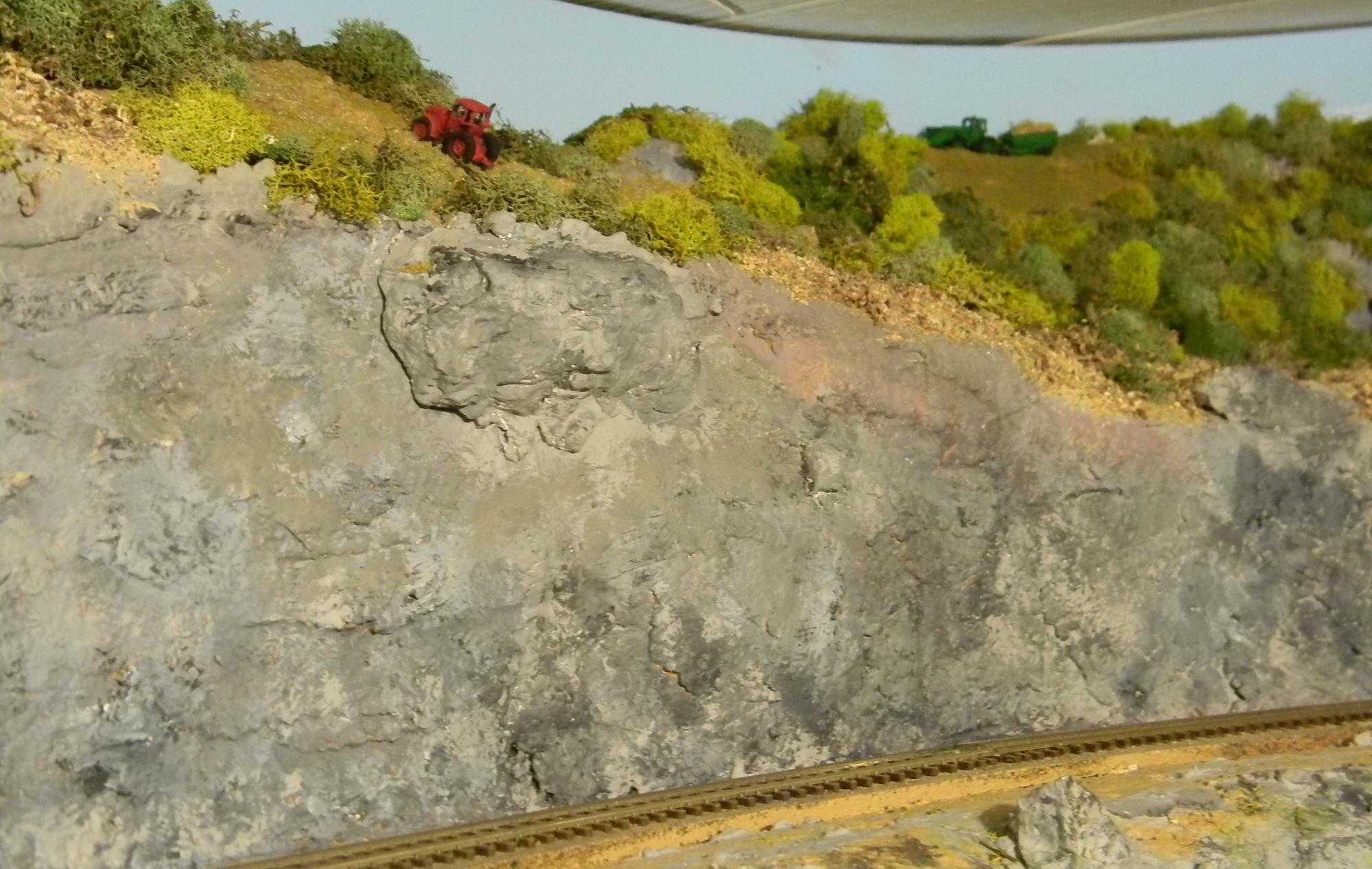

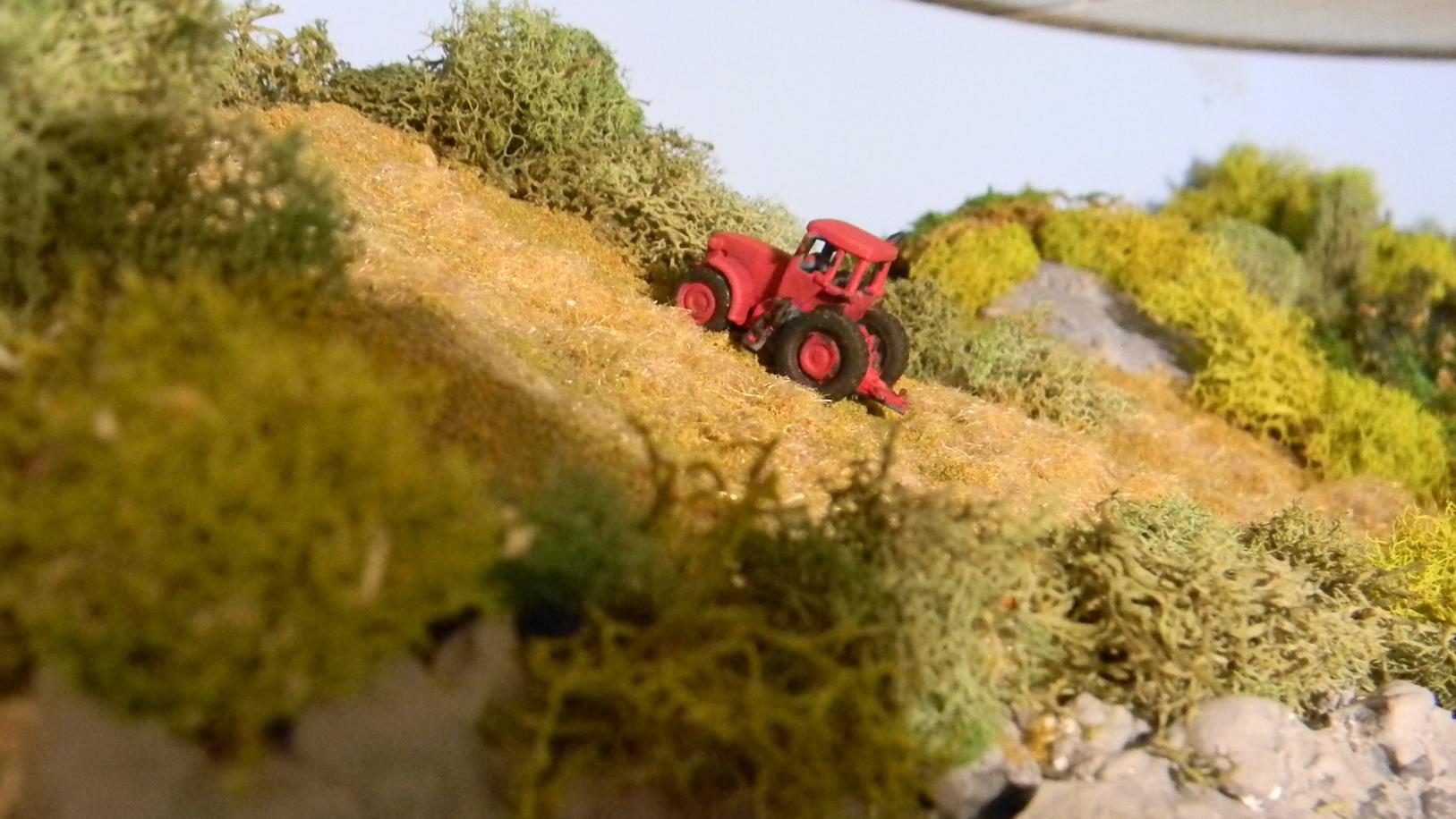

While working on the upper section of Mud Run a few weeks ago, I decided to put some farm fields/pasture in the scenery.  I then thought what else might be a good addition to the scene.  Started looking for cheap N-scale tractors (N-scale to give the illusion that the fields are further away than you think when you look up at them.  Found a package of 2 different 3D printed tractors (one with trailer) from Outland Models (Chinese).  They also had some "haylike" filler in a baggy that came with the tractors and I thought it made pretty good freshly cut hay.  Spread some of that one one of the fields in rows and loaded up the trailer with the same. Decided to paint each one today and install them on the heights.
Here's a closeup of each one.
