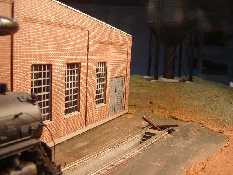

If the pits included with the Walthers roundhouse are correct, I'd say about 4'. I built an outdoor pit and used stairs by, umm, can't think of who right now. Maybe Pikestuff? Anyway, I just used sheet styrene cut to match the steps and I just measured the depth, 4', close to the Walthers. A couple pics, ground cover to come soon.

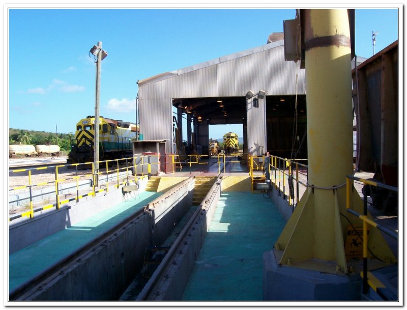

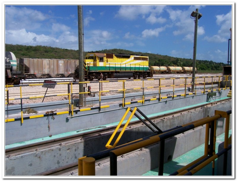

If you are modeling a somewhat modern facility, here's an idea I got photos of of a car & locomotive shop in Jamaica. This is an outdoor inspection facility for cars and engines.
Might be an idea worth exploring. They are 5' deep. The large yellow pole to the right is a 5 ton capacity L Shaped Jib Crane with remote.
I think this shop and inspection facility is what I'll use for an idea on my layout. Might be worth considering for yours.
