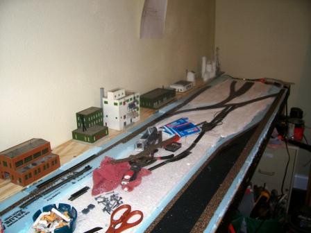

Posted by: pennman - 09-17-2009, 07:57 PM - Forum: Layouts - Replies (23)
Well guys for along time I've been slowly working on this layout. All of you that where on the Znet have seen the early pics from the start of the addition to the beginings of the bench work. We have since progressed quite a bit.
About the layout; its Penn Central in Nscale era 1965-1975 I built what I grew up with (guess I'm showing my age) Its based on diffrent buildings and ares in which I always found interesting thoughout NJ.
The B&NE is a fictisous short line built and created by myself and a longtime friend butit adds some nice interests.
Attached Files Thumbnail(s)
