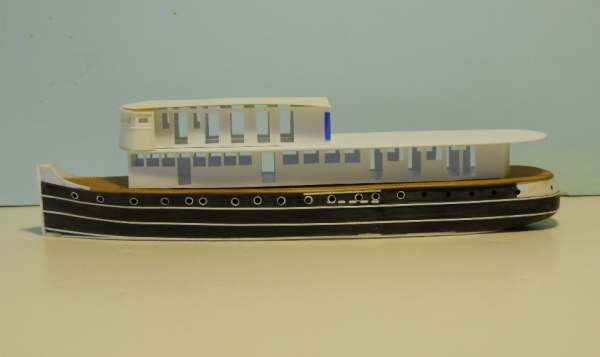

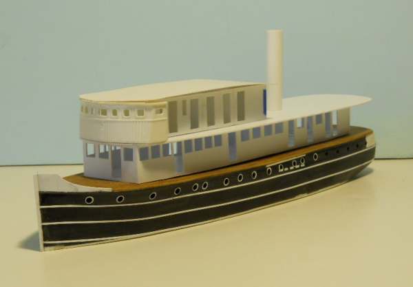

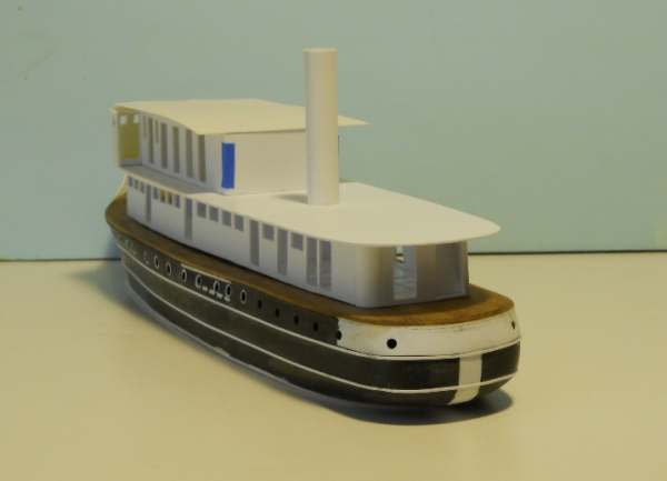

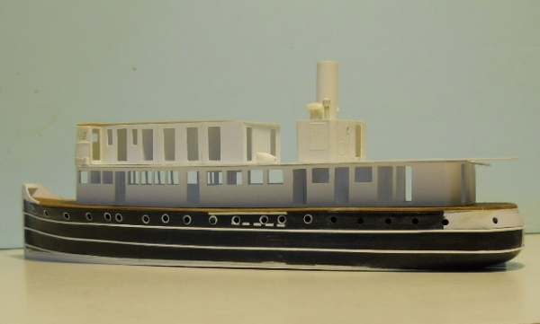

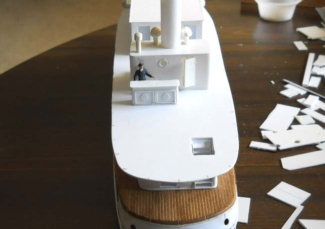

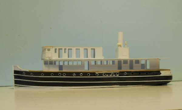

Tour Ship - Sumpter250 - 08-25-2012 In a "Weekly Photo Fun" Schraddel posted a photo of MS Diana, a Lake and Canal cruise ship http://www.the-gauge.net/forum/viewtopic.php?f=35&t=5874&p=104704#p104704 After several PM's, I've gotten to this point in building "Diana's American Cousin", as yet, unnamed. Looking at the photos, I will have to make a few modifications to the pilot house windows ( from a North Atlantic Fishing Trawler kit ), They are a bit too small. The hull is from a Revell "The Firefighter" kit ( There will be lots of neat little details left over from that kit 8-) )There will also be a lot of soldering on all the stanchions and handrails. While I've decided not to model MS Diana, I still like the overall appearance, so will follow it fairly closely. The vessel, when complete, will cruise Great Island Sound, and the lower Kennequogue River, making stops at Cindy's Harbor Seaport Village and Museum, and points of interest along the way. yeah, another "ship" project. ![]() I have to remember to keep this model under 5-1/8" tall, or it won't go under the bridge ! :o :o

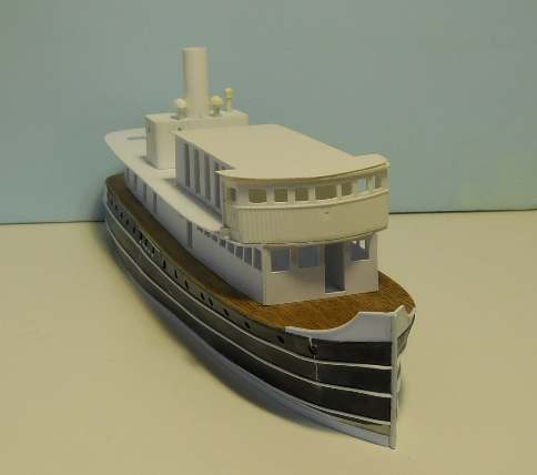

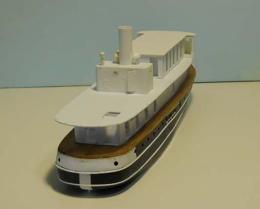

Re: Tour Ship - Harry - 08-31-2012 Diana > Ship of Sweden > Gotakanal ??? :?: Re: Tour Ship - Schraddel - 09-01-2012 Messerscharf kombiniert Harry! You are right Harry! ![]() And i think Pete will get it right with catching the overall generic look of this vessel. Lutz Re: Tour Ship - Sumpter250 - 09-01-2012 Without a really clear picture of the Bridge Deck "structures".....I used parts of the "firefighter" Kit superstructure, to build the structure around the base of the stack. It's a "best guess". I've sketched out a "probable" bar, for the area immediately aft of that structure, and will build that next. The overhead for the bridge deck cabins is a card stock piece. I'm still debating whether to build it this way, or carry it to the full width of the bridge deck. The "Trawler pilot house" works for me. It is a different "look". Because of all the windows, some interior detail will be needed, especially in the "lounge" / "diner" areas. I'm figuring a hint of furniture ( tables, chairs, etc., and curtains and drapes at least ). I also need to build interior cabin walls to block the "see through effect". At some point in the build, I will have to lay down the wood deck planks on the bridge deck. The wood railing, on the shelter deck - - ( OK, I'm retired U.S. Navy so,- - -I would call the "shelter deck" the main deck. What they call the main deck, Is the "first deck", what they call the "bridge deck", is the 0-1 level, and the overhead of the pilot house,and cabins aft of it is the 0-2 level ) - - is going to be "fun" , as the "full height stanchions" pass through it. At this point, I will probably not model the "break doors" ( Port and Starboard from the lounge bulkheads, to the hull sides ). There is one photo that shows them not installed. View of the port side; Port quarter view; Starboard quarter view; Starboard bow view; Re: Tour Ship - Tyson Rayles - 09-01-2012 Looking good Pete! Re: Tour Ship - Sumpter250 - 09-06-2012 I got a little bit more done.... All the interior bulkheads ( "Walls" ) are in, and the interior stairwell from the lounge, down to the first deck cabins, is opened. Where that can be seen through the windows, I'll build the stairs and railings, and install them. I built the ladder from the main deck aft, to the 01 level, and I need to build and attach the handrails to it before installing it permanently. The bar, is loosely based on the "portable bars" found in many hotels, that are used as "cash bars", at catered events. It can be seen in this photo, with an HO scale figure standing in as the bartender. In the lower, right of center, you can see the ladder in place. Checking the "Diana_Decksplan", this ladder seems to be the only way to get to the 01 level / bridge, Pilothouse. The crew, must come up from the first deck, to the Fo'c'sl ( Fore castle, main deck at the bow ), walk aft to the fantail, go up to the 01 level, and forward to the pilothouse. ( I guess that "keeps them in shape" :o )Re: Tour Ship - Ralph - 09-06-2012 I'm really enjoying watching this take shape. Such an elegant craft. What a nice way to tour. Re: Tour Ship - Kev1340 - 09-07-2012 You're doing an excellent job :looks the business and captures the feel of a tour ship. I shall enjoy watching your progress. Cheers, Kev Re: Tour Ship - Sumpter250 - 09-07-2012 One of the interesting things about a project like this is.. Finding the clues to the actual size of things. One of my first mistakes was thinking in terms of feet and inches. I've had to go back and change several details, because they just didn't "fit". Then, there are the details, like the stays for the funnel/stack....I finally saw a hint of them when looking for something else. Those will be added once the superstructure is permanently attached. There has to be an anchor windlass, but I have no idea what the one "Diana" had, so will have to rely on " experience, and memory " for a reasonable representation. In the end, this is a welcome departure from the " same old, same old ". and will have a place on the Seaport modules. Thanks, for the interest, and the positive comments, they add to the fun. Pete Re: Tour Ship - Schraddel - 09-07-2012 Pete! This is the only photo i found were the anchor winch is visible: ![]() Diana has only this solely anchor. The winch is one of the old fashioned traditional type with cranks and spur gear. A rather big gear is visible on the photo. The gears are partly covered upper and aft by sheets. Lateron the winch was motorized with an 90° gearhead electric motor mounted on the starboard side of the gear case. The motor is of industrial standard type and is facing backwards. Lutz |
