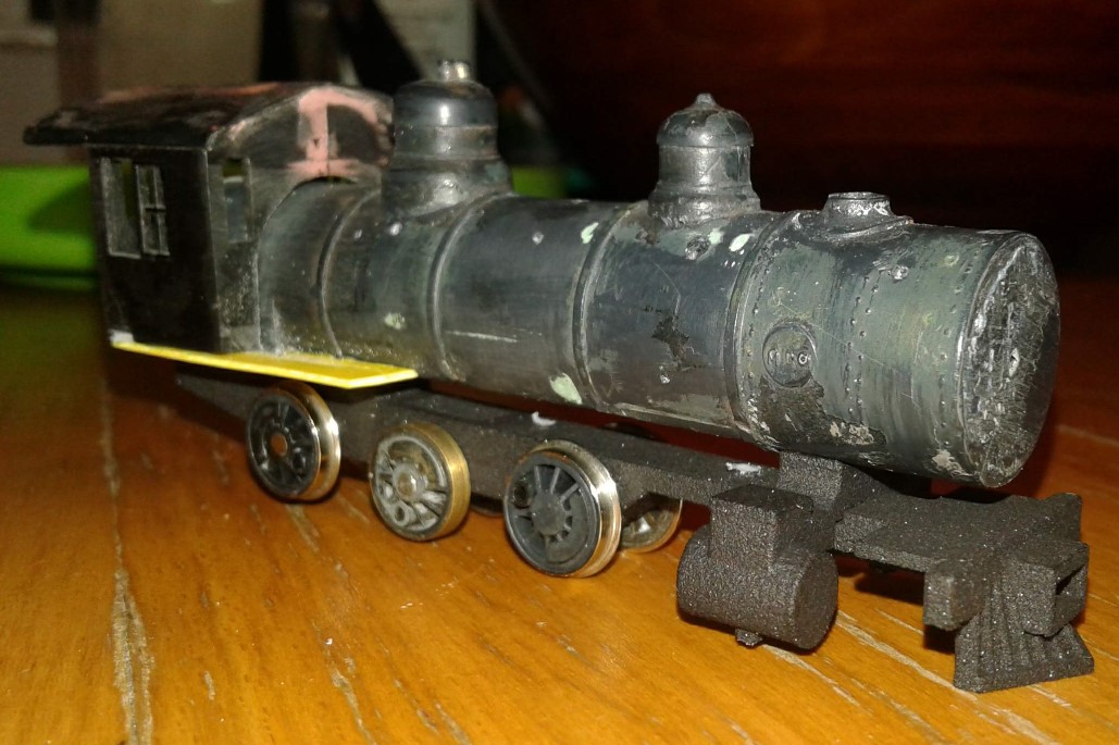

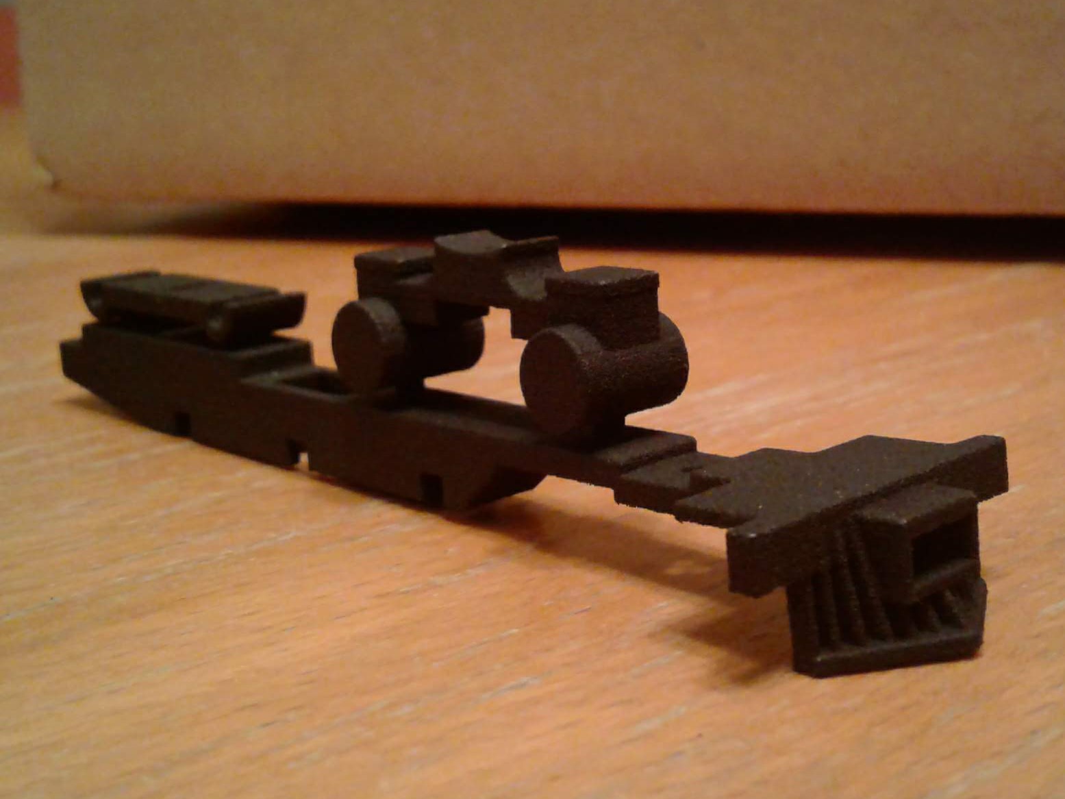

HOn3 4-6-0 build - nachoman - 10-30-2018 I had some leftover drivers from an HOn3 MDC 2-8-0, and an old MDC boiler that I had ruined the smokebox front, so I decided to try and turn it into an HON3 4-6-0. First, I designed and printed a frame through Shapeways. RE: HOn3 4-6-0 build - nachoman - 10-30-2018 The boiler had to be shortened a little to fit on the frame. I'm using the basic dimensions of an East Tennessee and Western North Carolina (ET&WNC) 4-6-0. You can see the boiler is trashed - needs a new smokebox front, new stack, and some putty and sanding. The cab is narrowed from an AHM 0-6-0. RE: HOn3 4-6-0 build - nachoman - 10-30-2018 I needed a new smokebox front and an oil bunker for the tender, so I designed and printed them thru Shapeways. |
