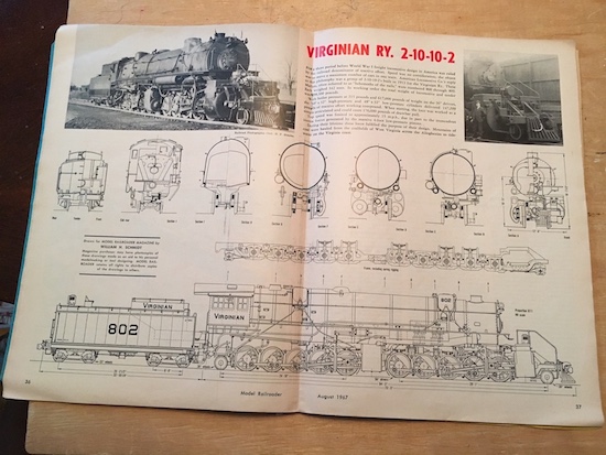

    In a Clean out and going through 1/8th of my model railroad magazine collection I came across this .
ERIE RR
#42
