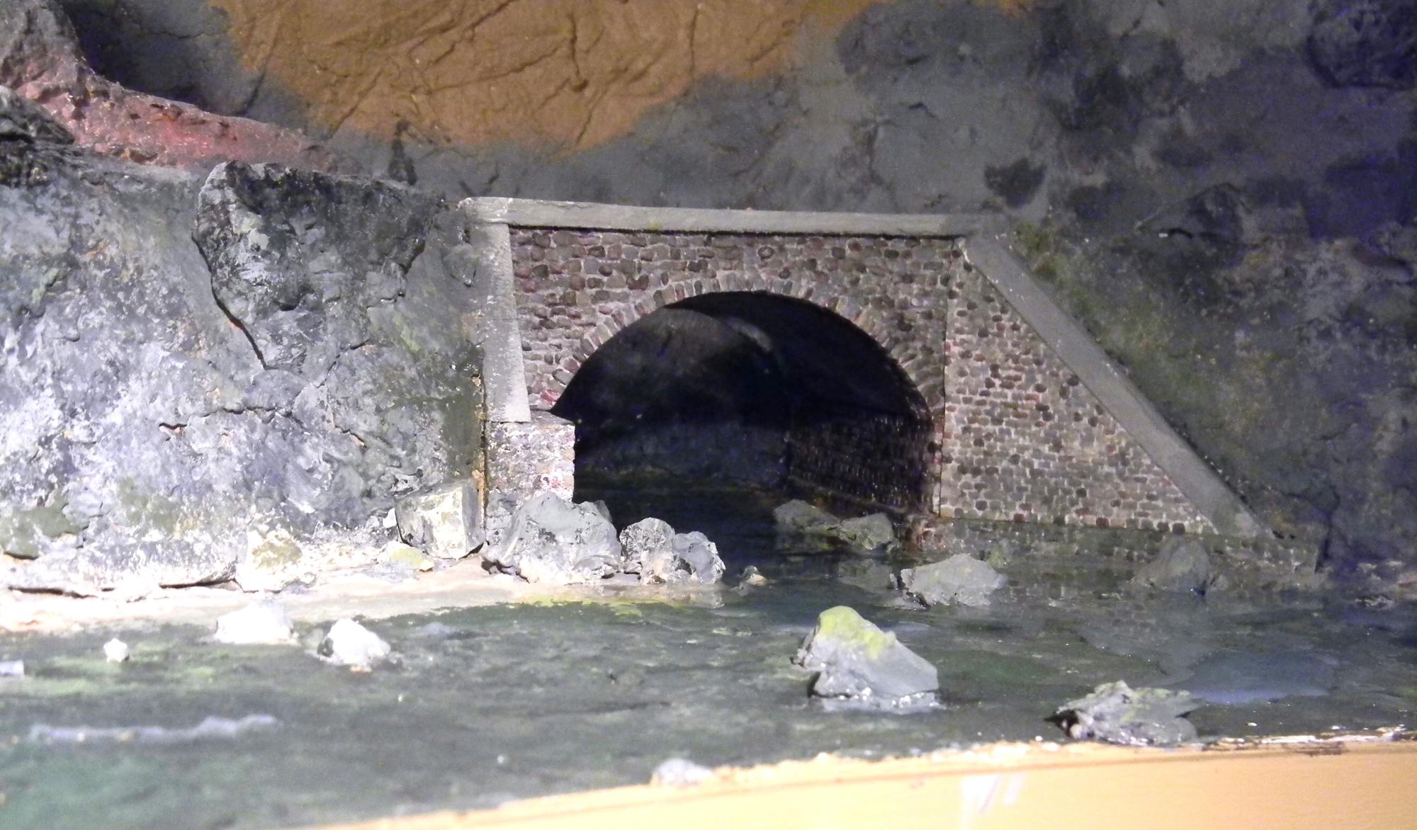

Now that I've done some last minute touchups, it's time to lay down the Realistic Water.  There are always leaks and gaps, and because I have a carpeted office, I need to take a few precautions.  The drop cloth got draped under Mud Run and I did my first pour from the backside of the bridge into the Lehigh.  I'll let this dry and harden up before deciding where the next pour will be - probably from the uphill portion of the Lehigh tomorrow.

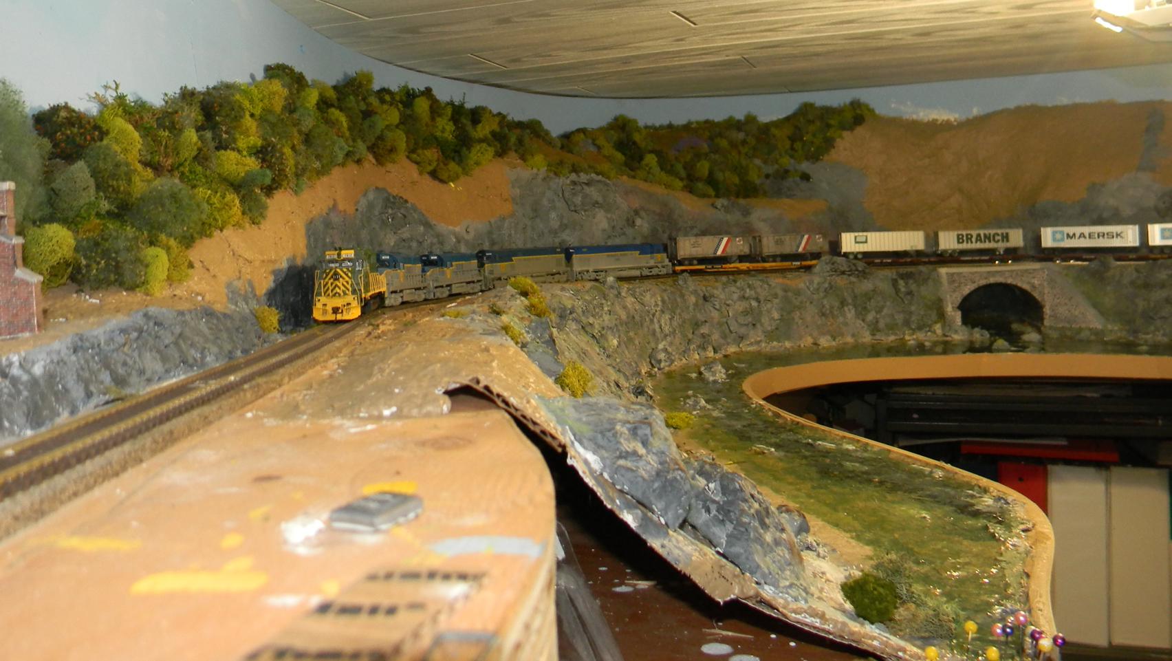

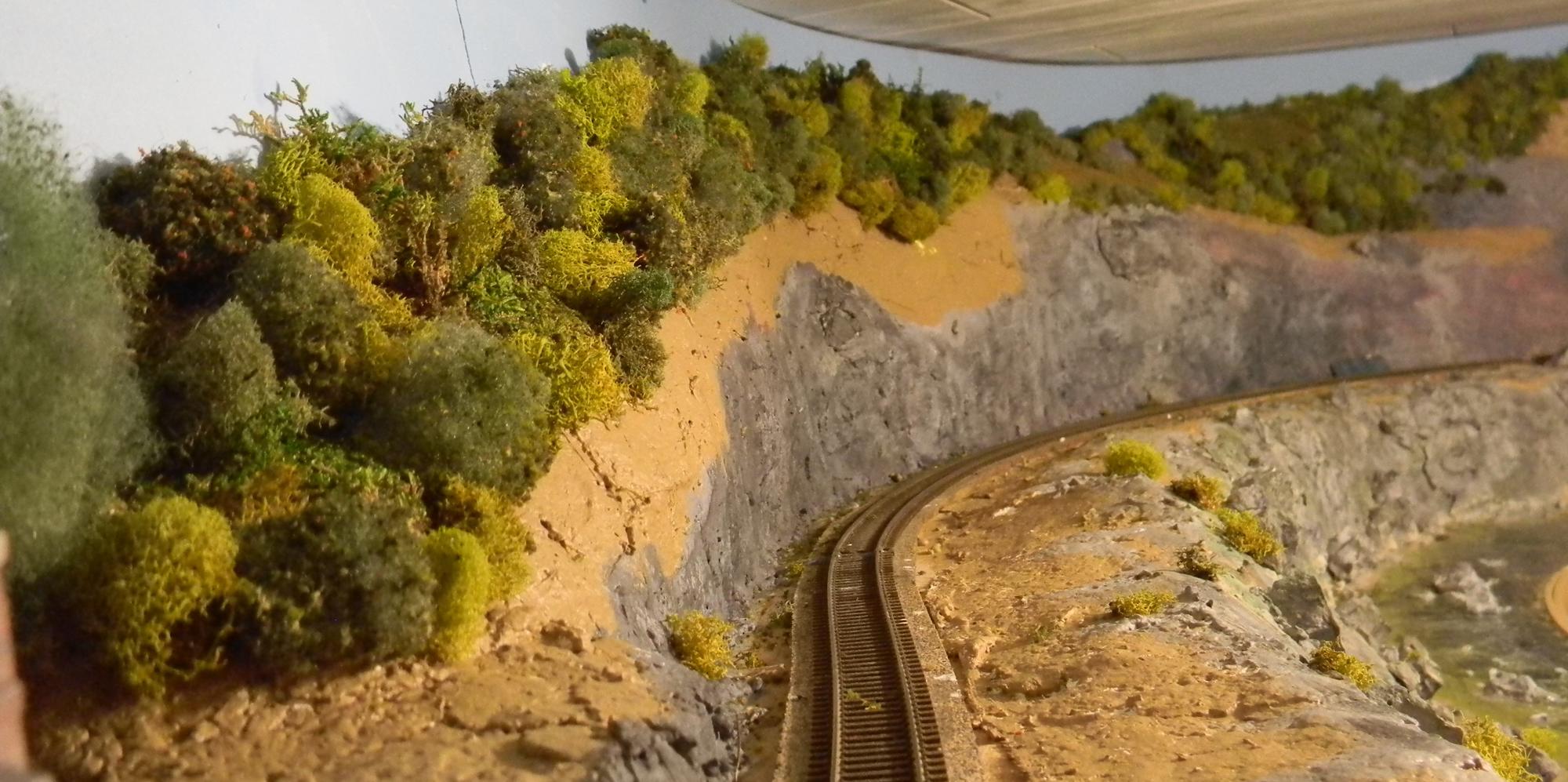

Today was the transition day - from the river to the background scenery on the upper reaches of Mud Run.  Got my favorite "puff ball" tree stuff out of my big scenery box - including puff ball trees (polyfil balled up and sprinkled with ground form), lichen, 2 different colors reindeer moss, moss sheets, Woodland Scenics clumps, etc.  Put some wood glue on a plastic lid and off we went - just filling in the upper portions of the hills.  I got a little bored of that and decided to eventually create some pasture/fields.  If I can find an N-scale farm tractor, I think that would look really good (and due to the forced perspective, probably the right size) up on those fields.
Plan for the rest of the week after work is to continue this effort all the way around to the tunnel entrance.

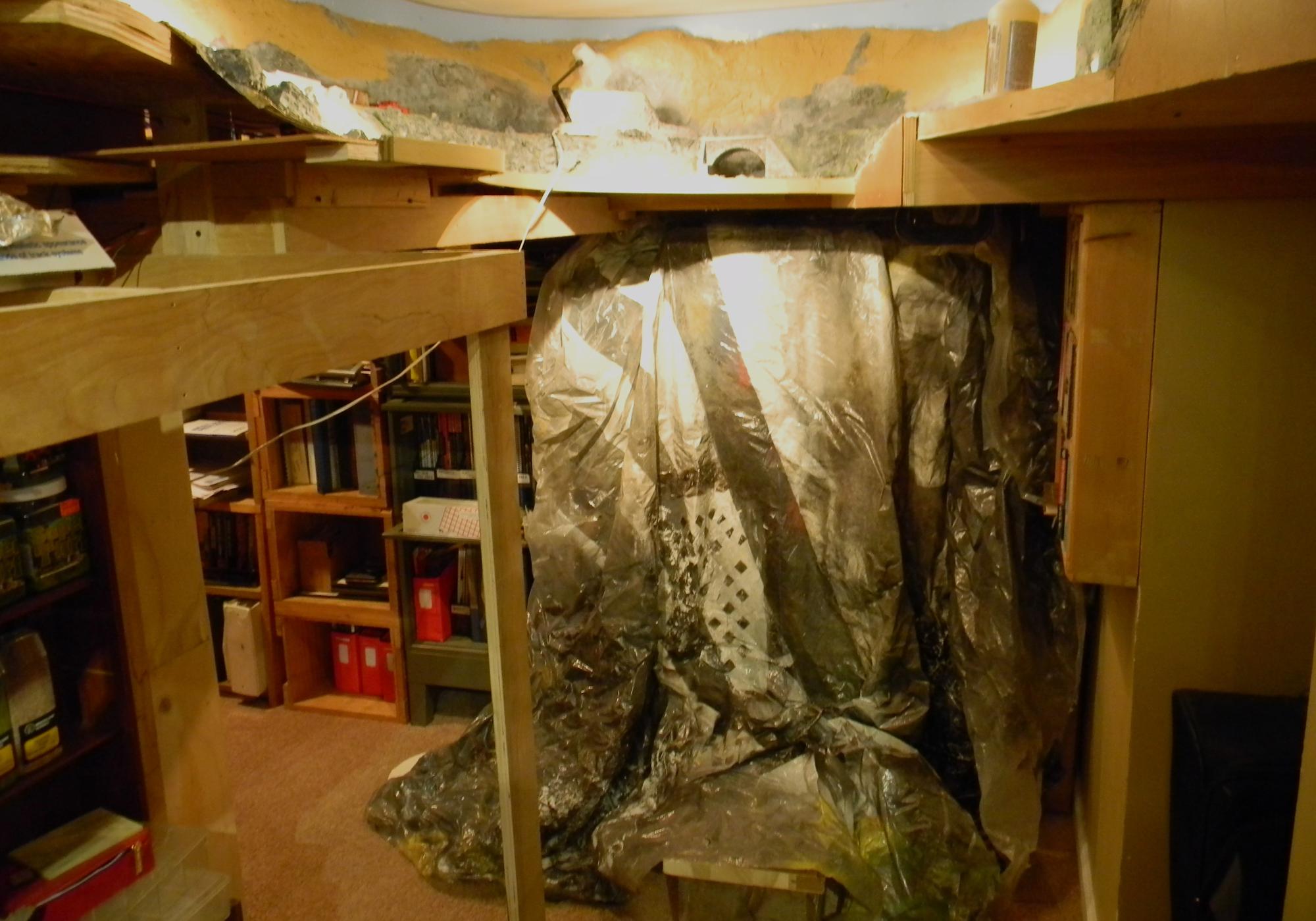

Had the spark of an idea last night before laying my head on the pillow.  My current lighting of Mud Run is from an overhead light which provides lots of light, but not into the area behind my bridge - everything's in shadow back there.  As you can see in the picture below (the real Mud Run bridge), there is substantial light behind the bridge which can highlight some of my scenery that (eventually) will be back there.

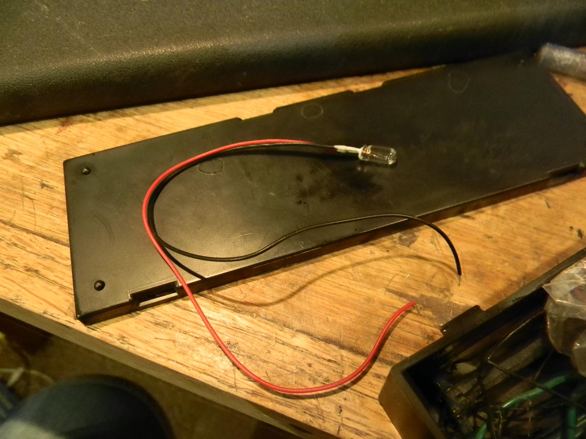

I'd bought some incandescent bulbs a few years ago with the intention of having some replacements for loco headlights.  Thought I was getting small LEDs (would have helped if I read the description closer) and opened the package to find 25 of these "large" incandescents.
Decided to save them for something - and now I have a something.  As a trial, I wired one of these directly to my bus bar from my DCC booster.  Way too bright and I have to add some resistance tomorrow to dim the bulb and keep it from burning out too quickly.  However, took a couple of shots to see how it looks.
I'll pick up some resistors and a switch (I want to option to turn the light on and off) tomorrow and play around with how much light I want back there.

I might suggest that you can add a potentiometer in addition to a current limiting resistor to allow you to vary the brightness. You can get one with a switch as well. Although, I have a couple of 5 amp variable supplies (3-12 VDC) with off switch and digital readout that I use for all my interior lighting. Some are incandescent, some LED. Very cheap supply, around $15 at Amazon and amazingly small for a five amp supply.
Power supply
I had a bunch of 12 volt incandescent bulbs that I'm running out of, also have an old LED flashlight with over two dozen white LED's that I removed the LED's and added wires and a current limit resistor to. Got the flashlight for free from Harbor Freight, it's just a bit tricky soldering to those very short leads, but hey, free is good, just need to remember polarity. Icon_e_surprised
