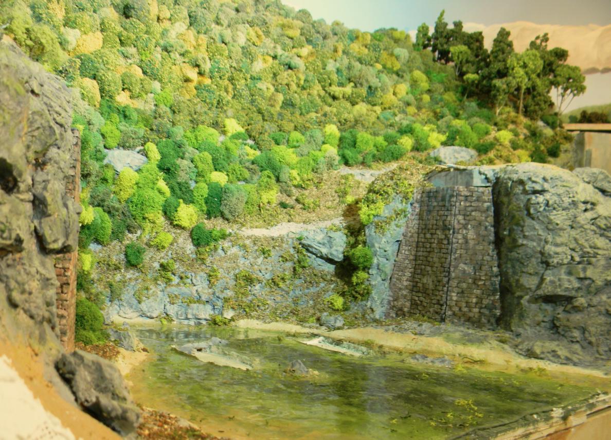

Piece by piece, there's a little more progress each day here. A little different view of the scenery back behind the bridge looking toward I-80 in the upper right. I've taken down my highway bridge sections to give myself some additional elbow room.

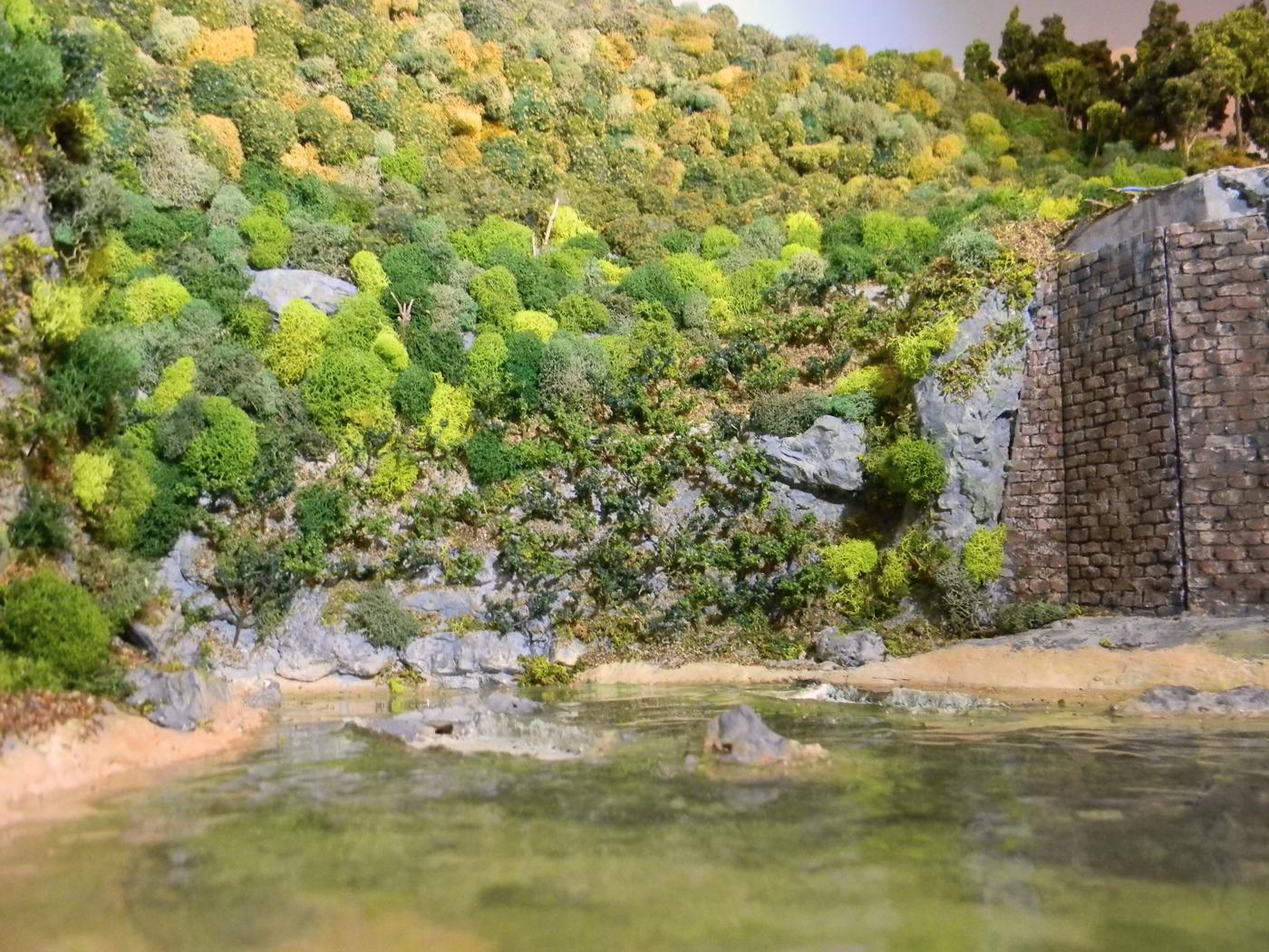

I've spent what little time I had available this weekend to putting in shrubs in the foreground areas - same technique I used in Mud Run for simulated Mountain Laurel and Rhododendron. What I'm going for is depth in an area of the layout that is nearly vertical, but that's a good interpretation of the terrain in the gorge - it's quite steep in a lot of places, rocky and pretty wild.

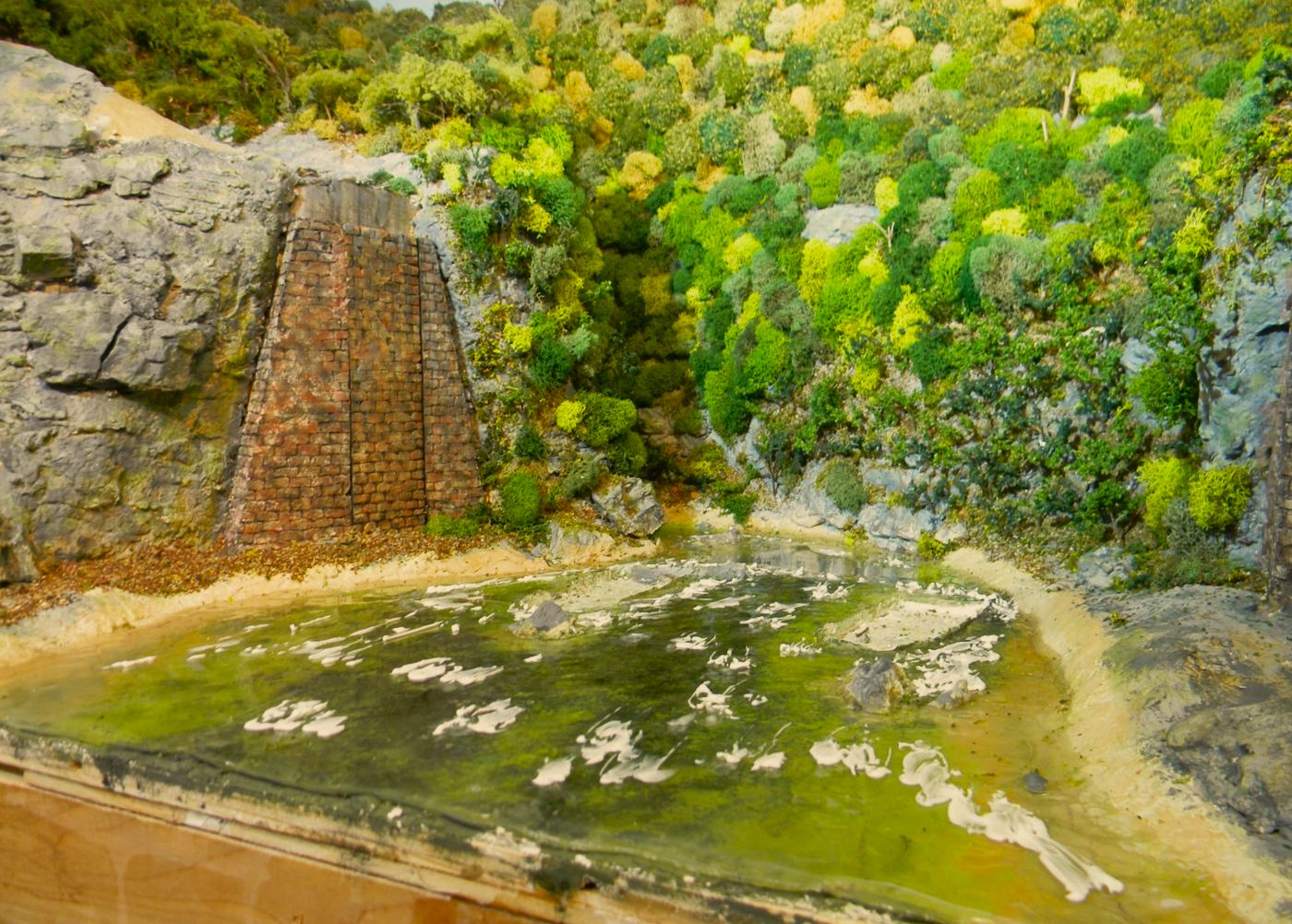

Got my bottle of Woodland Scenics Water Effects out and added some rough water (2nd application) around the rocks in the river. Once this dries (clear) I'll get the white paint out and add some rapids, especially after where the piers will go. At this point I'm trying not to jar any of the scenery and shake some leaves onto the surface of the river, so I'll let things dry over night before getting the paintbrushes out.

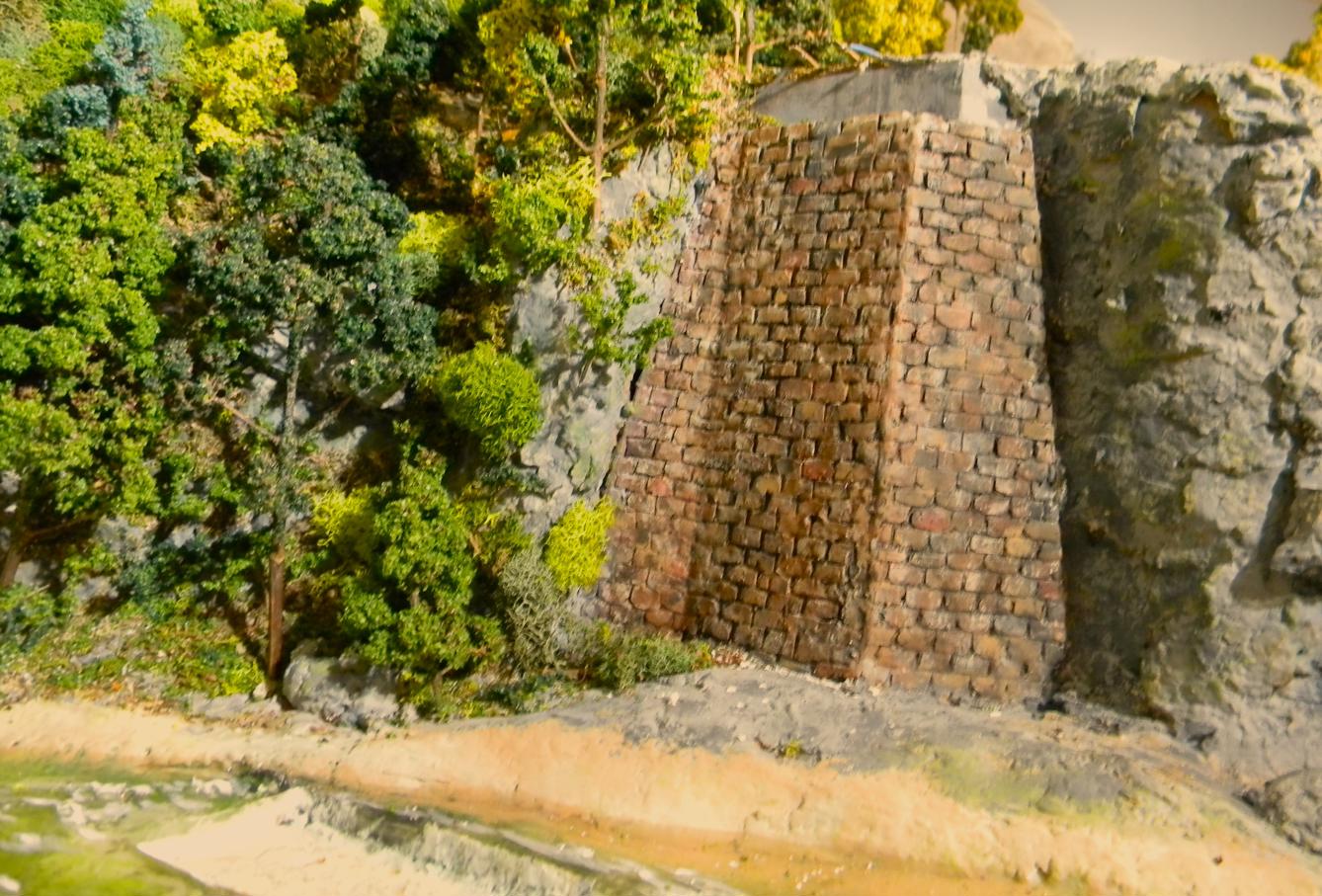

Wasn't happy with the seams of the bridge abutments (it's three different pieces of Styrofoam glued together. If you were building it with blocks, you wouldn't have the gaps. So, got the spackle out and then got a ball point pen to re-score the seams between the individual blocks. It means I'll have to get the paints out again (black over the spackle first, then all of the other colors in the stone), but it's better to get it right now before the piers and bridge go in there. I wanted to weather the abutments anyway, so it's just going to mean a few more days before I can run trains over this bridge.

More baby steps. Paint was applied over the last 24 hours. black first to get into the deeper sections of the foam and then a collage of browns, reds and grays. Happier without the discernable gap between sections of the the abutments. Next some weathering (both piers and abutments) before remounting the bridge.

A rolling stone grows no moss, but a stationary one attached to a bridge pier and built near or in a river? There will be moss.
I made some basic assumptions - the southern abutment (north facing) would have the most moss, and the northern abutment would then have the least amount of moss. The closer you are to the water's surface, the more moss would grow.
First step was to get about 6 shades of green out of the paint box - if you ever look at moss closely, you'll note that there is a ton of variety in terms of color. My technique is to apply alternating dark and light shades with an almost dry brush. If you put too much of one color on, dabble and mute that area with an alternate shade.
Here's the result:
I was going to start putting the paints away, but my eye kept straying to the piers. There was something that just wasn't jiving with nature. About 10-12 scale feet above the water level, the moss stopped. It was a very jarring transition, and I didn't like the result. However, I didn't want to add it all of the way up the pier, and I decided to experiment with a brush that was almost completely devoid of paint, brushing across the upper sections of each pier and adding just a hint of each green color. If I made a mistake and added too much paint, I got the block colors out and faded out the green. This might be hard to present in a photograph (the difference is subtle, but definitley more pleasing to the naked eye here in the room), but here's the end product (in terms of paint).
