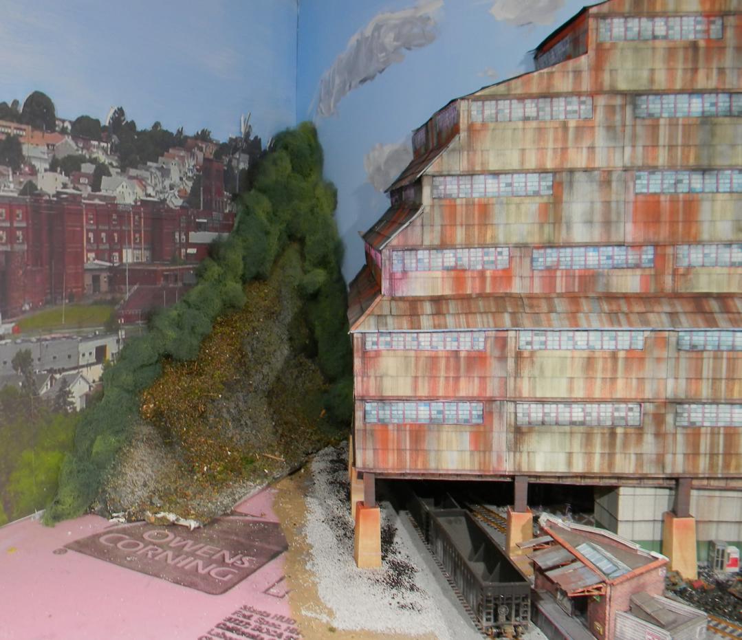

I've also been exploring adding various colorations of ballast to use on my coal tailing pile.  On the spray painted (black) Sculptamold, I started with a layer of very black ballast applied on top of Titebond glue and added some layers of medium gray applied on top of some 3M spray adhesive.  After it was dry I scraped off some of the gray to reveal some of the black.  Not sure I'm sold on the look yet, but it's a start - I wanted a rough and tumble non-uniform pile of refuse, but it might just be a little too motley.  I need to look at some prototypical piles - the internet's great for that....
#47
Problem solved.  Took a look at a lot of photos and by my viewing, just about anything goes with a coal tailings pile.  Some are pitch black, other are more like rubble, some have quite a mix.  Some have trees and shrubs taking up major portions.  Anything goes!
I did like a darker look, and my medium gray ballast was still a little too gray.  The solution was to apply a dusting of black spray paint over the previously applied ballast.  I then hit it all with spray glue and sprinkled on a couple colors of turf and brought out my big jar of mixed green/brown stuff.  It's currently drying, and I may decide to pull some of that off or to add to it.  I think that's a big thing in scenery building - you have to be willing to take a dare and add another layer to what you already have and be brave enough to pull out the paint and the glue.

Great input, Jim, and you're right, I did see some reds (with smoke and ash) and also some orange wash entering streams from the tailings piles I've seen. I do know that the Lackawanna River used to run bright orange at times from leaching heavy metals from the piles and from pumping out of the deeper portions of the mines near Scranton and Wilkes Barre. I do have some orange course turf that I could use in spots, and I'll give that a whirl tonight as I add more scenic detail to the pull-out module.
#53
Spray adhesive, black painted polyfil, couple colors of green spray paint, touchups, slap some more green/brown stuff at the interface between the tailings pile and the brush above it.  All told, about 15 minutes of work.  It's rough and needs some tweaking (tomorrow after it's dry), but it's gonna work back there in the that corner, and I didn't have to do anything precarious to get any of it into place.  It also fits in well enough with the backdrop.  The transition at ground level is something I'll work on when I get a much better idea of where structures and roads will be sighted.

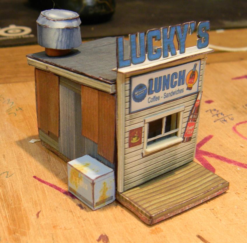

I was working on the portable coal conveyor that came with the Coal Dealer kit, but the instructions on that thing are scant - although they do provide some excellent pictures of their O-scale model which is exquisite.  Trouble is, the HO scale unit is 55% smaller.  I scrapped my initial attempt and decided to move on for now and attack Lucky's Lunch Counter.  I got the four walls and floor support structure together.  Now comes the roof and signage, which is a bit trickier...

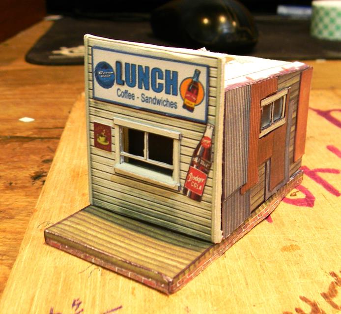

Nonetheless, I did finish up "Lucky's Lunch Counter" last night adding the roof details and reinforcing the base.
