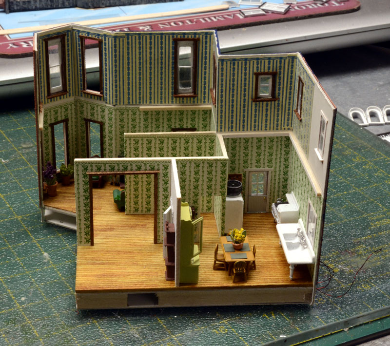

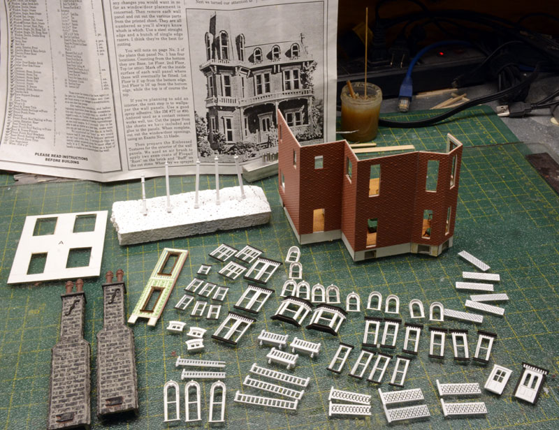

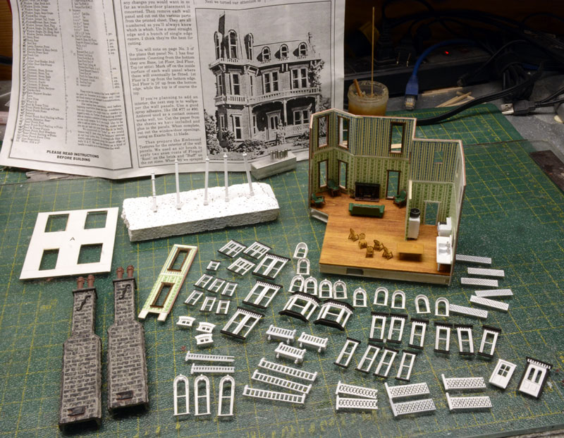

Anyways here are some photos showing some of the progress that I have made so far.
You can see what this house will eventually look like in the B&W photo shown on the instructions.
The kit includes some printed on paper brick sheeting, which I switched out for some styrene brickwalls which are then glued onto cardstock wall panels.

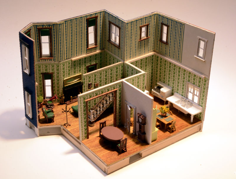

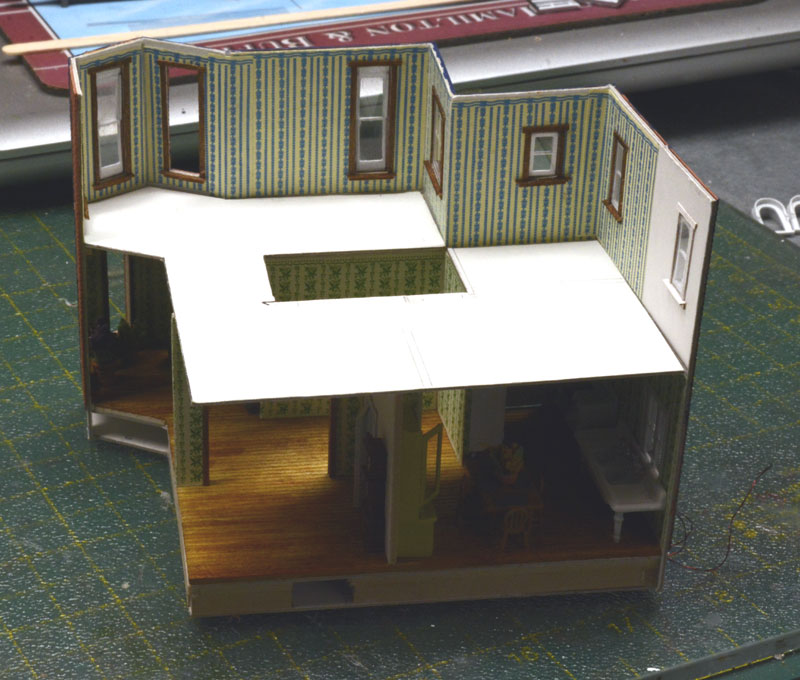

Here's a couple of pics showing more interior walls added and more interior details.

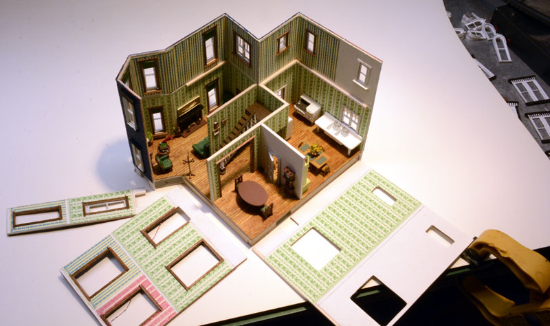

The second floor and remaining exterior walls will be added once I have all of the first floor details in place.
I will run the magnet wires for the lighting between the cardstock floor and the wooden scribed floor that I will be laying on to of the cardstock floor.
The wires will run over to the far exterior wall out through a hole and down the hollow cast chimney on that wall.
Most of the details on the first floor are now done, I'm just starting to now install the lighting for the first floor.
The second floor will show a bathroom & bedroom above where the kitchen & dining room are.
The exterior wall on the side where these rooms are located will be the wall that is removable.

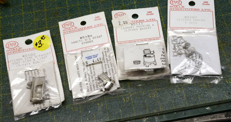

Wow! Awesome work. How did you locate all of the interior furnishings? Interiors are one thing that I've completely ignored on all of my structures, but if I ever get a lot of free time.... Thanks for sharing and your granddaughter's getting a great house!
That is so impressive, those details make all the difference, and period yet. Where did you find them?
TMo & Don, thanks very much for your kind words!
These details are still available from SS Ltd. on-line retailers.
Also at some hobby shops that carry them.
They have all kinds of different details, not just furniture.
They come in little packs that look like these shown below.
Greg

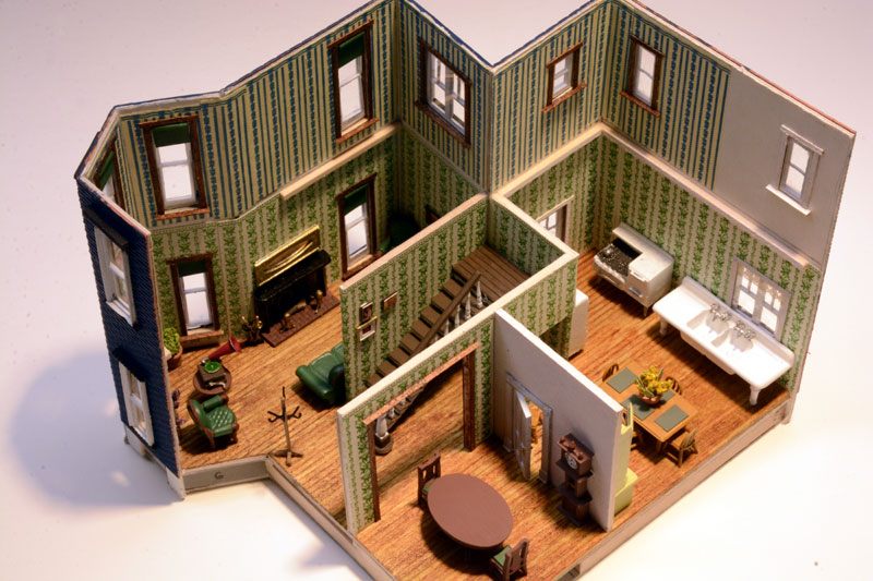

Hi everyone, well I have managed to get the LED lighting installed on the first floor.
The magnet wires that use to power my LED's are like hair, so that allowed me to sandwich them between my 2 floor layers.
I then ran the wires over to a exterior wall and out through some holes that I drilled into it.
I then glued the second layer of scribed wood on top of the first layer of floor and wires.
These wires will get covered by a chimney on that outside wall.
So here's what the lighting for the first floor came out looking.
