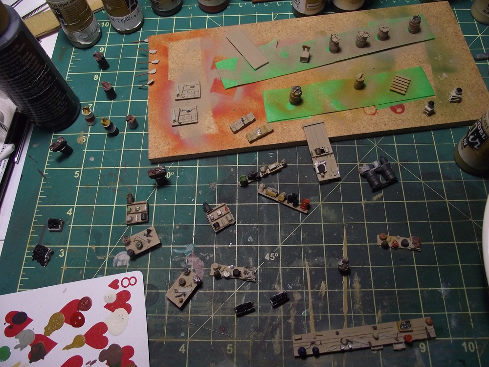

Thank you. I started painting the detail casting today. Mostly just the junk pieces:
I painted them with a dark rust, then oversprayed with lighter rust and grimey black. I might respray with the lighter rust as they look a bit darker than I would have liked.

Glen how are all those details held on there for painting?
~Amanda
#65
The secret weapon other wise known as masking tape looped with the sticky side out.

Slowly driving myself crazy:
Lots of detail painting requires lots of patience.

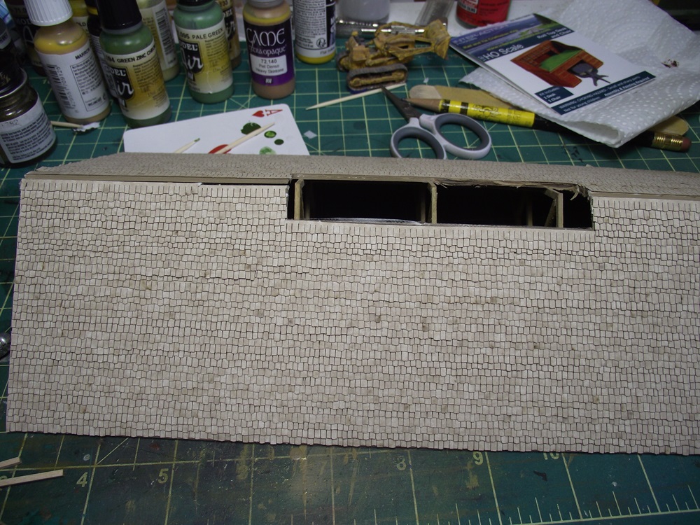

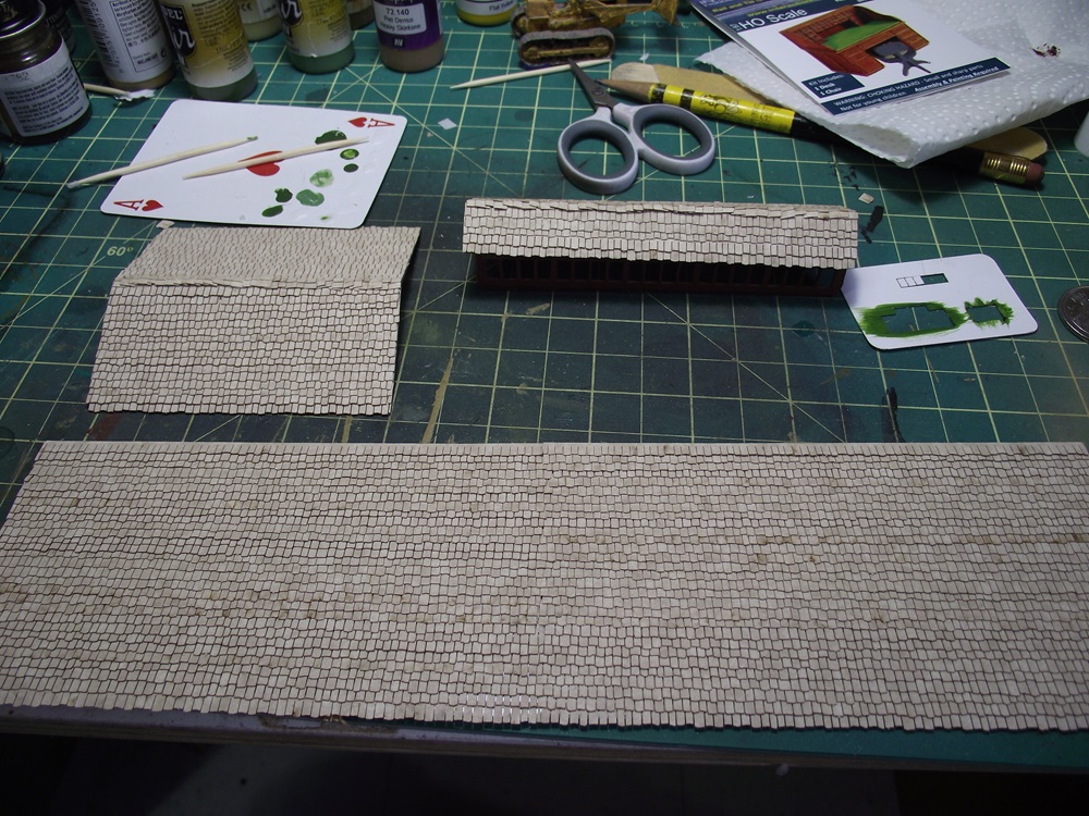

I got my shingles!
My Friend Darryl at Interaction Hobbies made me up 7 sheets of his shingles. He uses these in his kits but made me these up as a favor.
I drew guide lines onto the roofs.
Then I carefully cut the small tabs that hold the shingle strips into the sheets until I have a decent pile.
I use Scotch double sided tape to stick the shingles down. I know others use white glue but I perfer the neatness of the tape. after a couple hours the tape becomes permenet. I have other projects that I built almost 10 years ago ans the shingles are still down.
Starting at the bottom of the roof I lay down a strip of tape, then start to lay down the shingles.
It's a bit tedious but I moved my operation to the computer desk so I have a podcast running at the same time to keep my mind busy. This was about an hours work. I still have the other side of the main roof, the office roof and the car shed to complete.
#72
You have very beneficent friends! I need a friend like Darryl!
I guess these simulate cedar shakes? Interested in what you're going to do to finish these... Cedar is a hearty red/orange/tan with a good bit of variation on a new roof but after a few years weathers to gray.

I mostly finished off the shingles today:
I shingled the office roof, Clestory, and the car shop roof. The peak is a bit tricky but managable.
I also finished shingling the main roof but need to do a bit more work before finishing the peak, There tuned out to be a gap in the center of the peak but some 6X6 Ho Basswood strip filled it perfectly. I'll finish the peak and then continue on
#74
Yeah, Glen, I used to install cedar shakes as a volunteer for the Millbrook Village Historical Association. Did 3 barns and a cooper's shop. The typical way to finish a shake roof is to cut the edges clean on one side and have the other side's shakes extend above the crest and over the first side's shingles. You then run a line across at about 2 inches of exposure above the peak and cut off each shake. It'd be tough to make that work with yours, and the basswood's gonna look a whole lot better.
