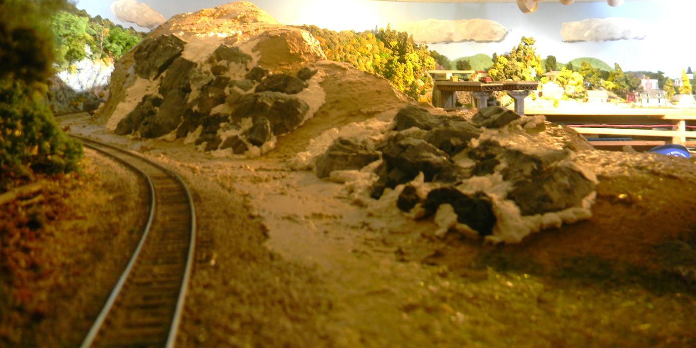

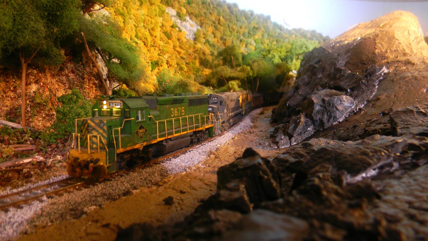

Here's what I've been working toward in this section of the layout - an impression that you're inside the gorge, with feeling that civilization and the horizon is a long way away.  Obviously a lot more scenery to add, but I'm feeling better about walling out this section of the layout from the normal viewing angles.  As the coal train shows, it's going to become a great place for a photo op.

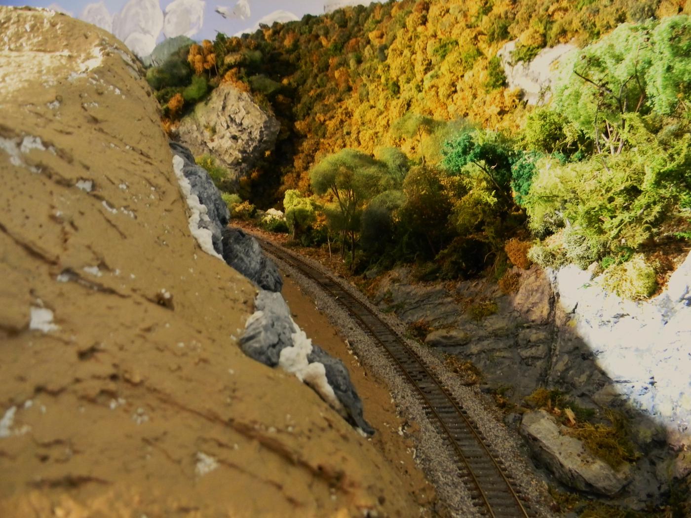

Rock and roll....  Put a big dent in my 1/2-gallon container of Plaster of Paris to make more rocks in my molds, but we're getting closer to the bridge.  This may look like rock overkill, and it is - there are going to be quite a few layers of scenery that go on top of this - a lot of brown and green, but until I get all of the rocks in place, we're going to table the other layers.

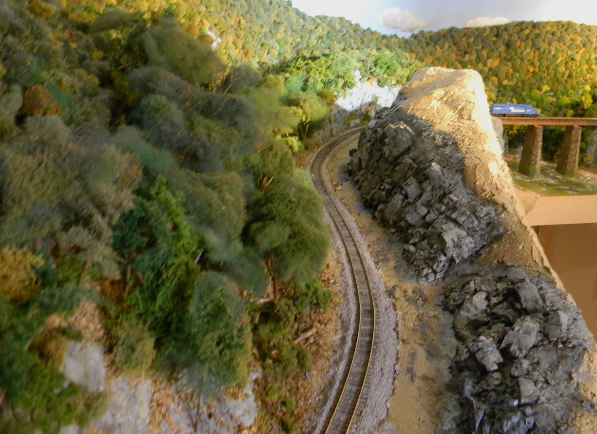

Here's a shot from the bridge end of this section showing the approach of rocks - still several to mount before we move on to some other scenic details.  With the hot spell we're getting this week, I think I'll be down in the basement after work much more often than normal.
The slow progress toward the bridge continues with the rock face additions.  I'm ready for some detail painting now that all of the cast rocks are in place.  Most of the detail painting will have to be done via mirror from above, so I that should be fun...
