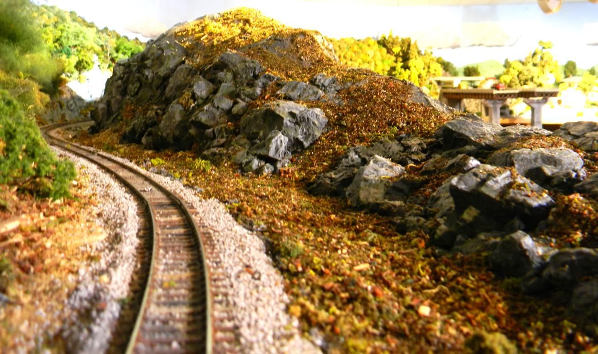

Done with paint brushes on the rocks.  First dump of "green and brown stuff" (leftover ground foam, sawdust, coffee grounds, sweepings, etc.) went down over a coating of wood glue - I'll be vacuuming up the extra after the glue dries and seeing if I need to apply another coat.

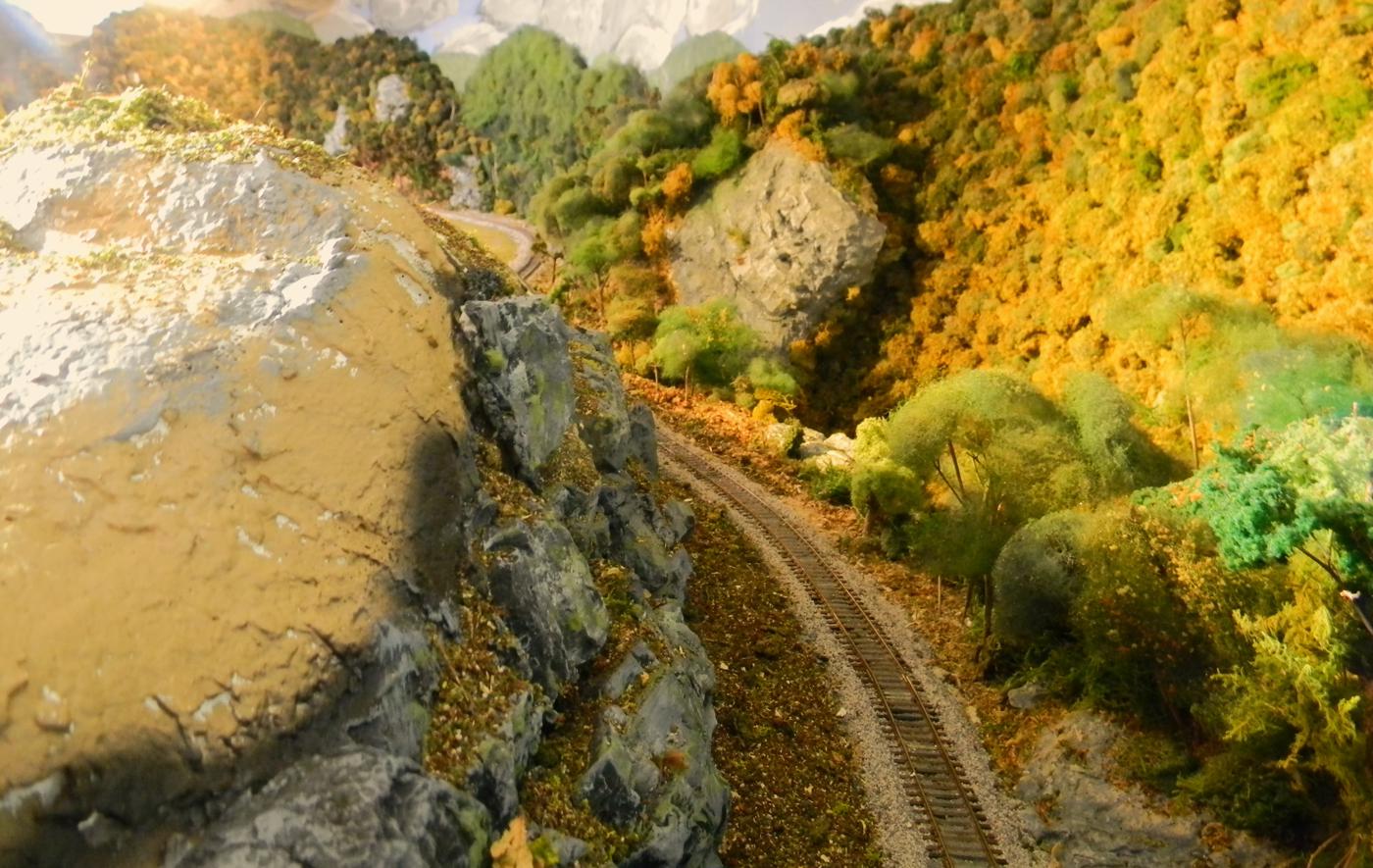

Making some additional headway into the tricky portion of this project, a lot of it done with mirrors to see what I'm doing as I suspend myself over the mountaintop to add glue into crevices and near the track to apply the brown and green stuff.  The first layer went down with nothing more than a coat of straight wood glue followed by the vaccum and then dressed again to get the coating I liked.  Followed that up with a dribble of alcohol with a syringe and then a 50/50 mix of white glue and water (just like you'd do track ballast) over the new added material.  When the green and brown stuff dries, I might add some areas of static grass on top as an experiment.  They come shrubs, and finally trees. Here's a shot from the bridge end of the project.

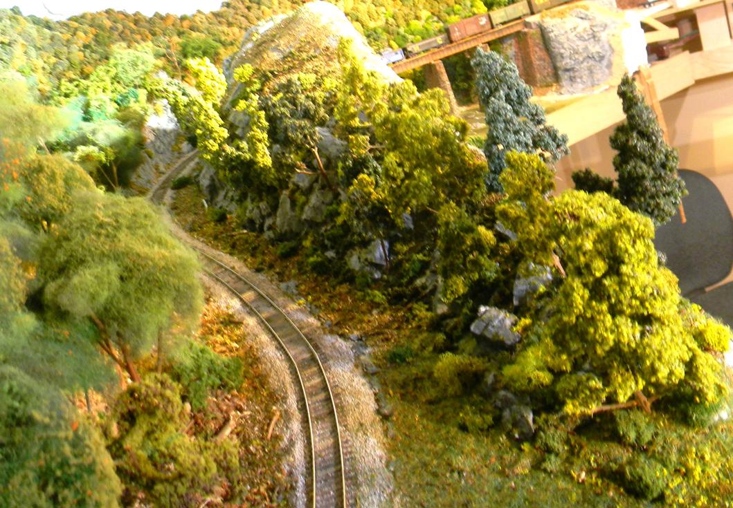

Made it all the way to the bridge planting shubberies upside down with a mirror.  Nice parlor trick, but I'm glad that's mostly over.  I'll run some trains through there to aid in identifying potential snags (you can see one glaring example in the photo on the inside of the track).  Due to the nature of the effort, I think I'm going to go right to trees in the same space to avoid having to reach over shrubbery on the top of the hill and plant those as well while there's less stuff to interfere with.
