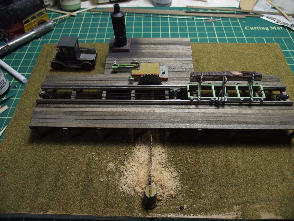

I've spent the last week building the internal machinery. Starting with the saw husk:
and the steam engine
and finally the log carriage
The carriage was the most challenging with the wire handles and linkages. The log is a pruning from some bush in a friend's back yard. I need to find out what it is, I could use some more.
With all the machenery done, it's time to install it. I started with the Husk. The plans give the right location but you have to cut a slot in the mill floor to clear the saw blade. the engine comes next, lining up the drive pulley on the engine with the pulley on the husk.
Next will be the carriage.
Love the carriage. That's gonna look great on the rails of the mill.
Thank you.

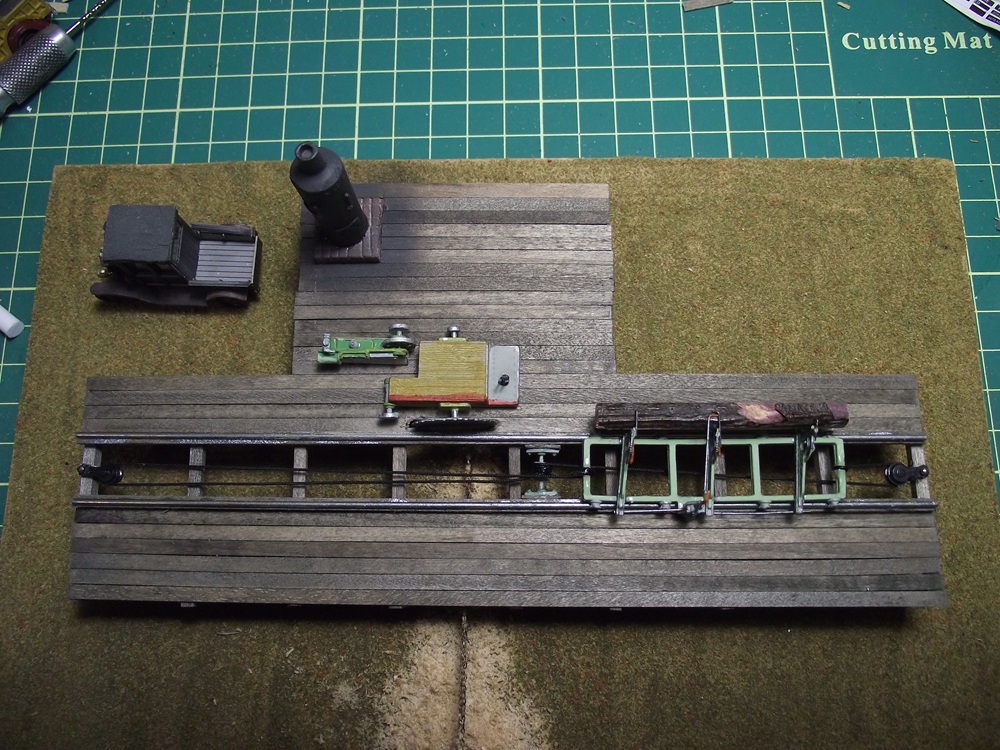

Now it's starting to look like somehing:
I added the log carriage and the cable to the mill.
the cable (thread) goes around the cable drum three times, then through the pulleys on each side then endine one each end on the carriage itself. there was a fair amount of tweezer work the use of CA glue in this operation.
