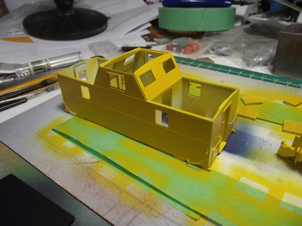

I airbrushed the color one the caboose parts.
I used a yellow from Tru-color part. it sprayed very well and the colverage was excellent.

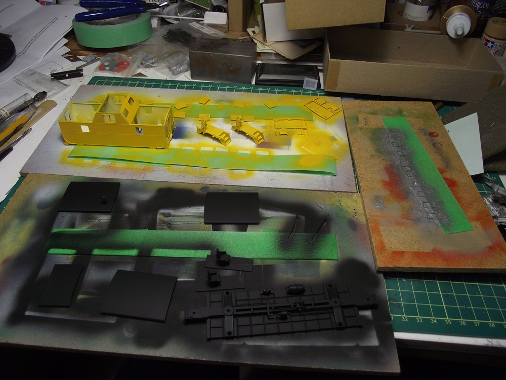

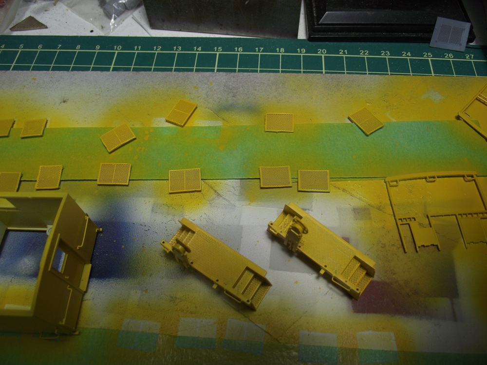

The end platforms and the window screens are also painted yellow.
The roof parts and underframe were painted black, and the window frames are aluminum.
