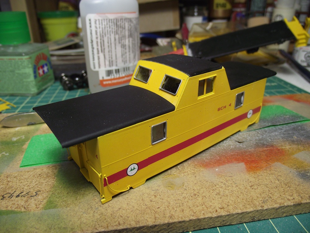

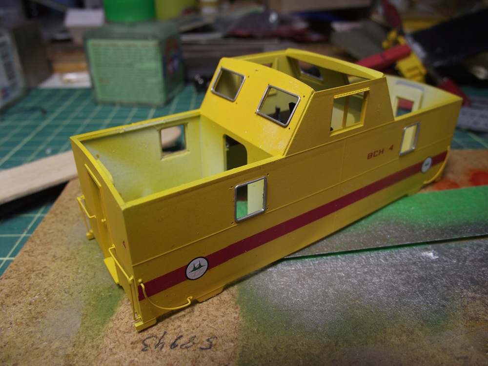

I started with assembly:
I installed the window frames on the front and rear windows on the cupola and the four windows on the sides. I was a bit concerned that the paint might have made the openings too small but they fit well.
After that I added the window glass. This too fit very well. The glass is laser cut and the body has resesses engineered into the inside of the wall. I added the roofs and this is where I ran into a bit of trouble. The cupola roof is supposed to be a tight fit, snapping into place. Instead I ended up cracking the body. They was repainred and you can't see where it cracked. I ended up sanding the roof down and glueing it in.
