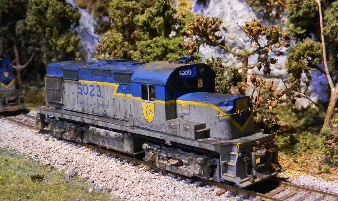

Well, the stage 1 weathering began tonight, and I began with 5023. Key things for me to hit with black were all of the intakes, the walkways, trucks, undercarriage... Prototypical for these units in 1976-77. I've seen some pictures where the locomotive is incredibly grimy - looks like it took a bath in coal dust. After the intakes I work a very soft dry brush in vertical strokes from top to bottom, making sure I hit seems, hinge plates, door handles. I'll do a similar treatment on 5018 and the C628 which now has it's windshield wipers.
The shot below is the equivalent of a before stage 1 (5018), and an after (5023).

RS-36 5023.... Went with it pretty clean above the deck.

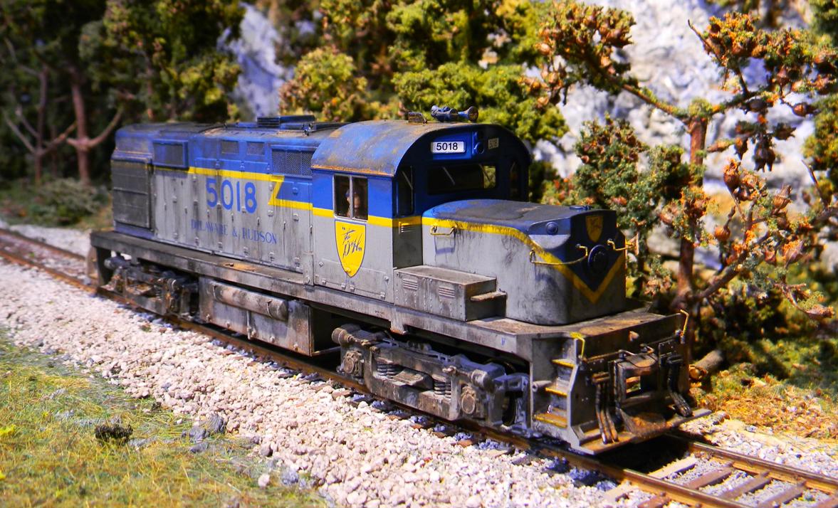

RS-36 5018.... This one is sickly dirty and I actually like it the best.

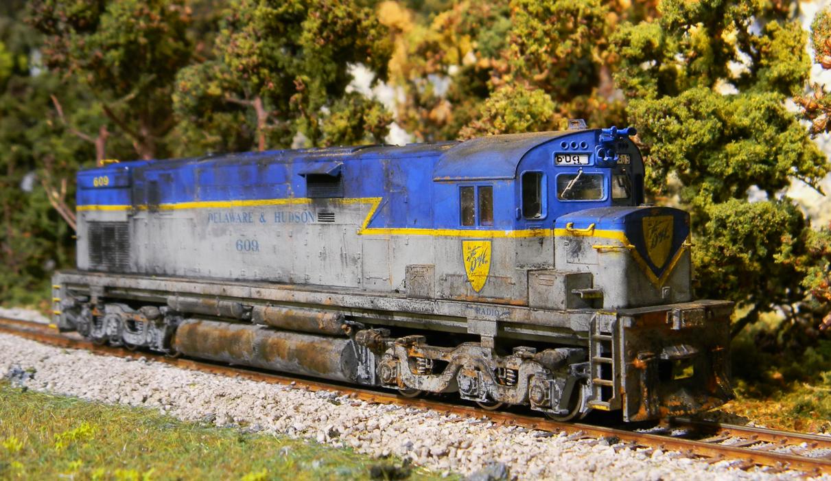

C628 609.... Rushed this one a bit and I probably will alter it's look when I get back to it.

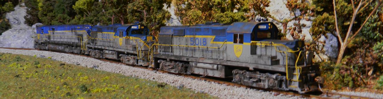

I finally finished installing the painted handrails on all three units, but they also need to be weathered. I also had to retouch some gray paint on the fuel tank of the C628 (hence the bright patches on it). Here's a shot of all three before dulling and decrepitalizing... which shouldn't take me too long to do. I still need to rust up and install the couplers as well, but we're certainly in the home stretch on this project (thank goodness....)

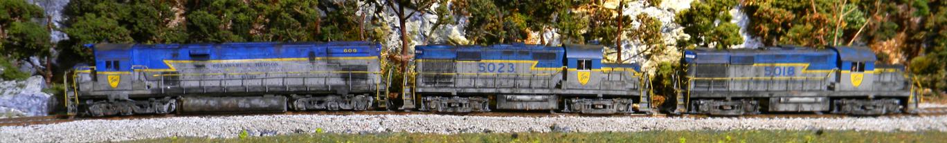

Finished toning down the handrails and installed couplers - with washes again. No PanPastel treatment on any of these, I don't think they need any additional attention. Ran into a intermittent connection on 5018 - it has a different decoder motherboard setup and I was getting poor performance out of the old girl until I opened her back up and resecured decoder, board and wiring - I now think she should run well again. Here's two shots of the completed work - I think I'm ready to consist these to the rest of the D&H power and run some TOFC... Speaking of that - all of the trailers and flatcars also need to be weathered.... There's always more work to be done!
