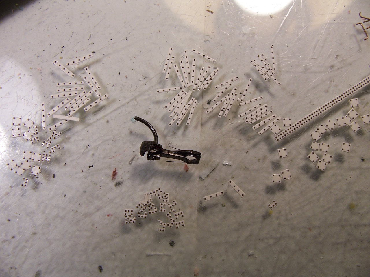

The project struggles on, and I finally got the undecorated cars painted, along with the re-worked underframes of the older ones.  No photos, but last night (until about 5:00 AM) I applied some more details (shown below) to all of the 8 cars that I have on hand.
These three-dimensional decals, from Micro Mark, have been cut to fit various places on the ends of the hopper cars (the Kadee coupler is there only to impart a sense of scale)...
Note the ones at the bottom, cut to fit into the cars' poling pockets.
The ones from Archer are a little easier to use, but didn't have the rivet patterns required.  The MicroMark ones don't respond all that well to Solvaset, so I usually do at least two applications of that setting solution, and once those have dried, use a small brush to apply MEK to each decal - the key to not destroying the decal (removing the rivets) is to make a very light and rapid pass with the brush.  Even if there's a little too much MEK on the brush, it's less likely to remove the rivets than if the brush is moved back-and-forth over the decal, even once.
