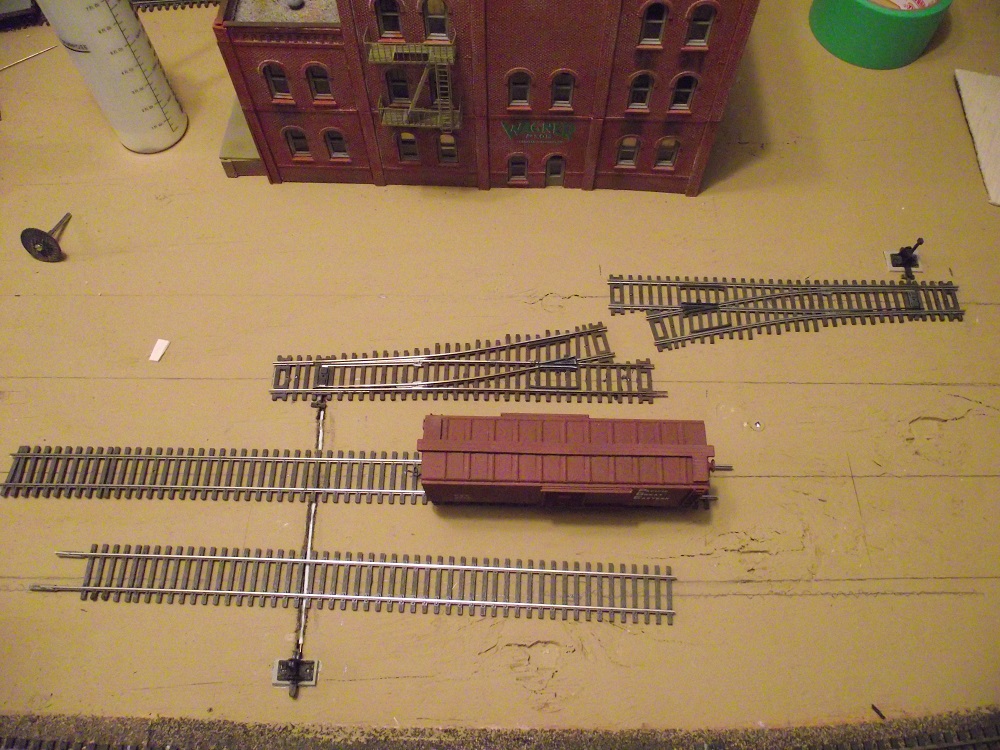

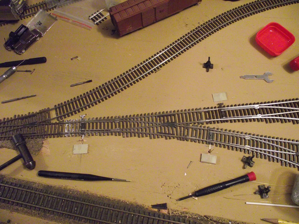

Thanks Tom. It wasn't too difficult, I just had to make sure the brass rod was stiff enough to move the turnout points without bending.
All the turnouts have been set up with the caboose throws.
I used some 3/32 styrene tubing that the brass rod slipped through easily without being too loose. The styrene is glued with epoxy so it stays put and locks everything in place. When the glue dries I'll use some drywall filler to fill the grove that I routered in the plywood.
I had to repeat the rod and styrene tube for three other turnouts. Either because the throw was on the wrong side, or non existent.  I made 'concrete' pads for the caboose throws out of some basswood.
