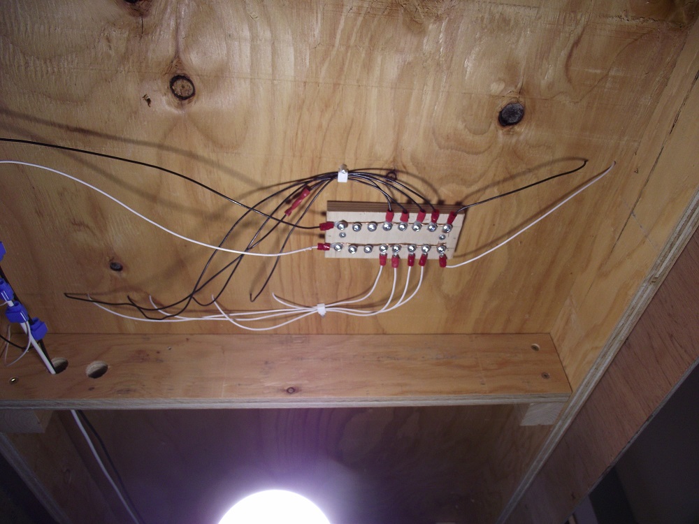

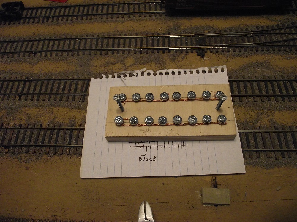

I made a small home-made terminal block at work so I could attach all the feeders from the yard to it and then connect it to the main layout bus. Just in case there could be a short in the future, this will probably make it easier to track down. It also makes the wiring a bit neater.
and the yard wired up. I had a few other feeders that I fed directly into the bus, but they were fairly far away from the terminal bus. As I wired each feeder in, I was checking with my NCE system for shorts by turning the DCC system on and running an engine over each section.
