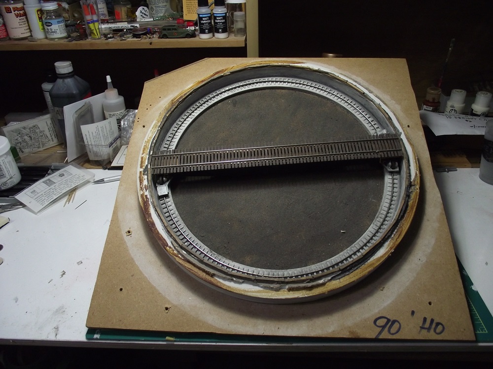

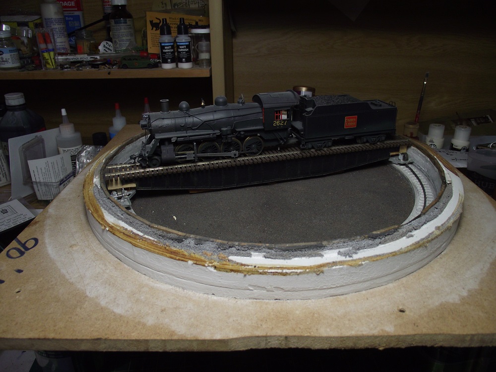

My used Diamond Scale turntable. It was orginally on the same layout that I got the Hemsley Diorama and the Large trestle that I built into the free-mo module. I paid the exorbant fee of 15$ and it is complete with drive.
However the listing mentioned that the motor ran but the turntable did not move. I bought it anyway and have kept it in storage until now.

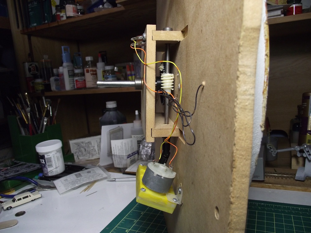

The drive is a smallish electric motor with a gear reduction box, coupled to a driveshaft and worm gear that runs a larger gear on the turntable shaft. I assumed that the was either a damaged gear or something was slipping on a shaft.
Well with no oblious signs of damage, the only thing to do was to hook it up to a dc power supply and test it out and it ran just fine. I ran it in both directions for about 15 minutes and it never skipped a beat.
So that was a big relief. I thought I was going to have to tear it down to replace parts (If I could get them) but now it's just figuring out the electrical hook up to the turntable tracks and installation.
