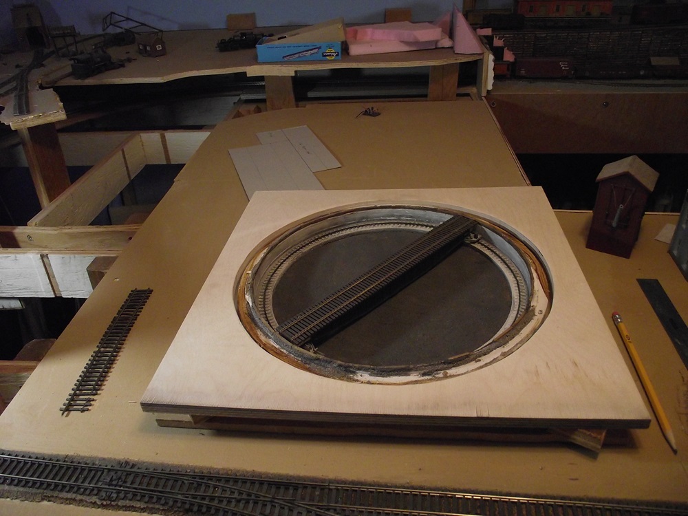

Before I gave it to him:
I did some measurments to figure out the shims that I need to level it with the top of the layout. The previous owner did a few modifications to the orginal design including using Micro Engineering bridge track. That made the turntable bridge a bit taller so he increased the height of the pit. When I took all those thing into account, I needing to put 3/4" spacers between the turntable bottom and the layout bottom.
I quick check with my test adapter and the height looks right. When I get the turntable back I'll be able to install it and start filling in the gaps with some foam.

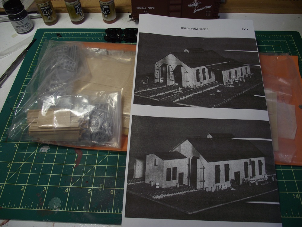

This is the enginehouse/car shed that I'll be using. This will be part two of the big winter project.
