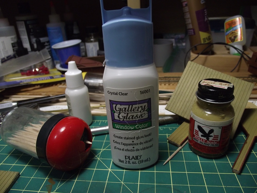

Then I could finally put the window glass in. I used a product called Gallery Glass:
A liquid that was made for stained glass and suncatcher hobbyists I just applied it to the indiviual panes and let it dry. I believe Goerge Sielios uses this product on his builds.
I did have an accident on the first window that I did. Some of the 'glass' got onto the front of the frames so I'll have to be creative and fix it.
