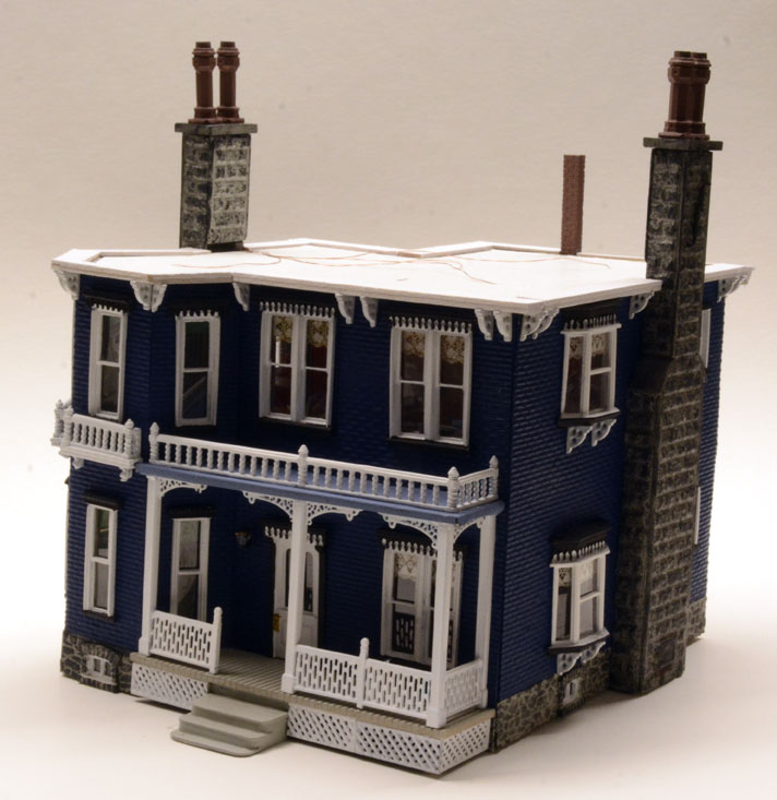

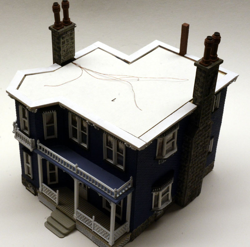

Hi everyone, well I have managed to get a little more done with this house model.
I finished the lighting on the second floor, and ran the wires above the ceiling over to the chimney again.
Now that I had all of the lights & wires in place I could now glue in place the second chimney that will hide these wires.

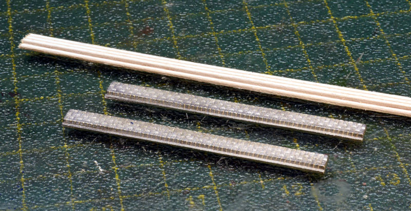

I worked on the eaves for the house next.
The kit includes metal castings for this, however they have bricks cast into them which I found strange.
So using some 2 layers of scribed stripwood glued together I made up my own eaves into the same profile as the cast metal ones.
Once I had those eaves in place I then added the decorative cast metal eave brackets under and around the newly installed eaves.
I also glued into place the smaller chimney at the rear of the house for the stove in the kitchen.
I'm now finally ready to start the mansard roof for this house.
That's all I have for now, thanks for having a look!
