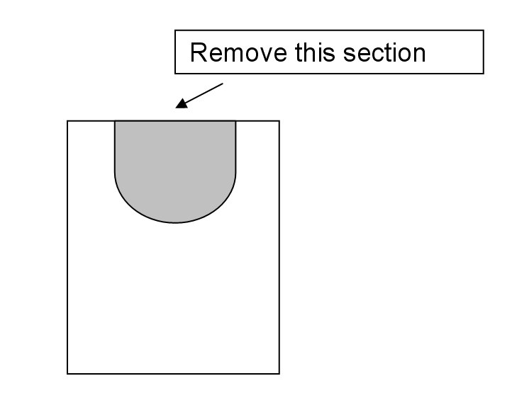

shortliner Wrote:Plastic from a real plastic bag,( a single layer) about the size of those brown paper bags, with a U-shape out of one narrow end to leave the handles each side. and a squiggle of paint on it would make those carrier bags that the supermarkjets use, that you see decorrating bushes and fences. ....
Jack, I did not get the idea how to do the handles. Could you add two more sentences about that topic please.

I think what Jack meant is this:
I'm sure he will correct me if I have misunderstood :-)

Most of those plastic grocery bags are pretty much torn up and such after blowing around in the wind I think small bits of plastic torn off of a grocery bag wadded up and glued to the scene will suffice to simulate the grocery bags. You won't generally find new pristine bags laying around on the ground.

Steve got it in one - - you can do it as a square -bottomed U shape to leave a handle at each side - some narrow strips torn off raggedly and crumpled up will look good draped on fences where they have blown in the wind and ripped apart. If you have pallets stacked around, take a small piece of duct tape, and get rid of as much of the "sticky" as you can, then slice it into VERY narrow strips and either bundle it or leave it as a loose strip - it makes a good simulation of the plastic or metal banding remove when unloading goods from the pallets

Ok, thanks a lot. I do understand now your suggestion how to make grocery bags. Next step is to explain my fingers and eyes what to do...
