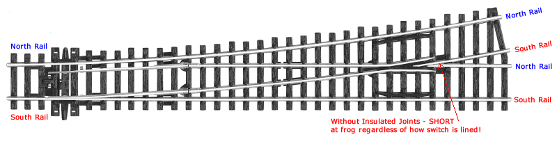

I have a question about cutting a gap into the rail, Will a metal wheel connect the rail on each side of the gap and cause a short?

To answer your question about wheels causing a short as they cross the gap, the answer is no, unless you had metal wheels and axles that weren't insulated. Of course in that case, you'd have shorts every where.
The purpose of the gap or insulated joints is only to prevent a short in the frog that would result from power coming from the diverging track.
Probably better diagrams on the 'Net, but looking at this you can see where the short occurs without preventing the diverging routes from powering the rails. Believe me - just putting insulated joints or gaps in the two rails shown in the other diagram works just fine.

Only if you run into a turnouts that is lined towards the other leg of the turnout - the one you are not going to take. If the turnout is lined for the path you will be taking, the frog will be at the same polarity as the rail on the track you are about to enter from. The gaps or insulated joiners are there to prevent shorts on the path the turnout is not lined for.
And of course, if the turnout is lined the other way, you are likely to derail anyways - which may or may not cause a short :-)

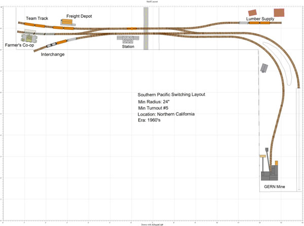

It looks like I am not going to be able to work on the layout for a few months due to the leaking on the layout.
I have been thinking that I could remove the part of the layout that is being leaked on, and build a layout just using the two HCDs that are across one of my walls.
Or I could just remain patient and just build freight-car and structure kits until summer comes.

Justinmiller171 Wrote:It looks like I am not going to be able to work on the layout for a few months due to the leaking on the layout.
Or I could just remain patient and just build freight-car and structure kits until summer comes. Justin;
Which part of your current plan was not effected by the water leak?
![Filename: Layout.jpg
Today, 08:56 AM](attachment.php?aid=7018)
If it's the upper portion of the plan, couldn't you just go ahead and work on that and allow for adding the wing at the right once you get the leak problem fixed?
Of course using the time to work on your freight car fleet or build some structures would put your time to good use too, but being able to actually do some switching on whatever part of the bench work you can use would probably keep your interest peaked.
