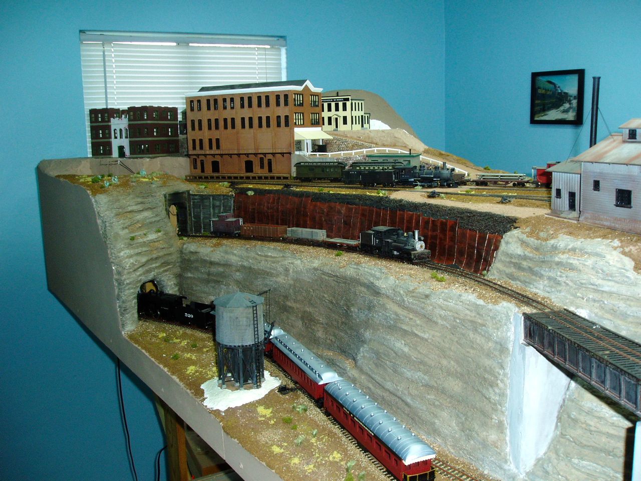

Here's an overview of one end of my layout. This is where I have been doing the most work the past few months.
While I don't have a specific prototype, I am trying to re-create the look of southeastern Arizona and towns like Bisbee and Tombstone. Scenery wise, I've been mostly happy with the way things have come out. I'm still trying to adjust colors or vegetation, and have recently put a tan wash on my rockwork to blend the rock colors better with the overlying ground cover. I've taken two business trips to the area this month, and each time I paid close attention to the vegetation and colors and thought about what my layout needs.

Thanks for the updated layout photo! I like that scene a lot and imagine it is a focal point as trains pop out of those tunnels on two levels. Great looking locos too! Thumbsup
Wow, that's a lot of vertical scenery! Looks great!

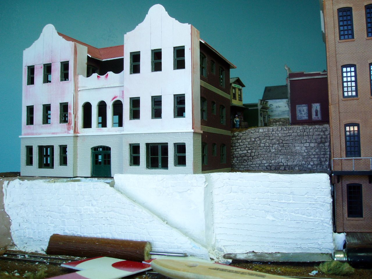

I've been busy with other projects, and just am now getting back into working on model railroad activities. Here's an area I started for the last challenge, way back when. It's the last scenery "hole" in my town scene. The hotel is kitbashed from a couple of Model Power kits, and is being bashed into something more of a
"mission revival" style. Still lots of work to do here, but at least it's progress!
Progress for sure, Kevin, and your take on "mission revival" looks good to me. Thumbsup Thumbsup
I'm wondering, though, where you managed to find those delicious Tree-Trunk-on-a-Stick treats: I thought they went the way of the Twinkie years ago. Wink Misngth
My deepest respect. You demonstrate how to do all the windows opening in a correct manner. Looks very good Thumbsup
Wayne - that's actually a tool I made for carving the rock walls. It's just a sharpened nail shoved into the end of a tree branch. It actually does not work that well, but for some reason I keep using it.
I've finally got this rock wall mostly done after much pain and effort. It is plaster smoothed over a foam form and then the rock were carved in it. This is actually a bad idea. The plaster did not stick to the foam all that well. and I kept chipping it off as I was trying to carve. Additionally, leaning over the layout to carve the rocks was a pain. In hindsight, I should have just bought rock walls, or cast and carved these things out of solid plaster on the workbench.
I'm mostly happy with the result, though. I really want to get scenery over this last corner of my layout. I need to finally finish up this hotel!
Good looking wall Kevin. Thumbsup
