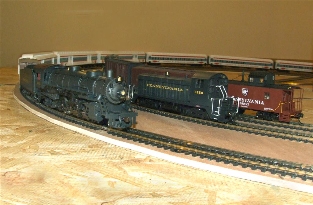

I got the first loop of the main line layed good enough to try a train

It needs some tweaking but I think it is pretty good. I had several spots that had some dips that had to be fixed. that served to remind me why we lay track first because they were sure easy to fix.
I debated doing some of the scenery first but I just had to have a train running.

The second main track is laid and ready for some tweaking. I ran a couple trains around with no derailments so I feel pretty lucky.
Here is a picture at the curve at the summit where there will be 4 tracks to the mainline when I'm done.
I have decided to finish the track laying before I do any scenery. I think it is easier to fix the track without the scenery in the way.
