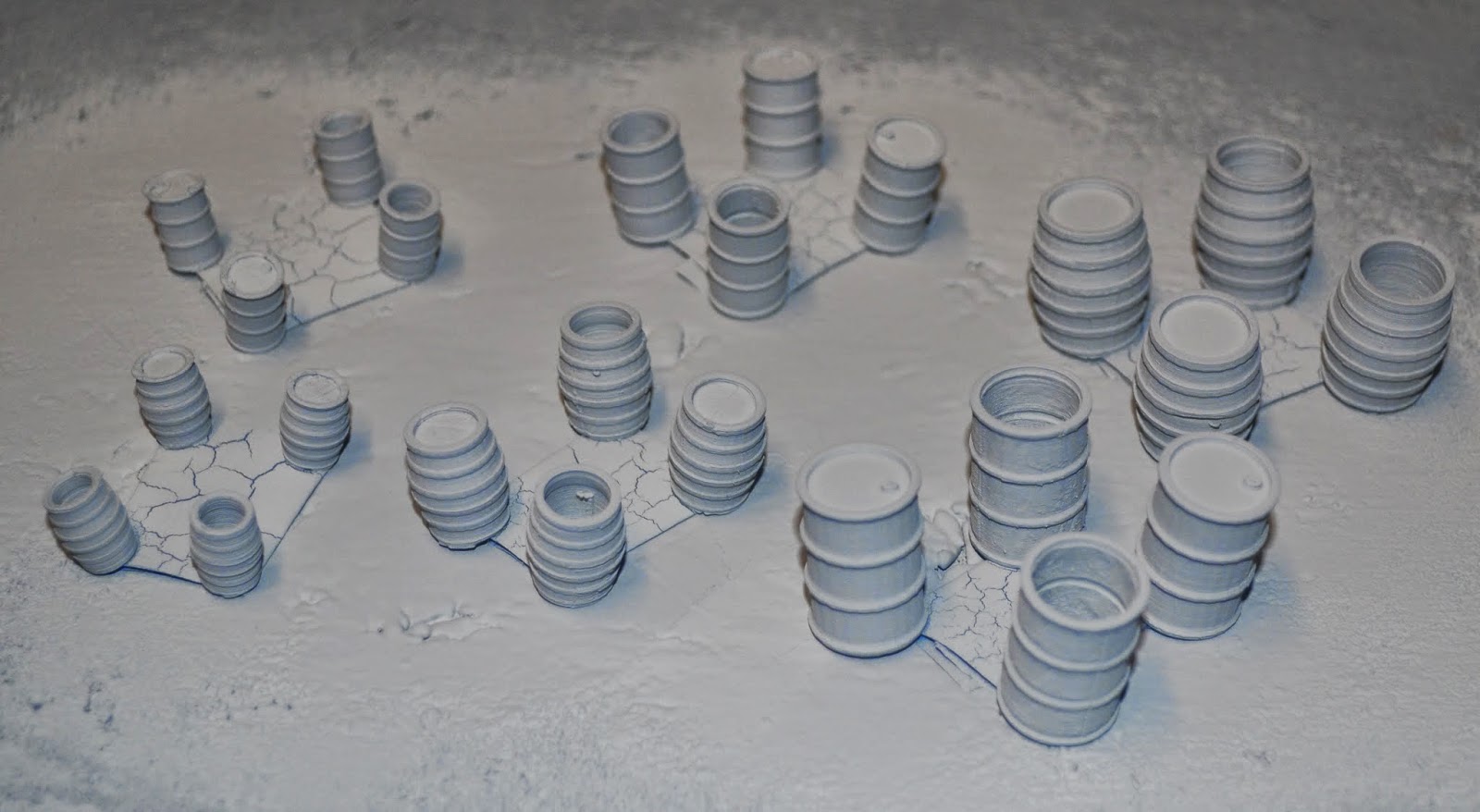

Barrels of Fun in HO, S and O scale
[Image: DSC_0003.JPG]
Finished pictures can be seen here:
http://nvrr49.blogspot.com/2014/06/barre...scale.html
Kent in KC
nvrr49.blogspot.com
