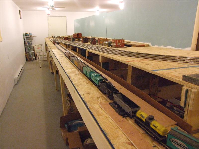

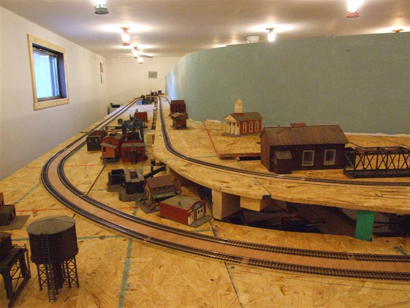

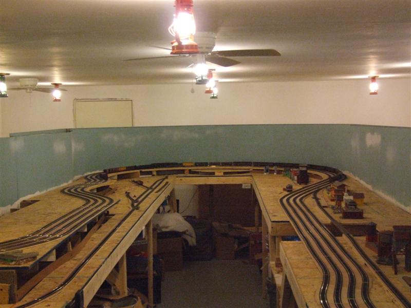

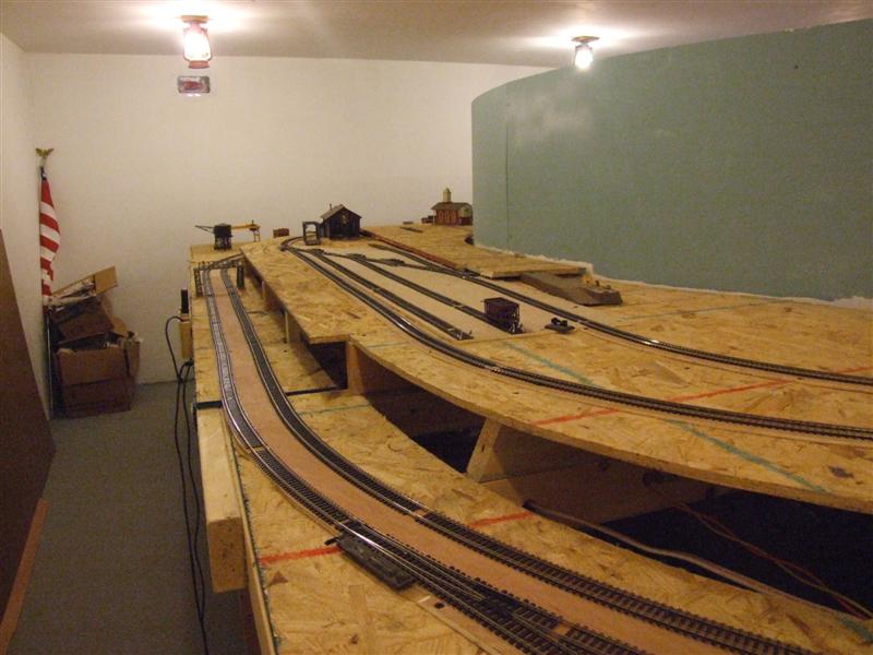

Hi Gang,

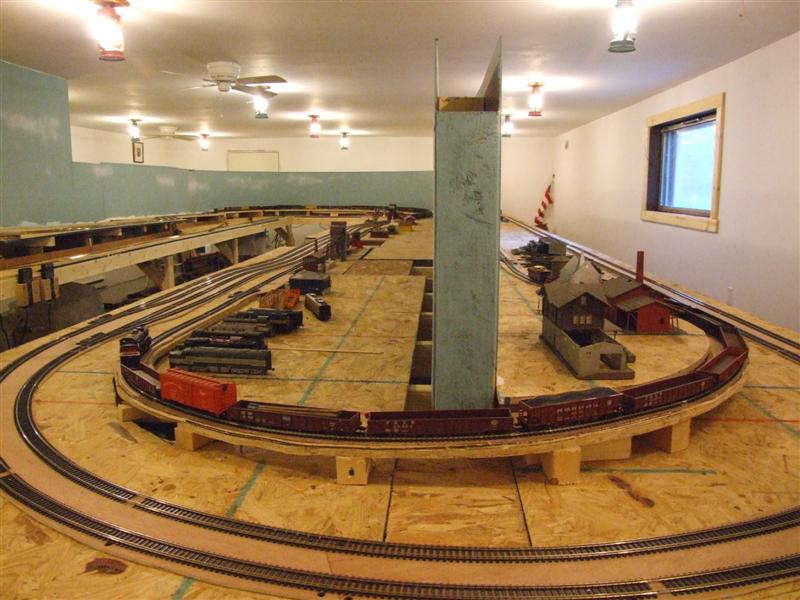

Time for some more pictures. I had a VIP coming so I had to do some cleaning and organizing. The layout is coming around now.
I needed a boost to get me moving
Charlie, no doubt that layout is going to be terrific for running trains, trains, and more trains! Great to see the progress photos.
It's even more impressive than the photos can show, too. Thumbsup Thumbsup
The trains were running pretty nicely when I was there, but I missed the arrival of any VIPs.

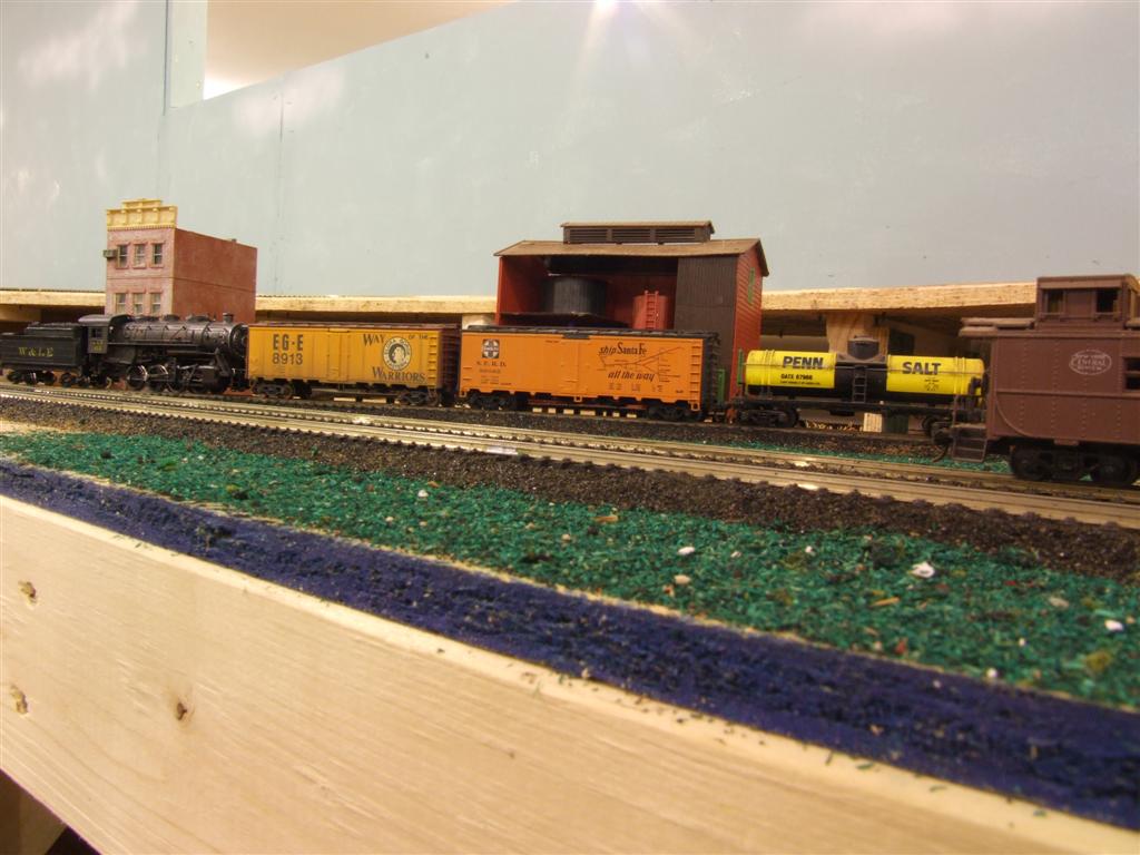

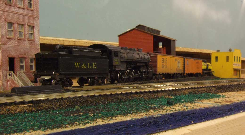

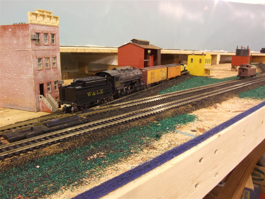

I actually did some ballasting today. I wanted to use cinder on the branch lines and while I was at tractor supply yesterday I saw a sandblasting abrasive that was finer than Black Beauty so for $7.95 I got a fifty pound bag. It is exactly the right size grit, and is black like cinder, but the advantage is it is washed so no dust. I ran a magnet in it just to be sure, and there were no iron particles. It looks pretty good. Pictures to follow. They have it is various grits too.

Here are a couple of pictures of a branch line train setting some cars into a pickle plant. The track is ballasted with the blasting abrasive from Tractor Supply. It comes in 50 pound bags and was $7.95. I used the 40/80grit which is the finest. It is a great representation of cinder ballast.
